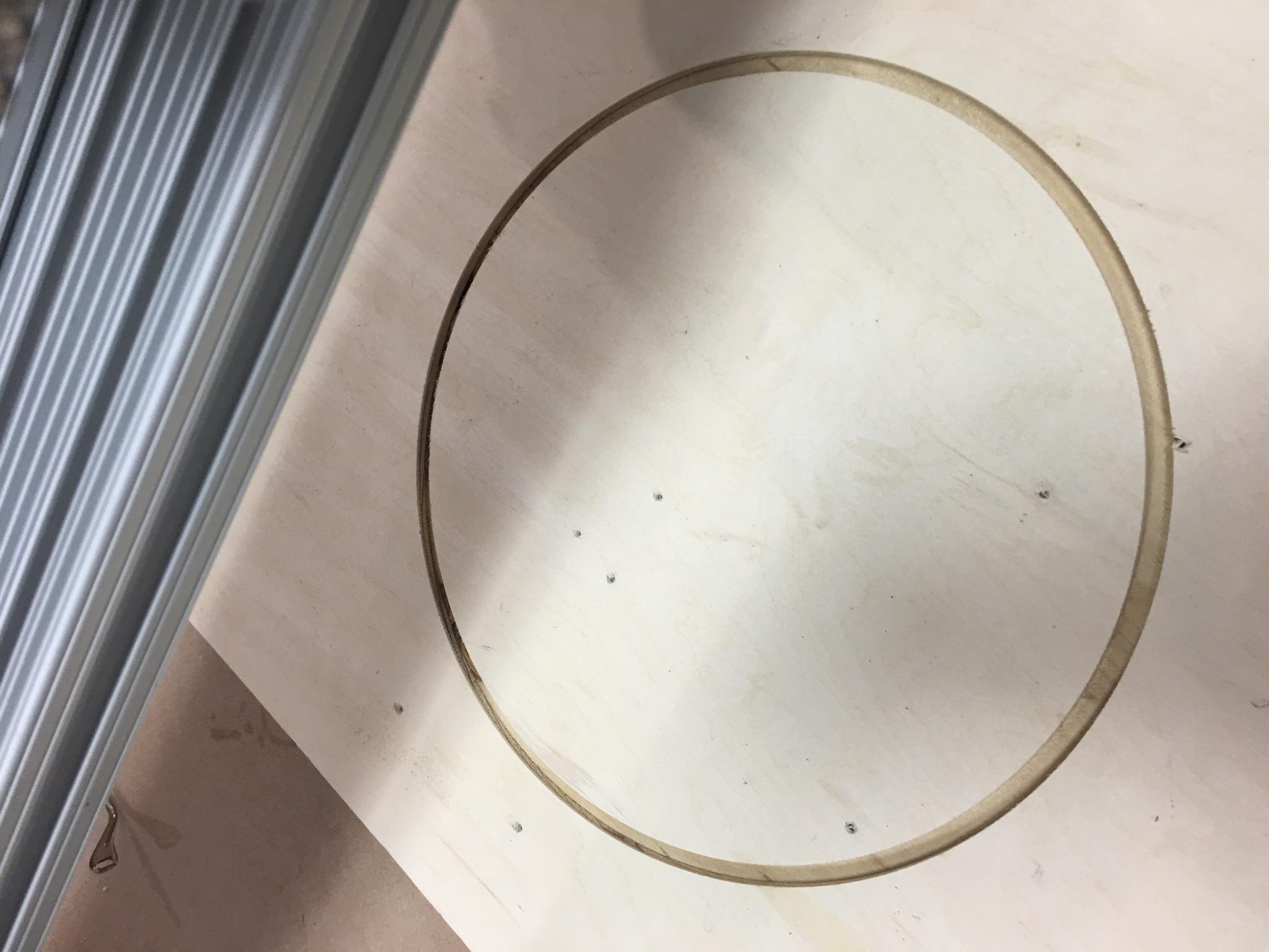

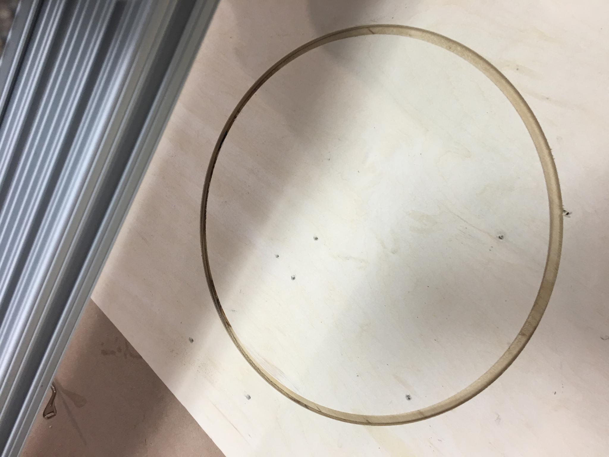

    First cut! The requisite circle :)
    Still so much to do, but that is definitely encouraging!

  5. #74
    Wally!
    Good work and well done :D
  6. #75
    More test cuts. Doing calibration.
    Thanks,
    Wallace

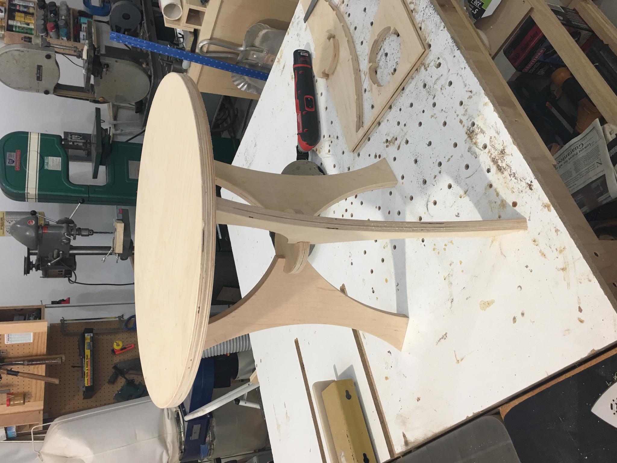

    Well, I'm at the point of cutting real stuff:
    And - of course - thinking about what I want to do to make this one better AND what I'll be doing for the next one! :)
    I am leaning towards a 4x8+ made out of extrusions. Wood-only, so I think extrusions will be fast and adequate. Want to be able to put a whole sheet of plywood on at once. But, just thinking/dreaming at this point.
    For this one, I am planning the following:
    - 1/2" steel table with a 3/8"-16 hole pattern for bolting down MDF wasteboard, Aluminum pieces, etc.
    - 3 or 4:1 belt drive on X- and Y-axis. The X and Z are direct connected. The Y is belt, but 1:1
    - More rigid gantry with 1/4" steel end plates and 2040 Rexroth crossbars. With a slanted design to allow more real estate to be accessible
    - Maybe filling some of the frame members with something - mortar maybe? Sand?
    Thanks to all for the advice gotten here,
    Wallace
