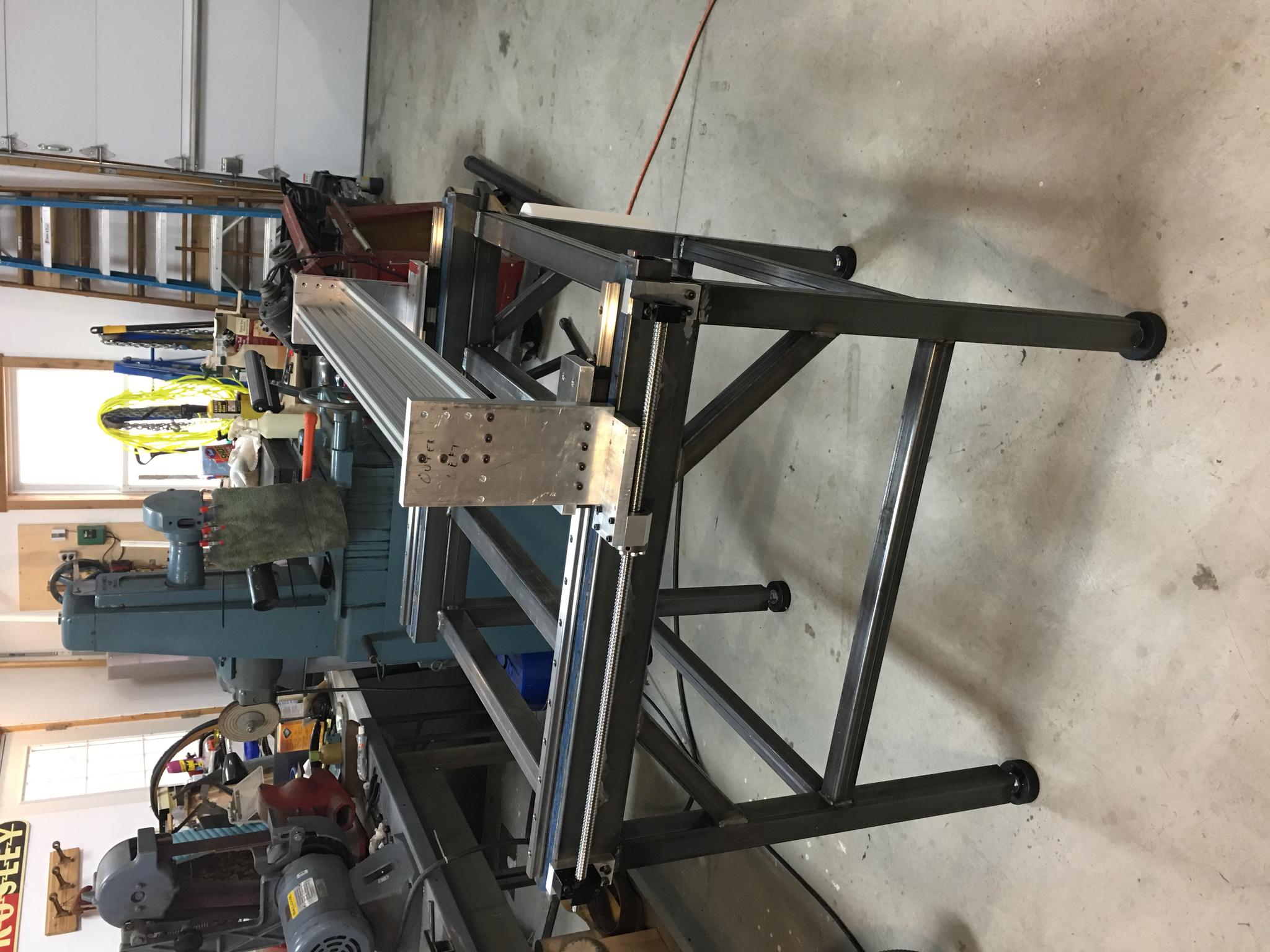

    Wow! I was thinking it had been over a year since I last posted - but then realized the dates are DD-MM-YYYY and not MM-DD-YYYY! Anyway, got sidetracked somewhat with a surface grinder I picked up at auction. That, along with a surface plate and measuring tools pulled me into the world of tenths. A scary, but fun place. I like This Old Tony's description of his surface plate: Where dreams go to die... Anyway, gotten back to the router recently:

    Now, I know it isn't pretty. Please keep in mind my goals for this are to learn and gain experience. I would like it to cut wood at a reasonable (woodworking) level of accuracy at some decent speed, but I'm mostly having fun and building skills and knowledge to make a better one after this - if I decide I want to.
    I just ordered rails and ballscrews that are 50mm longer than the ones in the pics. I intend to move the existing ones to the gantry and put the new ones in their place. This should give me bit more travel and get the ends out where I can get pulleys on them. I am thinking of driving the two Y-axis screws with a single NEMA 34 and timing belt arrangement. The X- and Z-axes will be NEMA 23.
    Can I get opinions on this kit: https://www.ebay.com/itm/FEEE-Ship-3....c100005.m1851
    I'm leaning towards a Centroid Acorn controller.
    So, given the above, I'd love some input, guidance, even criticism.
    Thanks,
    Wallace
