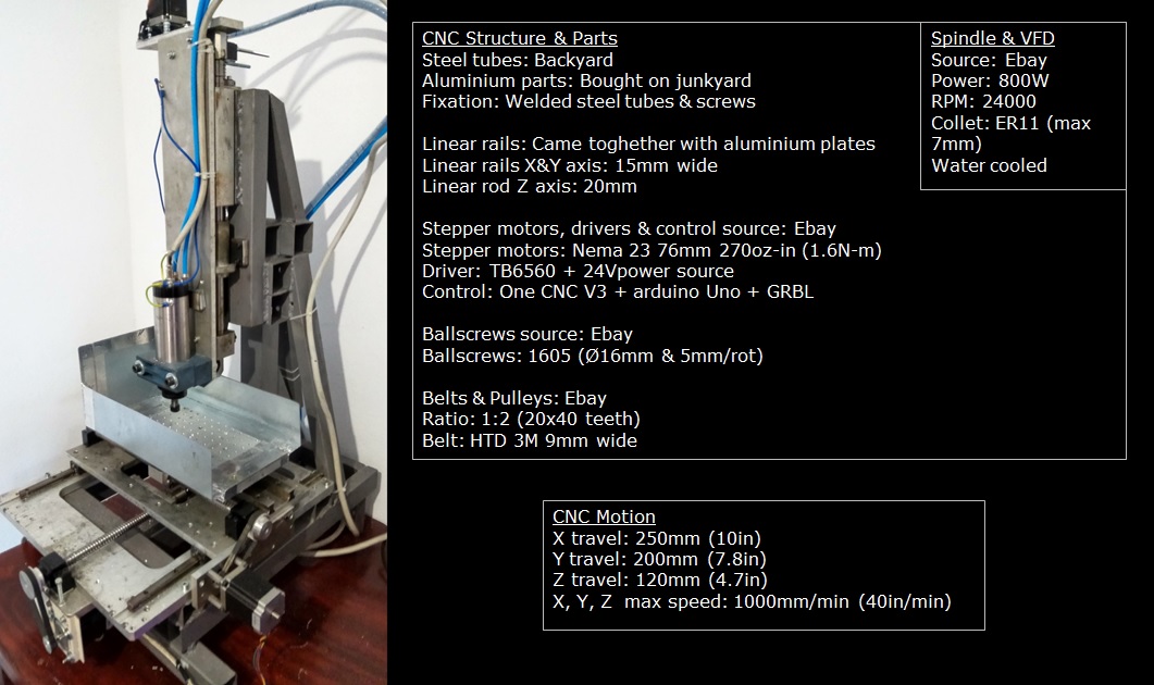

    I already had build a 3D printer in 2013, I started to get bored with it, so I start to see some CNC videos on internet about CNC routers and I thanked: I can do it!!!
    So I made a little research about homemade CNC's and I find out that I will need:
    -Control system
    -Stepper motors + drivers
    -Transmission (belt's + pulley's)
    -Ballscrews
    -Linear rail/rods
    -Metallic structure
    -Spend little money as possible
    So after that I went to my backyard and I found some 50*50mm steel tubes, perfect for the structure!
    I went to the scrapyard and I found some aluminium tables with 15mm linear rails that looked perfect for X&Y axis and a linear structure with 20mm rod's that was good enough for Z axis.
    I searched on ebay and found Nema 23 with 270oz-in with TB6560 driver + 24V power supply and mach 3 interface for a reasonable price.
    The belt's and pulley's were ordered from www.bepltd.com, very nice guys, aluminium pulleys with 20&40 teeth for 1:2 ratio and HTD 3M belts, perfect for very small or no backlash.
    After some time I found out my computer was not able to connect to Mach 3 interface via LPT1... So was time to search for USB solutions, and i found GRBL.
    After that I ordered a One CNC V3 and an Arduino Uno from Ebay, perfect for the job.
    After lots of welding, drilling, tappering, ect the cnc was running perfectly, almost squared!!!
    At that time I explored the limits of the machine, and i find out that I abused with microsteps. The machine was too precise, too slow and with almost no torque.
    Time to do some research:
    -Calculation torque Vs microsteps & step/mm to achive resolution Excel link:
    https://www.dropbox.com/s/lhz4ht3kh0...ixos.xlsx?dl=0
    With this excel I understand why we should not abuse of microstepping, and why is important to choose a pretended resolution to you CNC machine.
    An important factor is also driver voltage, TB6560 only are able to have a input voltage of 30V, this is a limitation to achieve max torque at higher stepper motor speed.
    Spindle was a a very difficult choose since I don't really know what the machine can handle, so i went for 0.8kW+VFD chinese spindle water cooled from ebay, now I'm a bit regretted due collect 11 isto small(max 7mm mills).
    Material:
    CNC Structure & Parts
    Steel tubes: Backyard
    Aluminium parts: Bought on junkyard
    Fixation: Welded steel tubes & screws
    Linear rails: Came toghether with aluminium plates
    Linear rails X&Y axis: 15mm wide
    Linear rod Z axis: 20mm
    Stepper motors: Nema 23 76mm 270oz-in (1.6N-m)
    Driver: TB6560 + 24Vpower source
    Control: One CNC V3 + arduino Uno + GRBL
    Ballscrews: 1605 (Ø16mm & 5mm/rot)
    Belts & Pulleys:
    Ratio: 1:2 (20x40 teeth)
    Belt: HTD 3M 9mm wide
    Spindle & VFD
    Power: 800W
    RPM: 24000
    Collet: ER11 (max 7mm)
    Water cooled

    So enough of talk and lets see the machine working!!
    Next steps:
    -Add endstops X,Y & Z
    -Mill Aluminium Spindle brackets
    -Protect rails and ballscrews from chips.
    -Make a box for CNC (maybe soundproof)
    I know this is not a perfect CNC, but for the first one I'm proud of it!
    If you have any idea or improvement please share, Thanks.

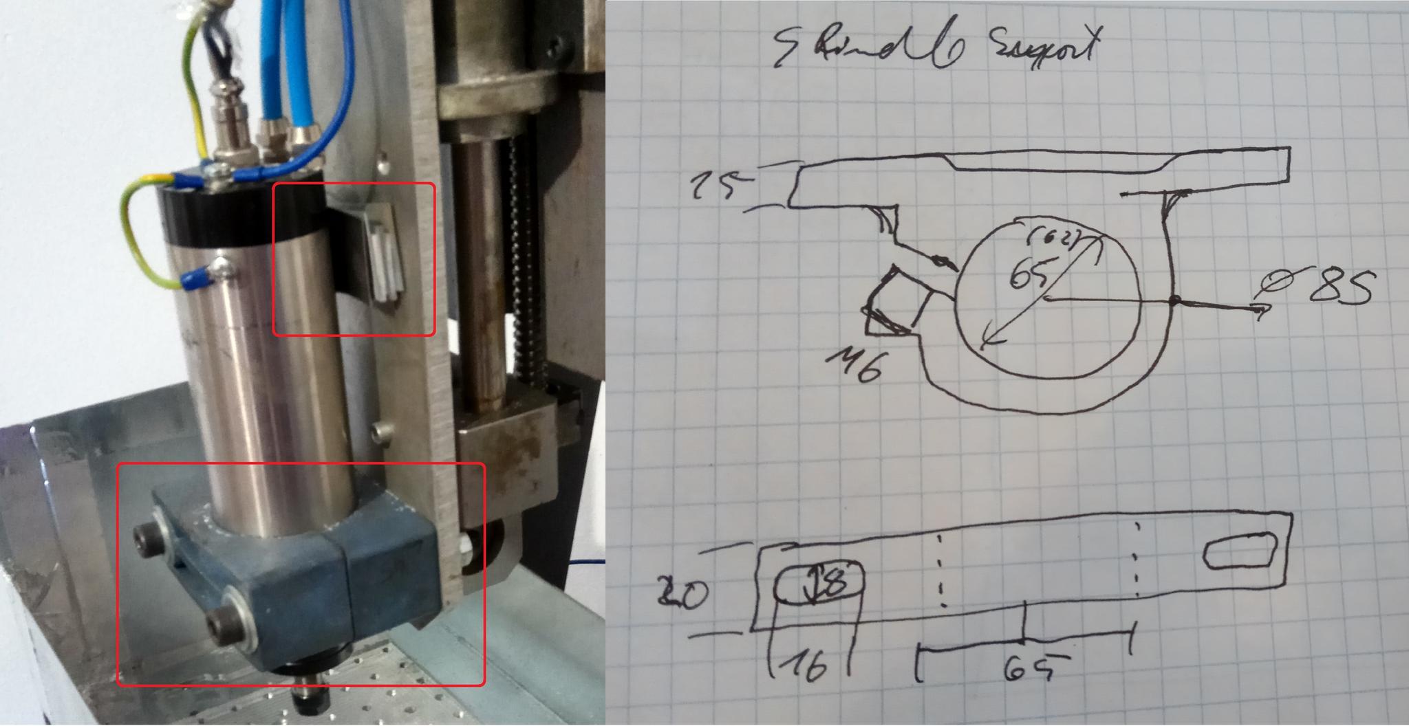

    So I'm doing 2 Aluminium brackets for my 0.8kw spindle.
Name:	motor bracket.jpg

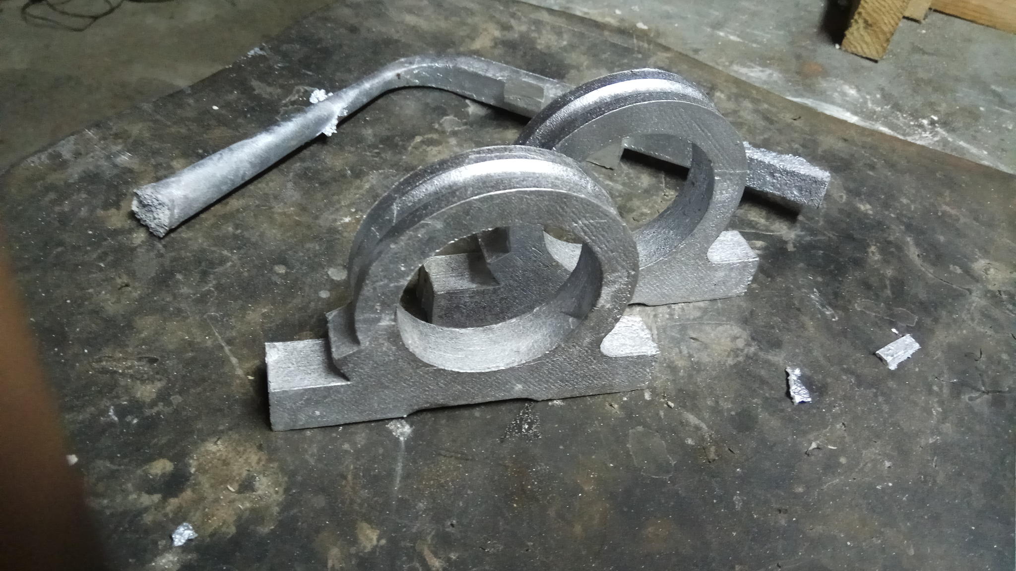

    I could do it by milling an aluminum plate, but long time ago I want to make a full video of lost PLA on plaster mold for aluminium casting.
    So how I will document this:
    Part 1:
    -Fusion 360 modeling
    -Slic3r Gcode generating
    -3D printing
    -PLA welding with soldering iron
    Part 2:
    -Make of plaster mold
    -Dry of the mold & melt of PLA
    -Aluminium casting
    Part 3:
    -Fusion 360 CAM
    -Mill the aluminium bracket to the spec
    Here you have the first video (Part 1/3):
    Any idea os suggestion?
    Thank you

    Hello guys,
    Today I completed the part 2 of the video, the plaster mold preparation and aluminium casting.
    I hope you enjoy.
    Thank you

    Thanks for the comment!
    I tried to mill the parts yesterday with some drawbacks:
    -Too much RPM & worn out tool
    -New tool with 12k rpm milled the aluminium with goos quality
    -M30 at the end of Gcode that broke my carbide tool -_-
    The CNC broke the mill with lots of class!
    Check the video:
    Thank you guys.
