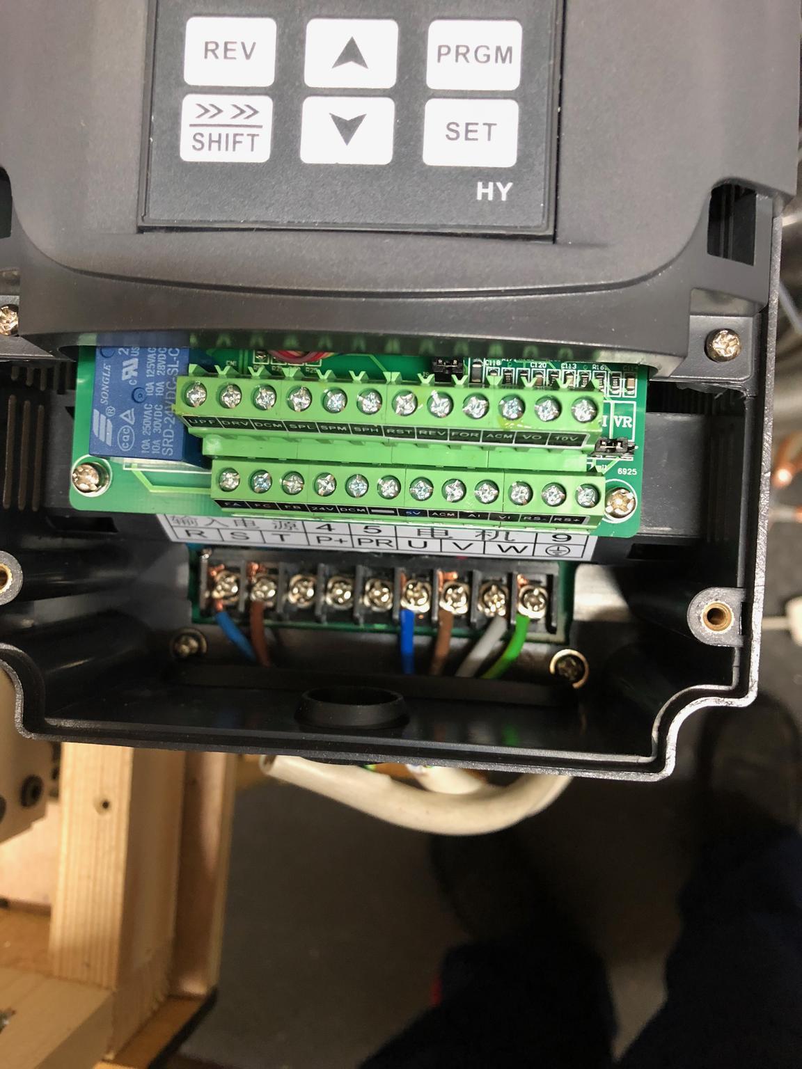

    After trawling through countless online videos and documents to wire up the Huanyang 2.2kw VFD I was finally confident enough to get the wiring correct. Taking the plunge I got all the wires in the order depicted in the many documents.
    Plugged in and switched on. After what appeared to be a lifetime waiting the inverter kicked into life.
    My next step was to get the programming out of the way, this also was successful. Pressed run and the spindle started turning.
    Now this is where it all went wrong. I wanted to see how fast the spindle was turning and pressed >> button a few times might and various modes were selected. I considered that I had changed the programming somehow since i had, had it running.
    My only course of action was to start again. When I had completed the program inputs. I switched the unit back on and "Bang" all the power went off in my workshop and smoke pored from the unit.
    Now prior to the spindle working okay and me attempting to fix things via programming I was pressing the Run btn, the spindle behaved strangely to this in that it would sort of chug round a couple of times the unit went into error.
    Could the spindle have been at fault, if so how could i test it without an inverter? Is it possible to sick a 13amp plug on it and connect it to an outlet?
    Don't want to get another inverter and blow that up due to a faulty spindle.
    And all I wanted to do was to see the RPM and my next step would have been how to adjust the speed.

    I may be wrong - but - I do not see how it is possible to blow up an inverter by parameter setting. (This is an invite to members to point out otherwise)
    The first test of your spindle should be with a multimeter before connecting to the VFD. If there are four wires one should (but not necessarily) give earth continuity to the case of the spindle. the other three should give approx the same resistance reading between any two pairs*. These tests are done at the VFD end before connecting the wires.
    Shorted wires will cause currents large enough to blow the output gate transistors and give the grand illusion of failure with a large amount of magic smoke.
    Open circuits can give voltages in the output stages of the inverter enough to do the same.
    Your inverter may be repairable, but repair costs will be as near to replacement cost as to make it not worthwhile.
    DON'T take your inverter to pieces - you will lose any chance of a warranty claim.
    *without getting my spindle out of the box - I can't tell you the values

    Can you post a drawing showing how you connected everything ?
    Also which parameters did you change and what value did you use ?

    wiring diagram ? or did you just connect the power in and motor without adding any control wiring ?
  9. #8
    240v Inverter
    Blue to R
    Brown to S
    Earth to Earth
    spindle
    Using normal 13amp extension cable
    Blue to U
    Brown to V
    Yel/grn to W
  10. #9
    A proper diagram is essential, for your own sake too, but it seems you don't have one.
    So just to be clear, you connected the spindle cable cores to UVW at the inverter, and where did you connect the other ends at the spindle itself ?. (I don't have one of these spindles so I'm not sure what terminals are provided) Did you use any of the cores as an earth wire ?
  11. #10
    No I never used an earth, the plug has 4 connectors and one of them is left empty (No 4)
    My soldering is NOT the best in the world and I'm wondering if there was a short in the plug on the spindle. I didn't see anything when I took it apart could that have caused the damage if it had shorted?
