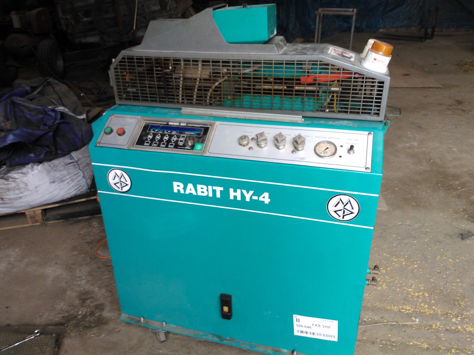

    This Machine arrived yesterday and now the challenge of constructing a mold can begin. I think something simple will do for starters but I would like to maybe add an injection system to make the mold cycle automatically.

    was it on ebay a week or two back,i was gonna bid myself.i got scared by the lack of info on it.
    hope it does the job,show us it in action when your going.

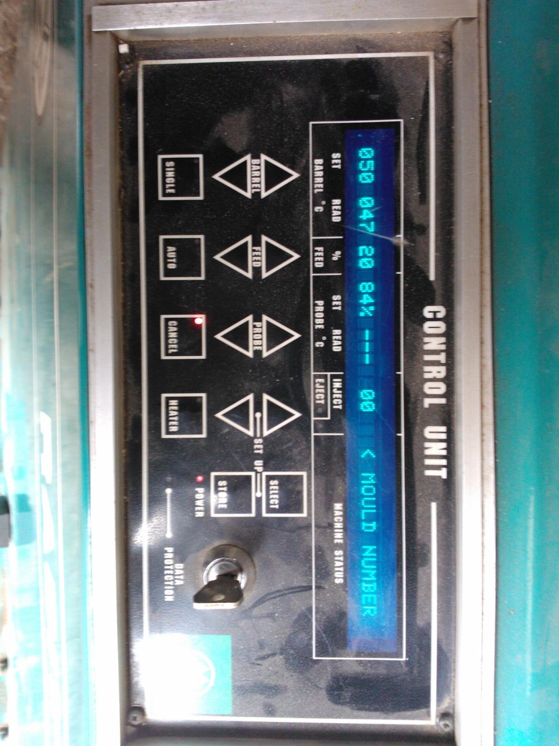

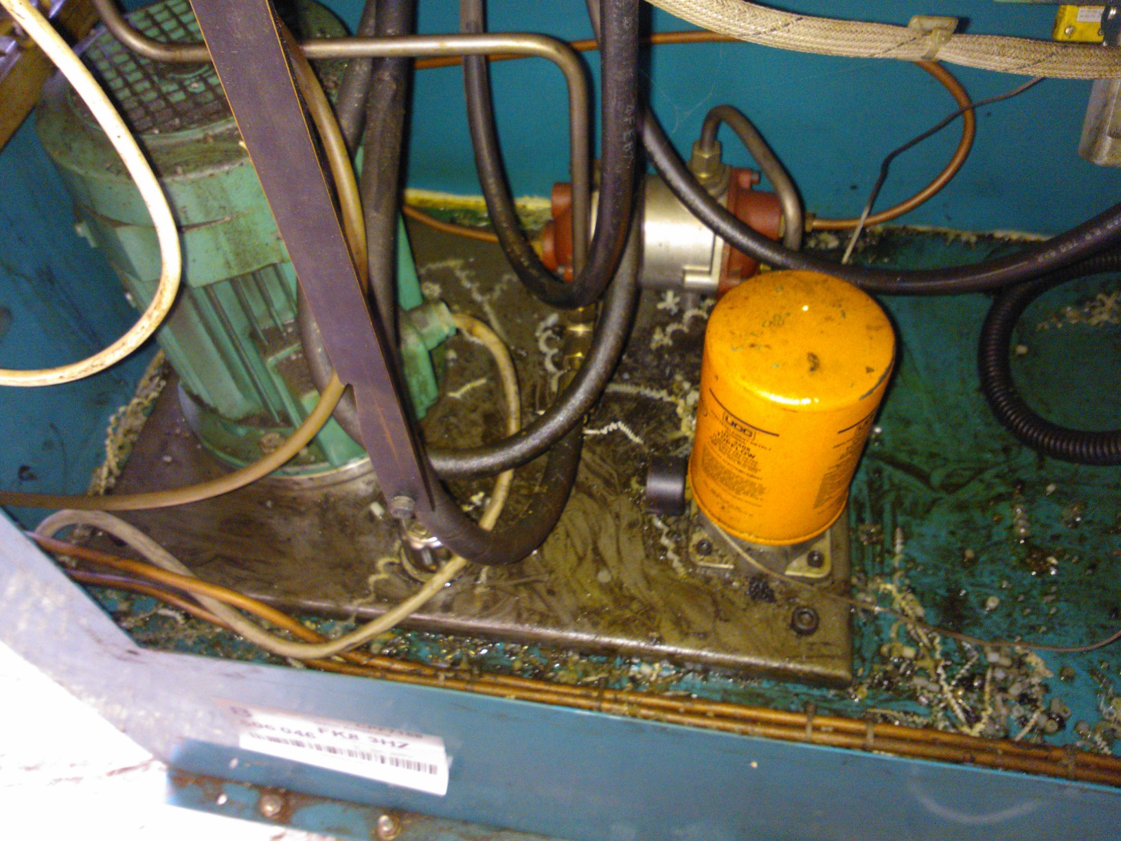

    Good spot deisel most probably is the same machine, I didn't actually win the auction but the winner went awol and I was the secound highest bidder so I thought I would take a punt and accepted the secound chance offer. Its 240v for the heater and logic controller and 3 phase for the hydraulics. Took me a while to figure out how to wire it all up as the 240v supply was cut off inside the controller and I had the hydraulic pump motor spinning the wrong way. Seems to cycle ok now, there is even a small air cyclinder that activates the ejector pins and a light gate to sense wether parts have stopped exiting the machine. All in all pretty pleased but if I find Im not up to making a mold or have no need for the machine Ill let you know and maybe I can pass it on to you.
    What is the easist material/plasic to use in an molder like this. I would like to get some granulated plastic purged through the nossel, before I commit to making a mold.

    hdpe seems to be favourite as a purge material for the more common plastics used
    click on this link below, theres method to purging so depending on what plastics stuck in there?best to be safe ;)
    http://hannaprimeinc.com/purge.php
