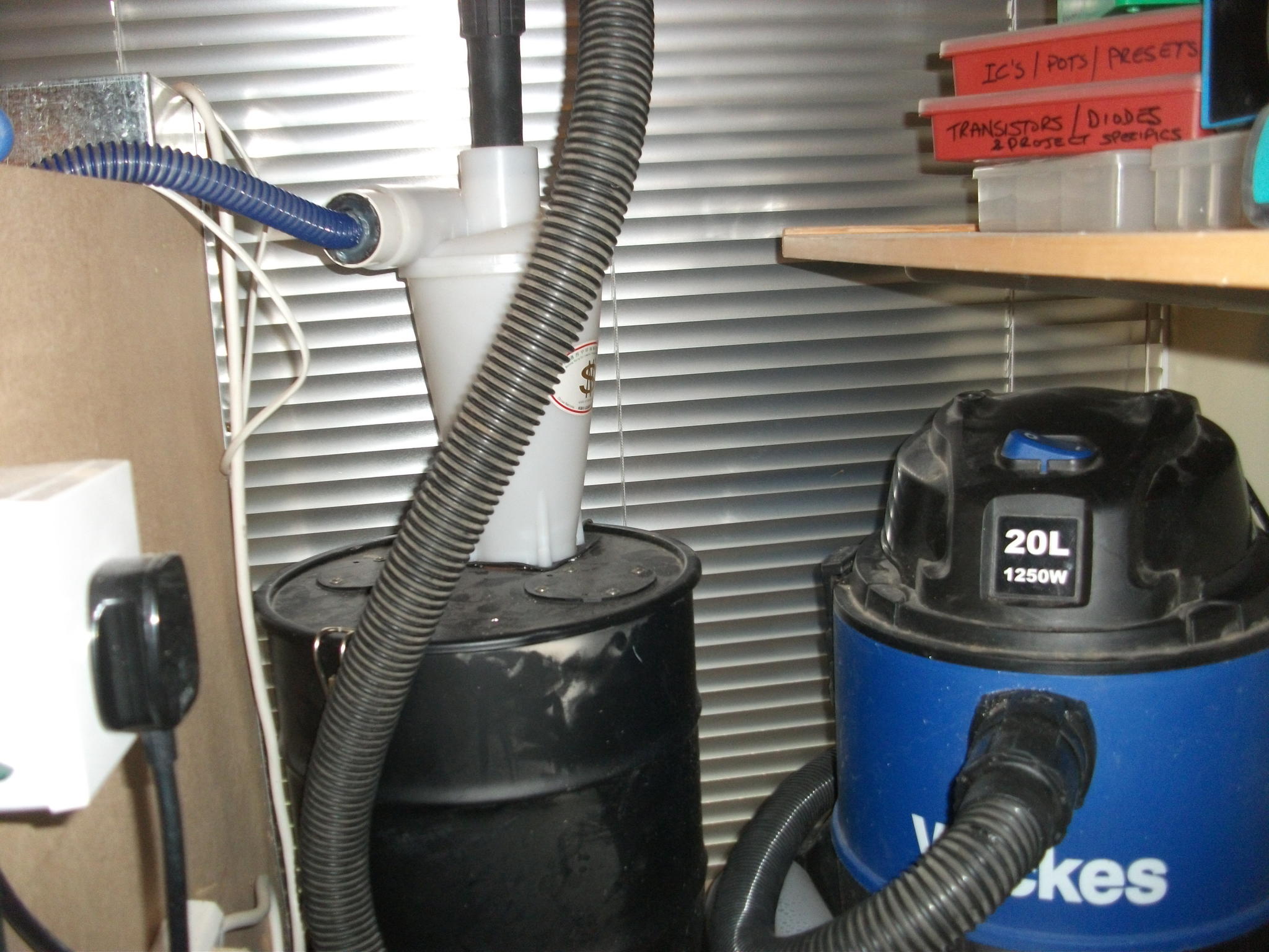

    Brushed motor vacs are not really intended for long switch-on periods and the brushless motor ones are much quieter and designed to run continuously. I have thought about buying something like this http://www.power-motor.com/Products/...uumCleane.html and building my own canister using the remains of my old vac when it burns out (hopefully not literally!).
    My current setup is this Click image for larger version.

    What's the cyclone setup you are using, and how well does it work? I keep thinking of having a go at knocking up something but can't quite get it to the top of the to-do list.
