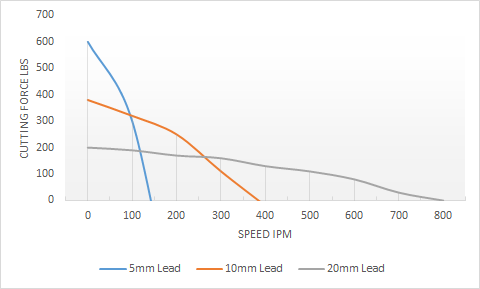

For ballscrews my machine is 5mm pitch all round but if I was starting again then 5mm Z and 10 mm for X and Y. This gives better rapids in wood and should be Ok for aluminium but if you drive the X and Y via belt and pulley you can swap out the ratio on X and Y to give 2:1 to give more torque (and less speed) if needed on the aluminium
Not sure about 20 mm pitch - will give very high rapids but you loose some torque and could stall the steppers? Anyone tried this much pitch? May be ok with enough voltage on the steppers . . .

Someone made a graph for me for the same motor with different pitch considering the weight of the gantry, ballscrew type, motors specs,... :
10mm seems to be a good compromise. What do you think about that?
31-10-2017 #13
I think 10mm pitch will be plenty good :)
Atleast I hope so as I have it on my machine that I'm building!
Seems like you chose good motors but if speed is important to you they will perform much better with higher voltage psu and drivers. The G540 is a bit outdated I think :)
