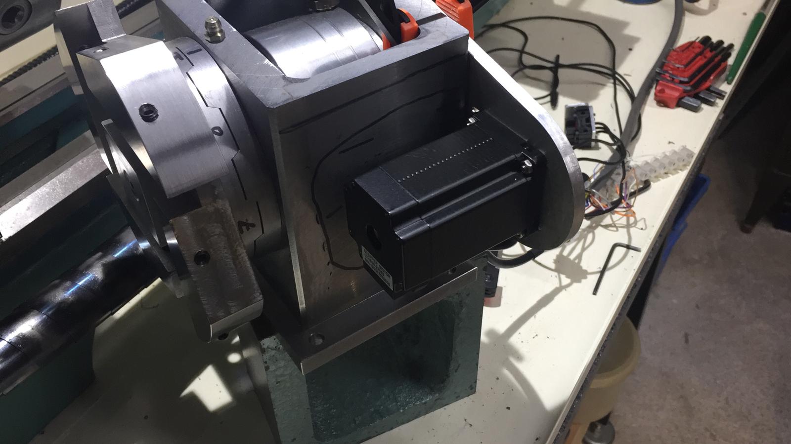

    Cheers, that looks really nice but I only have 50mm table to CL so that wouldn't fit.
    We are also 90% finished on the one we are building. All steel and only needs a nema 17 stepper to turn it.

  6. #26
    https://photos.app.goo.gl/Yo6VCW2a8KGGR9Tm7
    This is the first test of the ATC to check movement and speed. Index's perfectly and can move in both directions to find the closest tool

    Hi Ross, your toolchanger looks really sturdy. Did you make this to an existing design or is it all new? I would love to make one for my Denford Easiturn as I'm getting fed up changing tools every few minutes!
    Best Regards
    David
  10. #29
    Hi David, Thanks, it is rock solid and really happy with it.
    Yes it was all designed and built from scratch. It was joint project between me and friend and was a lot of work to get it finished. he had the denford one with the ratchet and pawl design but it wasn't ridged enough so we set about a more industrial option using the Hurth coupling. Most of the DIY ones we looked at had the problem of making the shaft really tight when the Bellville's were compressed to open it and needed a massive stepper to then rotate the tool plate.
    Ours works differently and when the Bellville's are compressed the shaft is free to turn by hand and allowed a small nema 17 stepper to spin the plate.
    There was talk of doing a small production run of them so I'm not sure if I could post up the plans yet.

    No worries - I've actually been looking at the same idea for some time but shelved the idea as I couldn't be bothered making the hirth couplings as they can be an arse ache.
    My intention was to just use a pneumatic clamp cylinder with a single belleville to aid in the release. Not overly complicated really.
