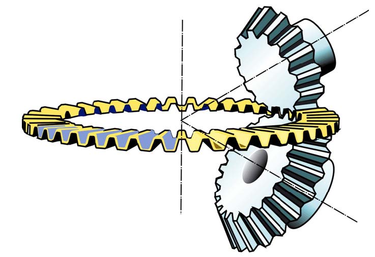

    Another way is
    Mount the gear as above but via a 4th axis on an inclined plane. Then the tooth can be generated with a straight sided cutter in successive passes whilst rotating the gear. The yellow in the pic is a rack relative to the two rotating gears. Therefore each tooth flank is conjugate to a straight sided cutter (e.g. 20 deg included angle end mill). Therefore this principal can be used to cut the tooth surface!
    Hope this helps
