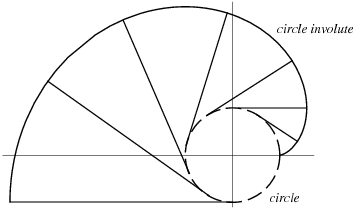

    I also have often looked at the "pretty pictures" that these cad systems have produced and wondered just what the shape of the tooth is based on. Is it a true involute created from first principles, or is it part of an arc of a circle which just "looks right".

    A previous post mentioned taking the cross section of a tooth and extending it forwards and back. Beware of this approach as the tooth surface shape changes along it's length.
    At the small end of the gear the involute tooth surface is generated from a small base circle diameter, whilst at the large end a larger BCD is used. You can see from the pic above that from the root outwards, the radius of curvature of the tooth surface is constantly changing up to the tooth tip. But this point radius of curvature changes from small end to large end also.
    With a spur gear the involute shape can be machined onto a cutter (e.g. disk milling cutter to end mill) and the gear form cut with indexing from tooth to tooth. This approach won't work with a bevel.
