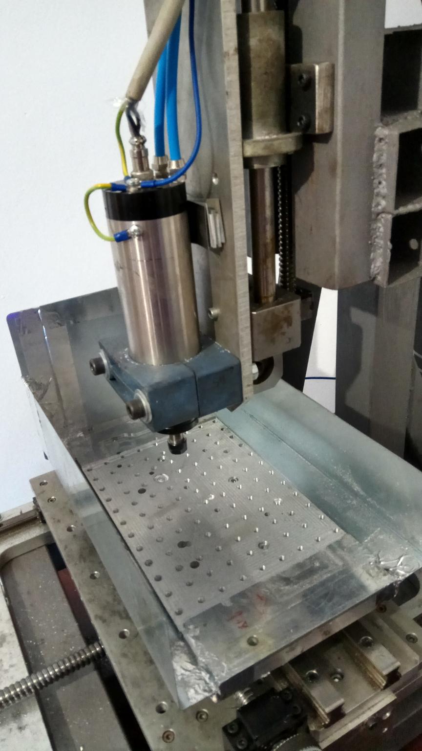

    Hello guys,
    I already had build a 3D printer in 2013, I started to get bored with it, so I start to see some CNC videos on internet about CNC routers and I thanked: I can do it!!!
    So I made a little research about homemade CNC's and I find out that I will need:
    -Control system
    -Stepper motors + drivers
    -Transmission (belt's + pulley's)
    -Ballscrews
    -Linear rail/rods
    -Metallic structure
    -Spend little money as possible
    So after that I went to my backyard and I found some 50*50mm steel tubes, perfect for the structure!
    I went to the scrapyard and I found some aluminium tables with 15mm linear rails that looked perfect for X&Y axis and a linear structure with 20mm rod's that was good enough for Z axis.
    I searched on ebay and found Nema 23 with 270oz-in with TB6560 driver + 24V power supply and mach 3 interface for a reasonable price.
    The belt's and pulley's were ordered from www.bepltd.com, very nice guys, aluminium pulleys with 20&40 teeth for 1:2 ratio and HTD 3M belts, perfect for very small or no backlash.
    After some time I found out my computer was not able to connect to Mach 3 interface via LPT1... So was time to search for USB solutions, and i found GRBL.
    After that I ordered a One CNC V3 and an Arduino Uno from Ebay, perfect for the job.
    After lots of welding, drilling, tappering, ect the cnc was running perfectly, almost squared!!!
    At that time I explored the limits of the machine, and i find out that I abused with microsteps. The machine was too precise, too slow and with almost no torque.
    Time to do some research:
    -Calculation torque Vs microsteps & step/mm to achive resolution Excel link:
    https://www.dropbox.com/s/lhz4ht3kh0...ixos.xlsx?dl=0
    With this excel I understand why we should not abuse of microstepping, and why is important to choose a pretended resolution to you CNC machine.
    An important factor is also driver voltage, TB6560 only are able to have a input voltage of 30V, this is a limitation to achieve max torque at higher stepper motor speed.
    Spindle was a a very difficult choose since I don't really know what the machine can handle, so i went for 0.8kW+VFD chinese spindle water cooled from ebay, now I'm a bit regretted due collect 11 isto small(max 7mm mills).
    Material:
    CNC Structure & Parts
    Steel tubes: Backyard
    Aluminium parts: Bought on junkyard
    Fixation: Welded steel tubes & screws
    Linear rails: Came toghether with aluminium plates
    Linear rails X&Y axis: 15mm wide
    Linear rod Z axis: 20mm
    Stepper motors: Nema 23 76mm 270oz-in (1.6N-m)
    Driver: TB6560 + 24Vpower source
    Control: One CNC V3 + arduino Uno + GRBL
    Ballscrews: 1605 (Ø16mm & 5mm/rot)
    Belts & Pulleys:
    Ratio: 1:2 (20x40 teeth)
    Belt: HTD 3M 9mm wide
    Spindle & VFD
    Power: 800W
    RPM: 24000
    Collet: ER11 (max 7mm)
    Water cooled
    So enough of talk and lets see the machine working!!
    Next steps:
    -Add endstops X,Y & Z
    -Mill Aluminium Spindle brackets
    -Protect rails and ballscrews from chips.
    -Make a box for CNC (maybe soundproof)
    I know this is not a perfect CNC, but for the first one I'm proud of it!
    If you have any idea or improvement please share, Thanks.

    Welcome to the form.
    Change your drives to AM882's and up the PS to 68V
  3. The Following User Says Thank You to Clive S For This Useful Post:
    What kind of improvement this will bring? More speed & torque?
    Thank you
    Enviado de meu Redmi Note 4 usando Tapatalk

    Quote Originally Posted by laranjas3 View Post
    Thank you
    Yes, and they will be good for your next build
