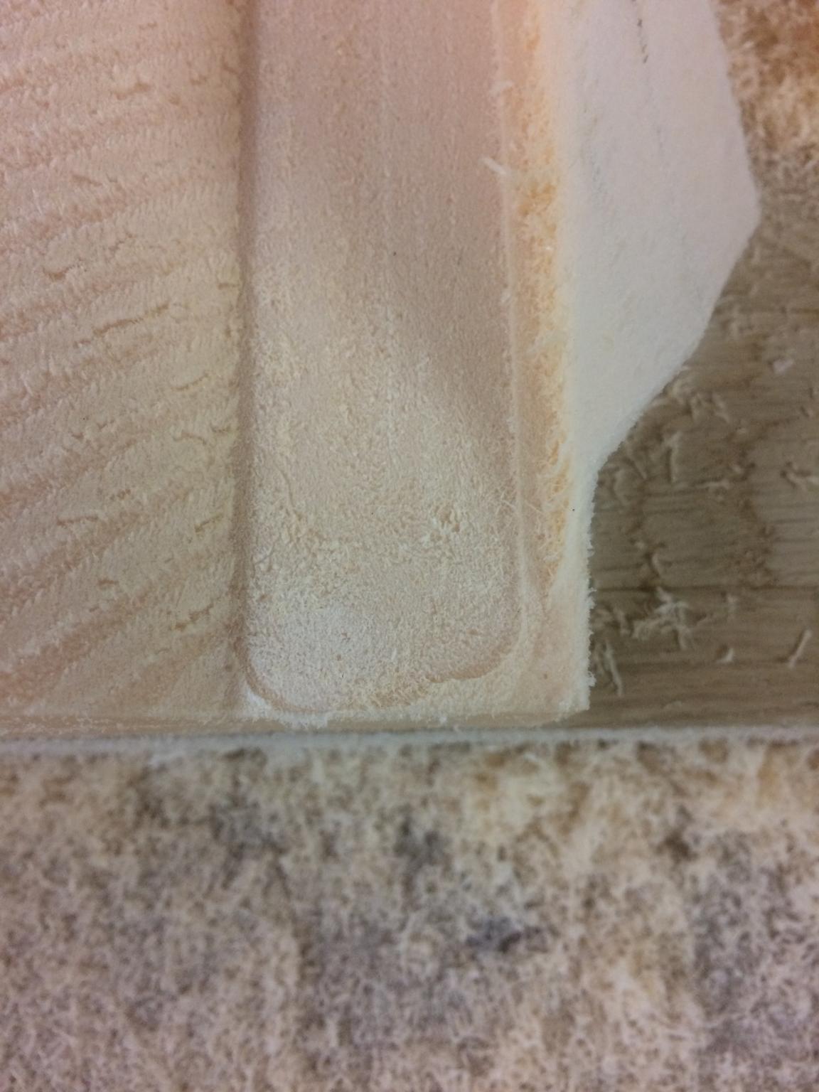

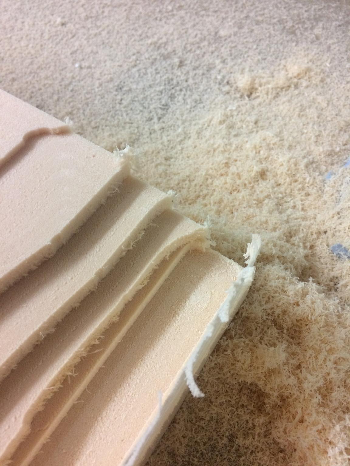

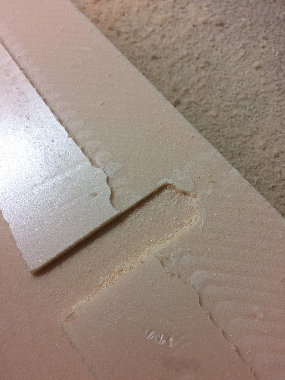

    This is two different files and the lines of g code it is stoping at doing air cuts just at a random location on the machine, the third picture is the cut I was doing yesterday when the problem first arose again

    After that I went back to playing with the motor tuning speeds and have reduced both y and z and it has now been running for a hour or so however it does not seam quite right as it looks like it has cut some corners or not done the tool path correctly.
    How do you know how to set the speeds of each motor to get the most with out problems?
