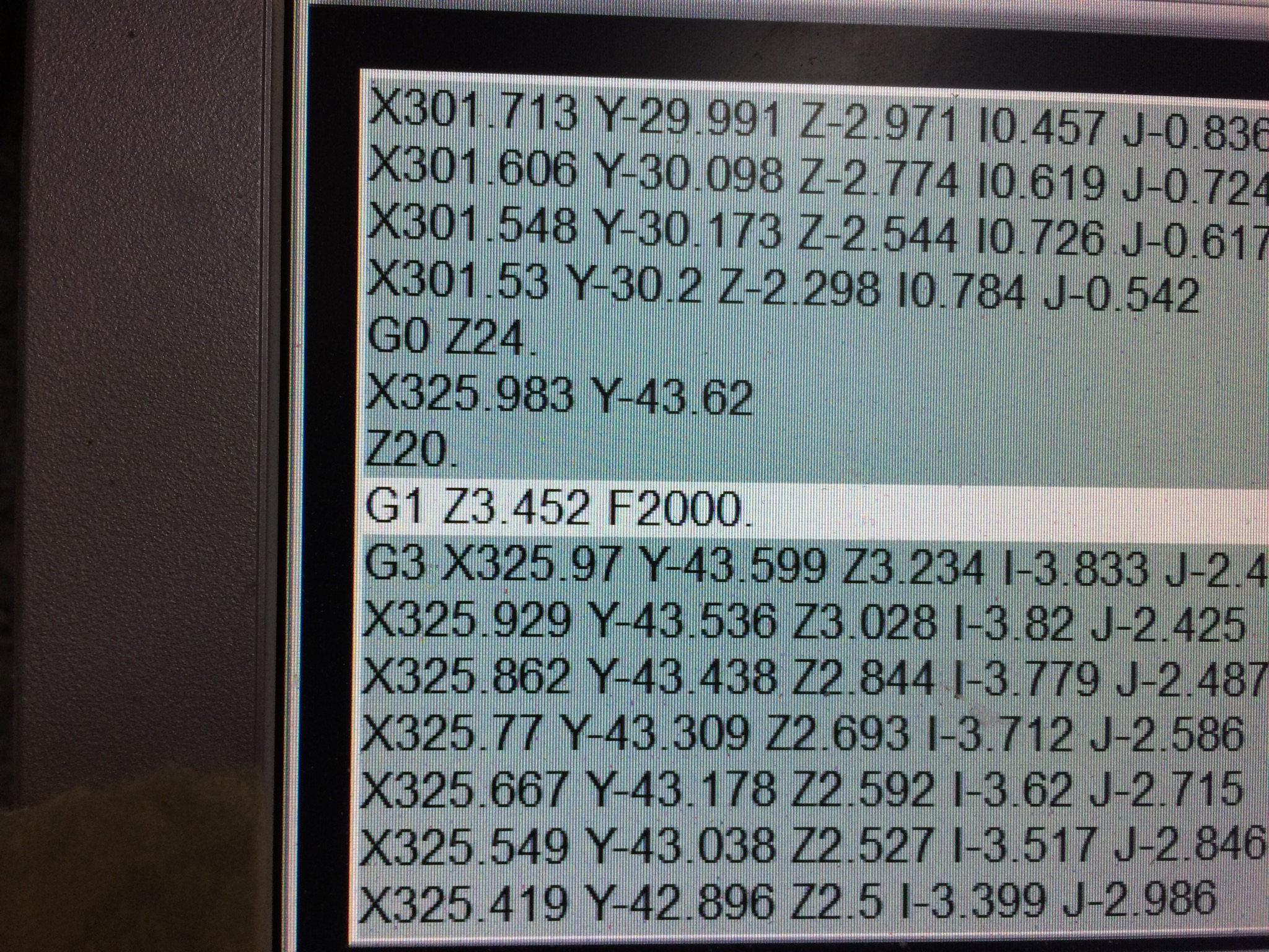

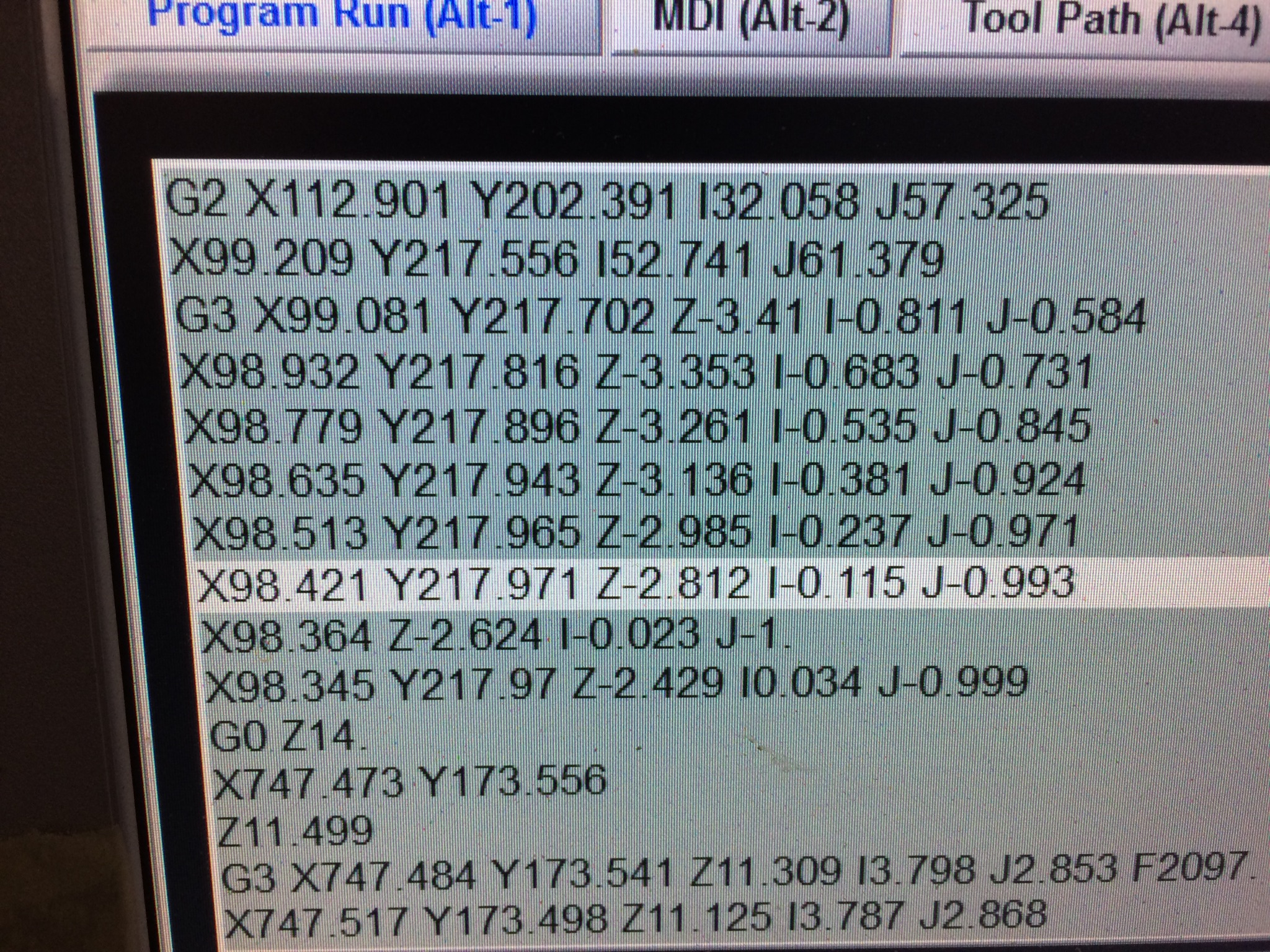

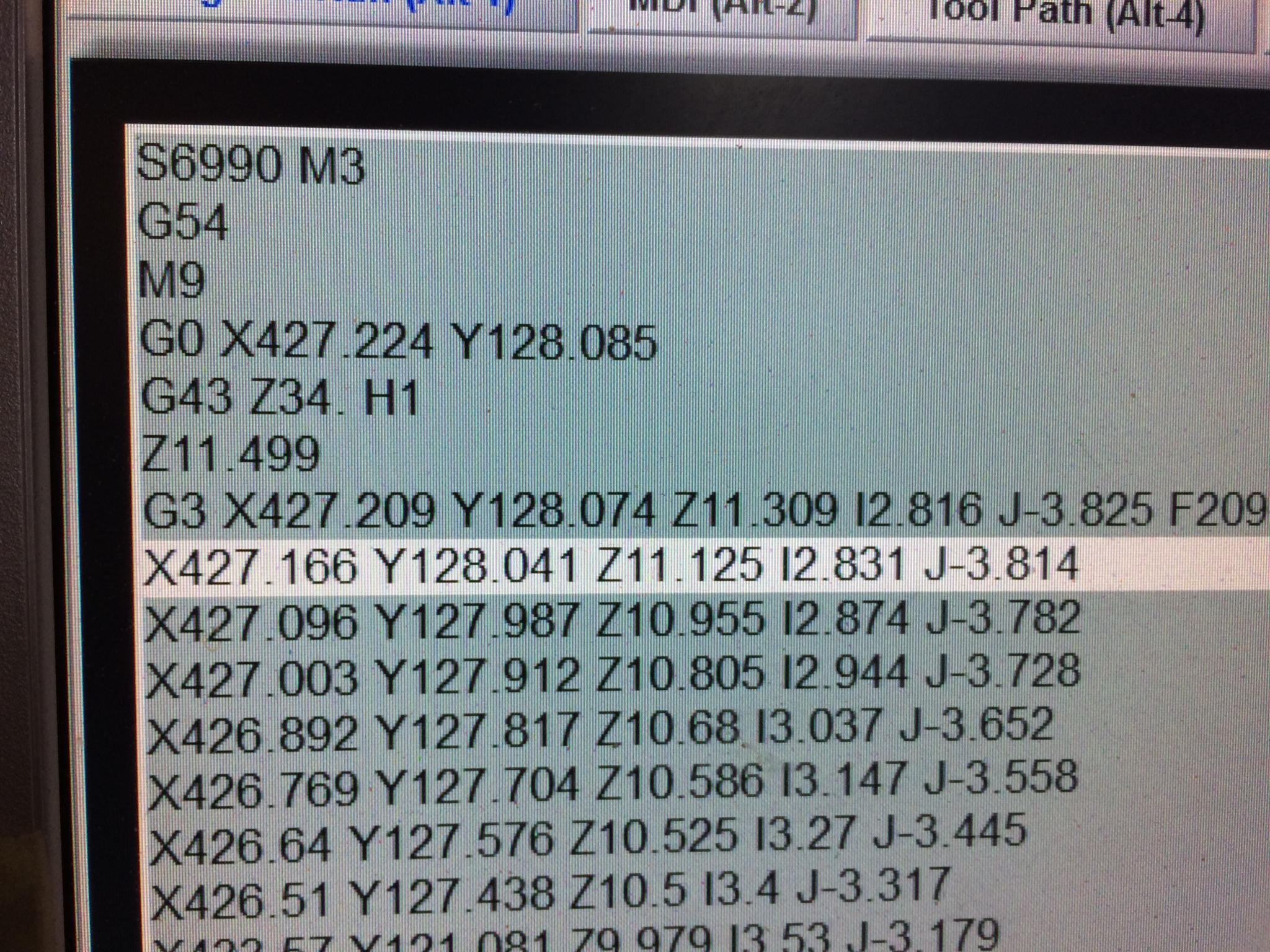

    Ok so this morning I tried the same file as yesterday which I normal run at 150% and it still faults however run at only 100% it is ok. I have a friend here who knows a little more so we have swapped the two drives over to see if the problem changed drives however now doong a rapid move on the y axis just using the keyboard trips the same driver as before which is now on the z axis.

    The drive is giving the same sensorless stall protection fault on the same file each time if I change the file it faults again but at a different point in the file but is repeatable if you re start the file. The fault causes a external e stop on Mach 3.
    Yes the driver trips doing air cuts
