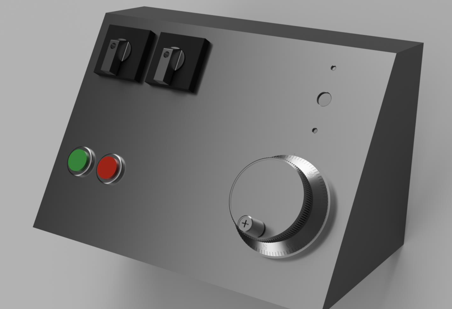

    I tend to do mine in CAD to get a feel however this works well. I'm right handed, so Id place the MPG on the right. Here is a mockup of Thor's panel. Ive since bought a Shuttle Contour controller which works well as my MPG seems not to want to work on 5V, so kinda abandoning this for now.

    I didn't see if the box was fixed somewhere or if it was portable. The reason I mention that is because any time I use the MPG wheel, it means getting my eye right up to the spindle to see what's going on, so being portable is a must for me.
    True. In my case Id probably put it on a swivel arm that can be moved somewhat but its not infinitely portable or wireless.
