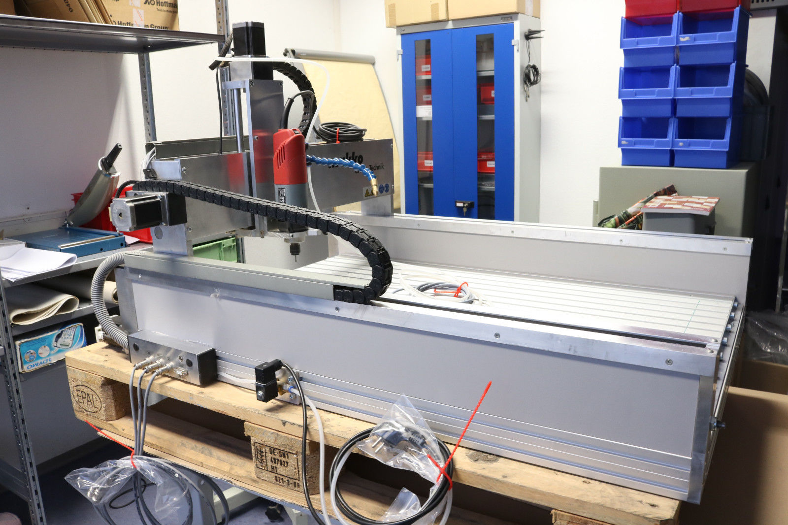

    Hello All
    I've got a makko 850 cnc machine with acme thread screws and was wondering if upgrading/changing to ball screws would make a worthwhile improvement. The machine has currently 16x4mm acme screws. the x travel is 800 mm Y travel 540 mm Z travel 125 mm. The power supply will supply 4 amps per stepper phase on x and y and 2 amps per phase on the z axis. I`ve bought two Leadshine em705 drivers for the x and y motors not yet fitted (the ones supplied with the machine were leadshine m542 (7+ years old) the power supply is 40 volts (300va) I'm doing woodworking (guitar making ) with the machine, learning by doing!! Any tips on improving the machine would be eagerly accepted. I'm using uccnc uc100 which was a great investment as the machine was virtually unusable with the original software supplied French partially translated into other languages (if you get my drift) I think Alan Turing would have had trouble figuring out the software as it was. Looking forward to any advice on whether it's worth upgrading the screws or any other part. The machine has not had much use but i'm slowly getting used to to it and my fear factor has reduced a lot in the last months with all the information on this site.

    Whilst I cant prove it without delving into some specs of the screws however Acme is not exactly accurate. We used them for 3d printers, they are OK to move things from rotary to linear but its nowhere nearly as good as a proper ballscrew.
    Sure, there are better nuts available (delrin etc) but it simply cant be as good, surely? I would have guessed (and its a guess) that the tolerance difference must be large between acme and ballscrew.
    I did a quick Google search for this machine and it looks as if the current version uses ballscrews, according to a French web site. I'm sure that ballscrews will be better than trapezoidal/acme - could make the machine faster, less load on motors, more accurate (less backlash). However, this does depend on the structure of the machine being able to take the increased loads without bending or twisting.
    It looks as if the machine normally comes with a Kress spindle which might also limit performance. Another forum member (Cropwell) has recently improved his machine by adding an extra spindle mounting block.
    The Leadshine drivers should be good, and if you wanted, you could then go to a 50V or 55V power supply for a little bit of extra performance, although again that depends on whether the machine structure will take the load.

    Hi Chaz and all
    would it make any sense to use a 20 mm ball screw or would 16 mm be stable enough also what pitch on the thread would be the best for a woodworking machine. I won't be using this for a producton machine as such. I've got a 2.2kw air cooled chinese spindle and Hitachi inverter which I also need to mount sometime. The kress motor runs ok for small parts but only goes up to 8mm cutters , hence the 2.2kw spindle. The machine frame itself seems pretty rigid. I'm in Austria so if anyone has links to good ball screw suppliers in Europe please let me know. Any information gladly accepted.

    Andrew,
    Take a look https://www.damencnc.com I have used them, very helpful guys.

    To me, it feels like your main thing here is about the ballscrews setup. If UC100 is working, its about mechanical improvements?
    Do you need the machine to cut faster? Is the problem the heat / resonance?
    Perhaps get some pricing for suitable ballscrews to replace the acme ones and go from that point?
