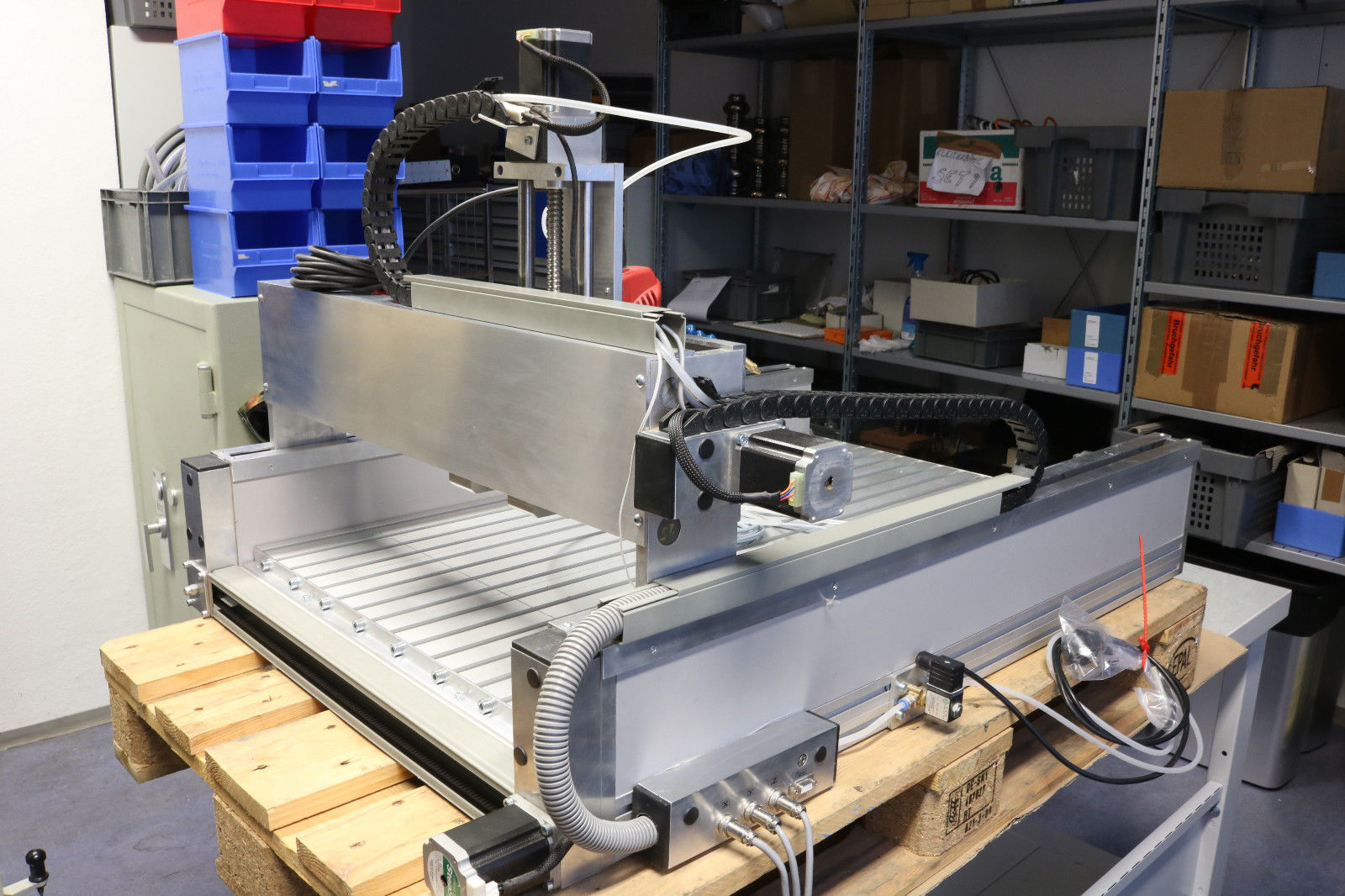

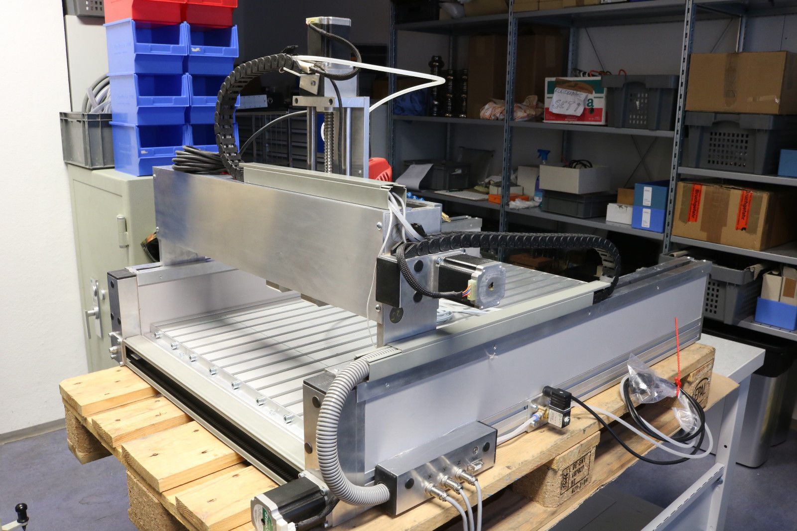

    Any pics of this machine? Seeing it makes it easier to think about options.
    Hi Chaz
    I've tried to get some photos from the web on my phone (no luck I think i'm too old )but if you google makko m850 the new version with ball screws is on their web site with some options. My machine looks the same and they dont seem to have changed the design.
    Cheers.
    Andrew
    I just found some photos on ebayClick image for larger version.
