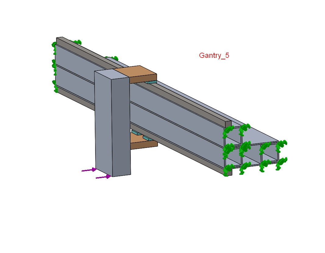

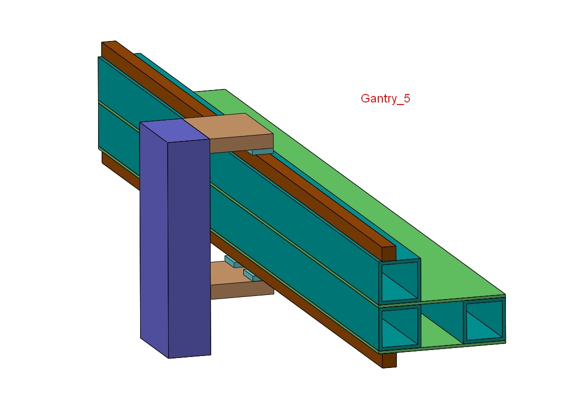

    I inverted the legs of the "L" gantry configuration and reran the loads. As before the images are respectively, Geometry, Loadcase, Results, and another view of results. Deflection decreased from configuration Gantry_4 of 0.034mm to 0.030mm for Gantry_5.

    Better than the decrease of about 10% in deflection is the more uniform deflection distribution over the gantry. In addition the most distorted part is the Z Axis block which is fake anyway. Pretty happy with this configuration but as mentioned above I will need to do some comparisons with the base gantry before committing to the Gantry_5 design.

    #1 Though is an interesting one. The results for torsional stiffness show that the horizontal L (0.030 mm deflection) is better than the vertical L (0.034 mm deflection). This is easy to understand as that load case has a combination of bending in the X direction (for which the section is now very deep), and twisting (for which the section is the same as before). The sum of these gives an overall benefit for the horizontal L.
    But the vertical loading needs to be checked as this will now be less stiff for the horizontal L. This is important to resist sagging due to the spindle/Y axis mass and causing machined surfaces to be bowed.
    From a practical point of view the vertical L is always going to be a good choice as it allows more fore/aft gantry travel for any given bed length. But from an analysis point of view it will be interesting to see which will win overall . . . . .

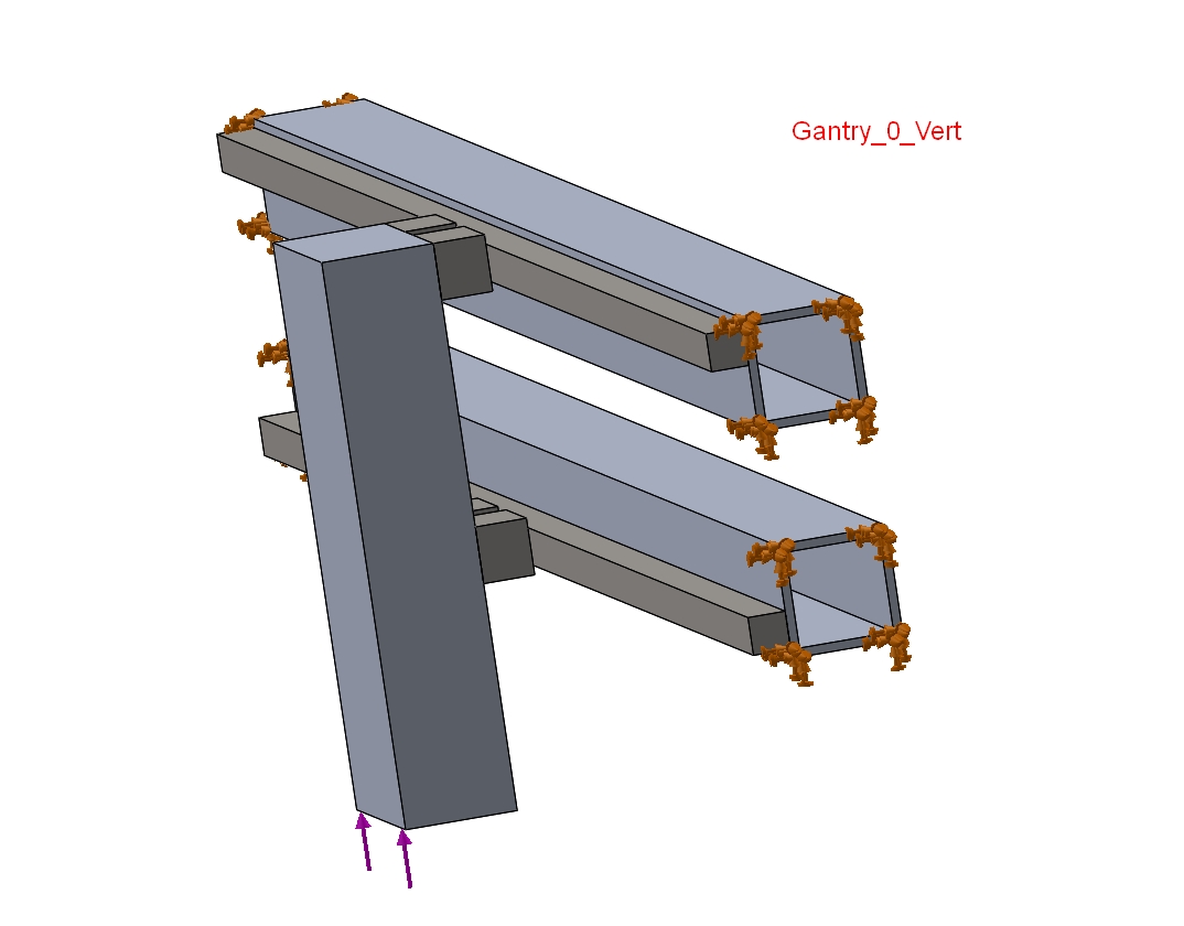

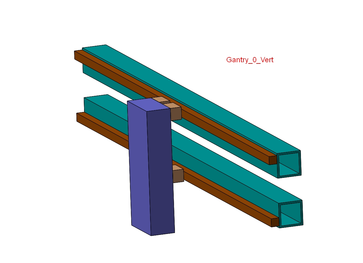

    Did vertical loadcase on the Gantry_0 design (twin separated beams) and the Horizontal "L". Used 500N line loaded distribution in vertical direction.
    Twin separated beams: 0.1mm vertical deflection which will be my vertical comparison metric

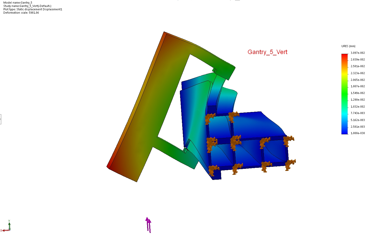

    And the horizontal "L": 0.03mm vertical deflection.

    Still happy with the horizontal "L" configuration. Also like that again the beam has a fairly nice distortion distribution with the horizontal and vertical deflections similar under similar loading. Not sure I need to increase the vertical height of the horizontal "L" configuration or not. Deflections are well matched in both directions and adding height will be a little complex.

    In terms of performance comparisons this confirms what I said earlier in that the vertical stiffness is easier to achieve than torsional stiffness. To get the same deflection in both directions you need a lot more material resisting the torsion/moment than the more straightforward vertical load, hence the horizontal L.
    But I would also say that the vertical and horizontal L shapes would both give good performance in practice, and that in the end it will come down to whether the horizontal L leads to unacceptable loss of travel in the X axis for any given design.
