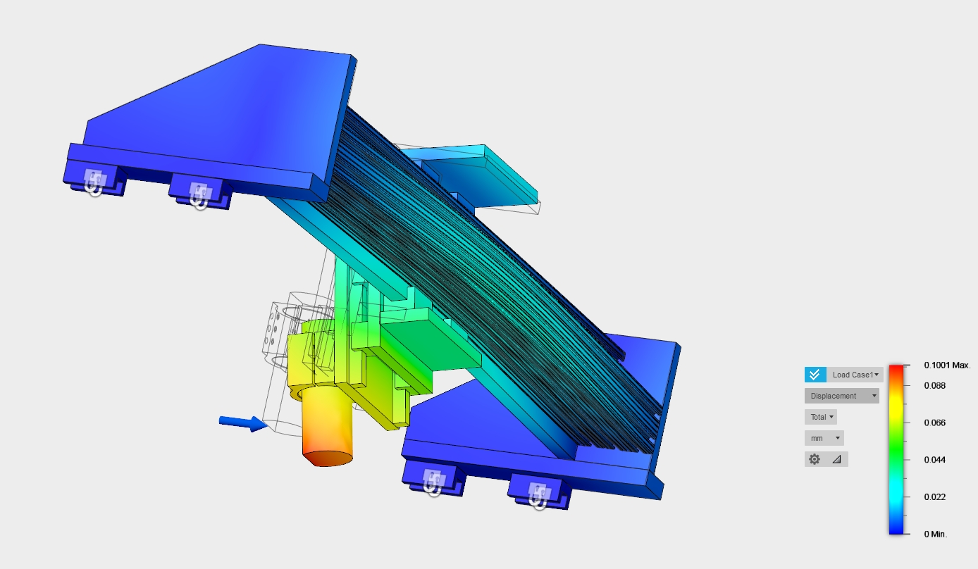

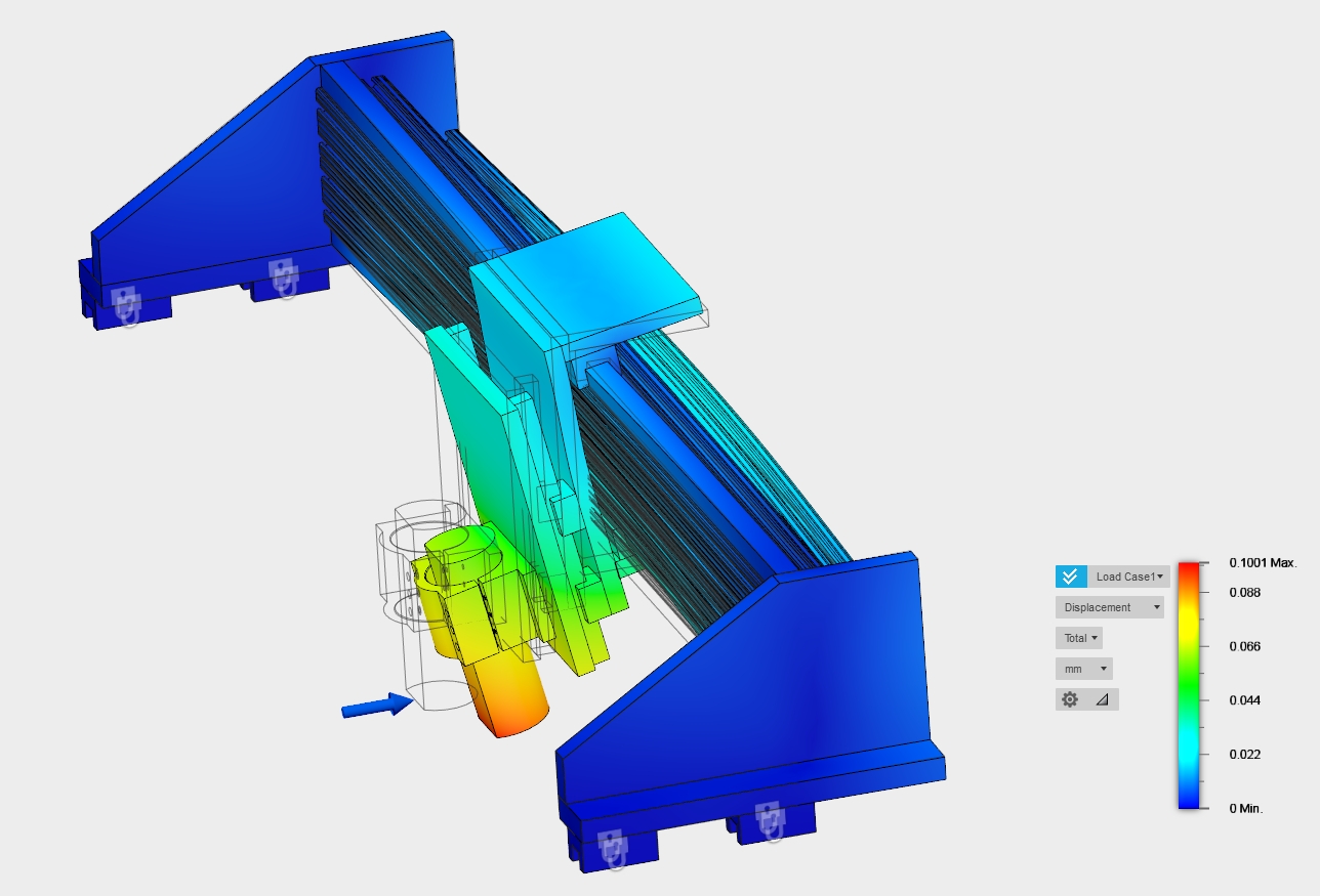

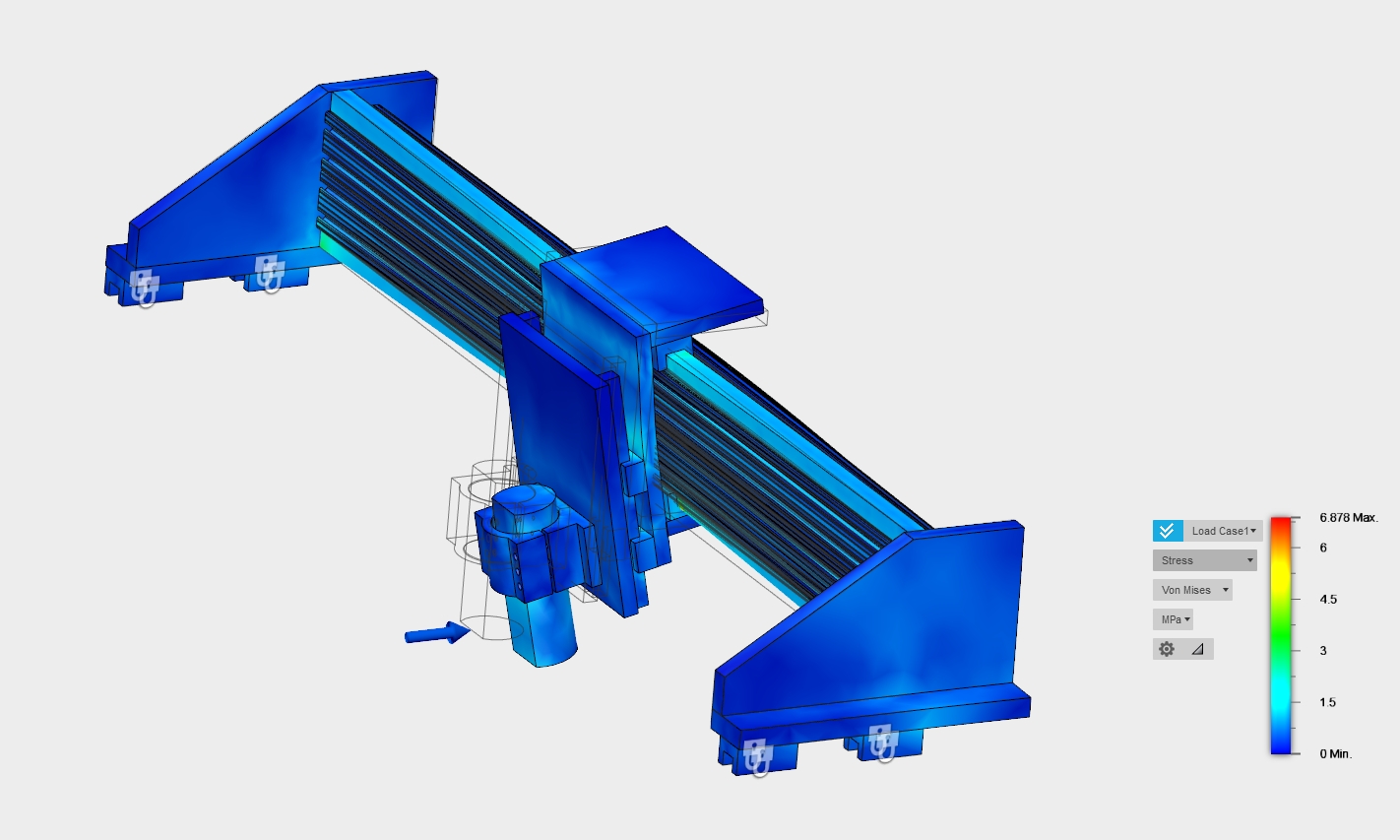

    Ran some more math on my triple beam "L" gantry. With a little less simplification. Generally don't see any major problem. I think it is time to add the final details to the design and then start building the thing.
    Using Fusion 360 now and its static FEA solver. Not sure I will stick with this although the integration with industrial design capabilities looks pretty cool.

  2. #32
    Fwiw..
    My large cnc mill bed is 240 kg in mass, for the bed alone, and up to 100 kg of vice and workpiece, easily.
    So 340 kg++ of mass.
    Worked fine with one small nema 23 stepper of 3Nm.
    48V, 2M542 drive.
    1:3 HTD belt drives.
    Heavy is better, not worse.
    For non-commercial use the speed was never a concern.
    I never needed higher speeds.
    Always wanted more mass, more rigidity, more resolution ...
    leading to better accuracy.
