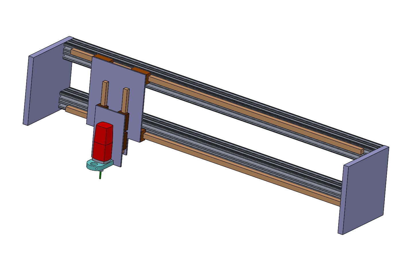

    First picture is what my design looked like before searching around this forum for a while. Looks like I hit all the usual problems
    such as:
    Separated twin beam gantry
    Ballscrew between gantry beams
    Thin Z axis plate
    Z axis rails not on Z axis plate
    Single gusset plate to hold end extrusions to gantry carriage plate
    Probably a lot more problems lurking in that design. So I am starting over. And the first thing I want to do is to settle what the cross section of the
    gantry should look like using the materials available to me. The second picture is of some gantry and Z axis plate cross
    section views with different configurations of extrusions. Trying to come up with some ideas that combine the recommended
    box or L box beam construction with things I have on hand.
    Do the drawings make sense? Any of my ideas decent? Got any suggestions?

    Of the designs you have drawn they all have the ballscrew next to the YZ axis which is compromising the gantry stiffness.
    A popular design here is the L shaped gantry with ballscrew tucked behind. Away from pc so will post example later or someone might post it.

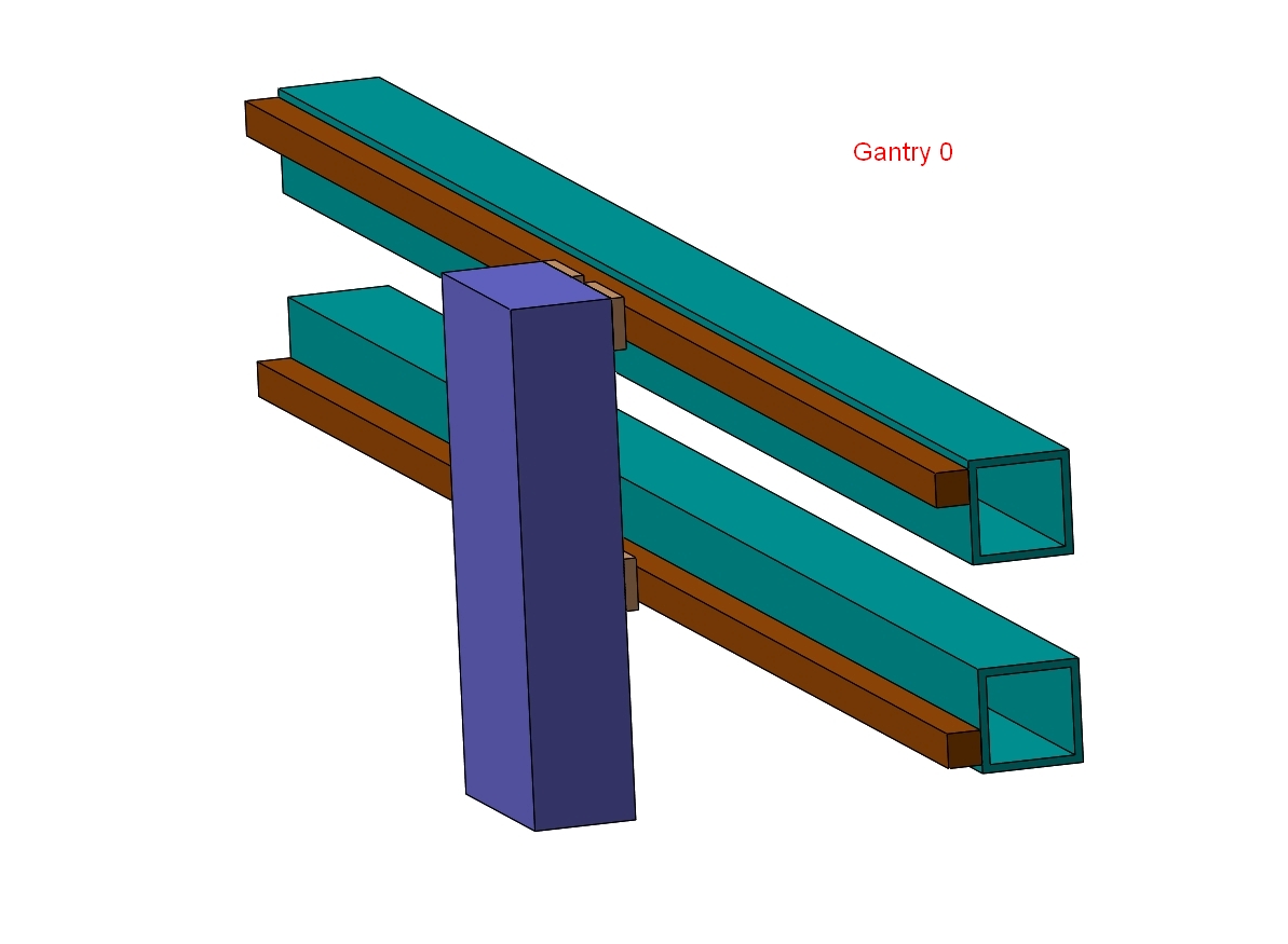

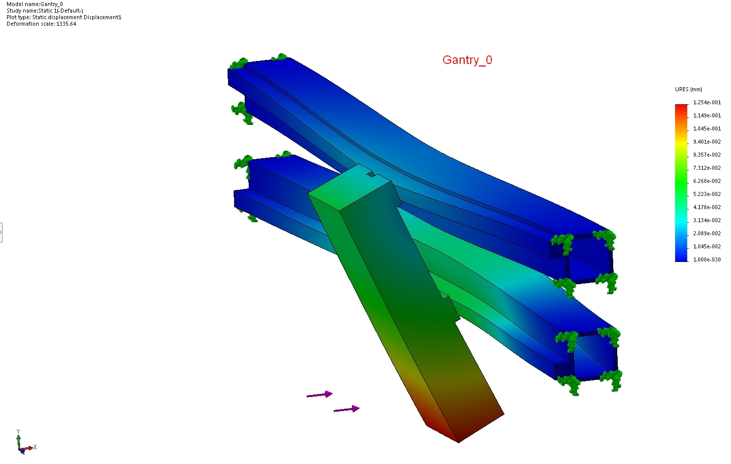

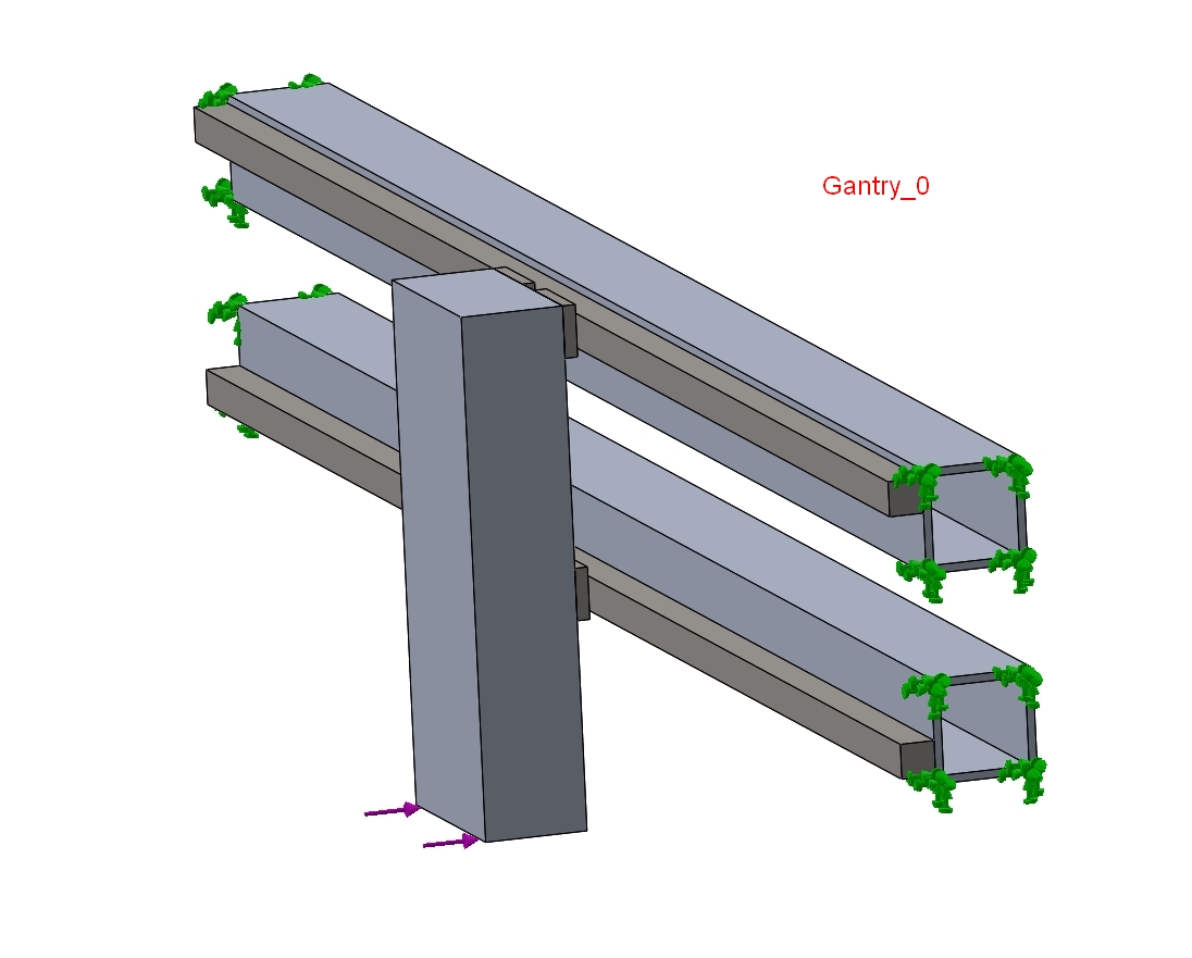

    Got some math working (I think) to compare different Gantry cross sections. Would appreciate any criticisms or comments on my methodology.
    I have gotten my static FEA capabilities up and running and will attempt to analyze some different gantry configurations with it. My FEA refuses to deal with complicated aluminum extrusion CAD so I will simplify the extrusions as a hollow rectangular beams with internal cavity adjusted so that the hollow beam and the 80/20 extrusions have the same moments of inertia. Not looking for absolute displacement numbers, only comparisons between configurations.
    First image is my starting CAD design for the gantry. Called Gantry_0
    Second image is the FEA geometry used.
    Third image is the loadcase used. I am fixing the beams ends in space and applying a line load of 500N at the bottom of the Z axis block.
    Fourth image is the result. About 0.125mm. Means nothing except as a comparison to results from other configurations.

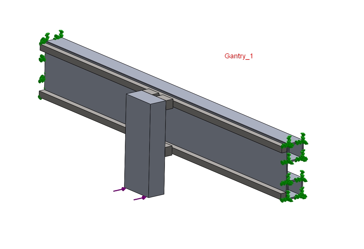

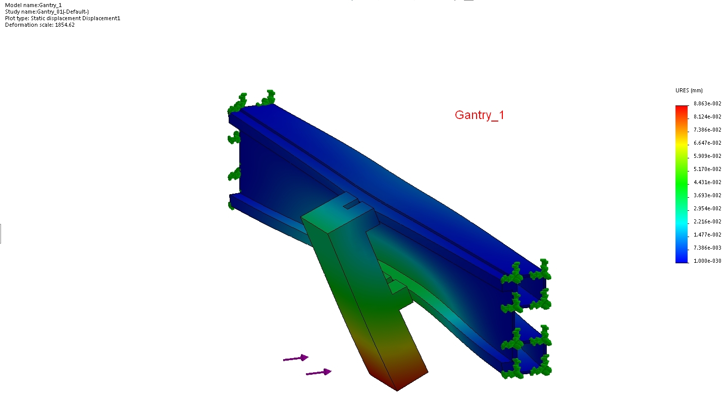

    Next is my first configuration change where I box the beams with a plate underneath the rails. Gantry_1. Again the images are Geometry, Loadcase, and results. This time the displacement is about 0.086mm compared to the original of 0.125. So the plate helped some.
ID:	23236Click image for larger version.
ID:	23235Click image for larger version.

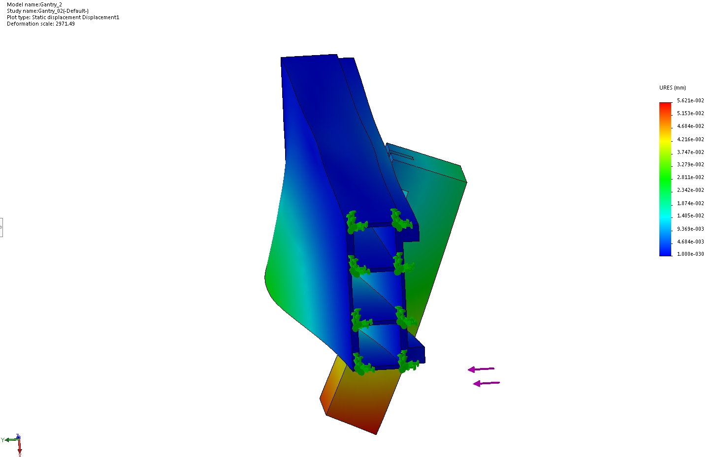

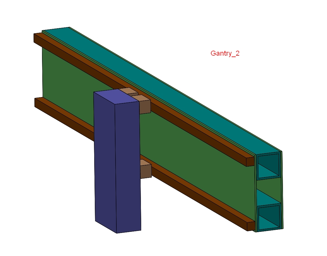

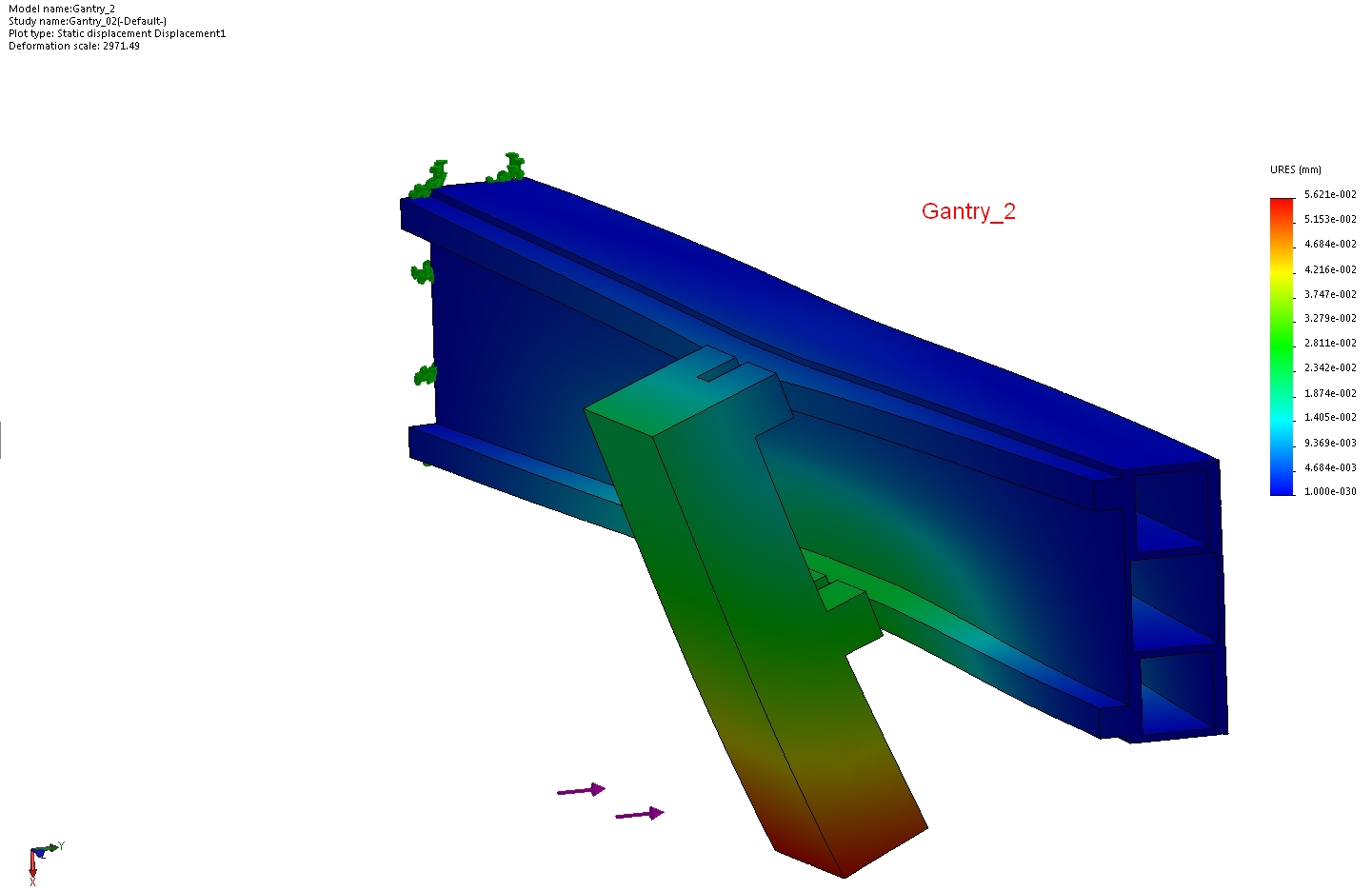

    My next configuration (Gantry_2) is to box the other side of the gantry and see what I get.
ID:	23240Click image for larger version.
ID:	23241Click image for larger version.
    Image progression is the same as above. Resulting displacement is 0.056mm for further improvement in the stiffness of the beam. Hard to see in the results image but the majority of the flex is in the lower beam at the Z axis attachment. See below.
Name:	Lower Beam Displacement.jpg

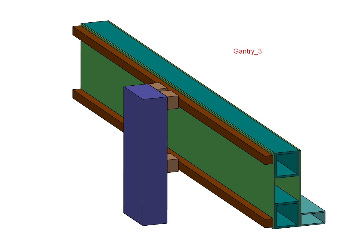

    So I will add a half size beam along the lower beam to form an "L" shape to the gantry. Just like the sticky above recommends, haha. More to come.
    John C
    A circular tube or L shape are among the best ideas I think. In my own build I used an L shape with a flat plate attached to the front, that seemed to work well.

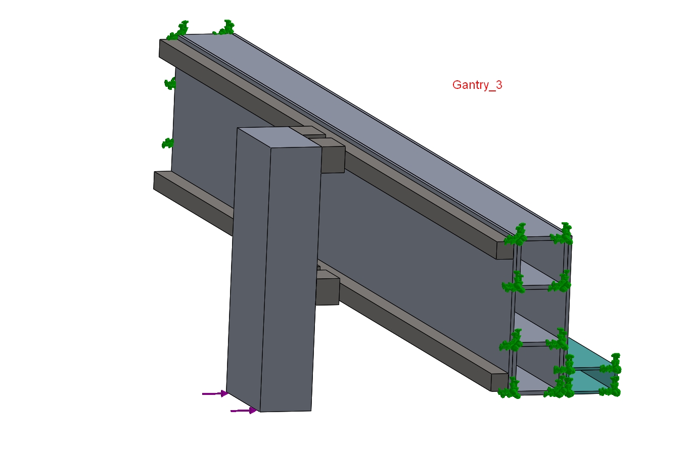

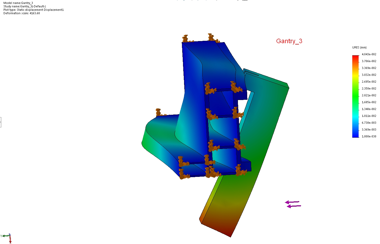

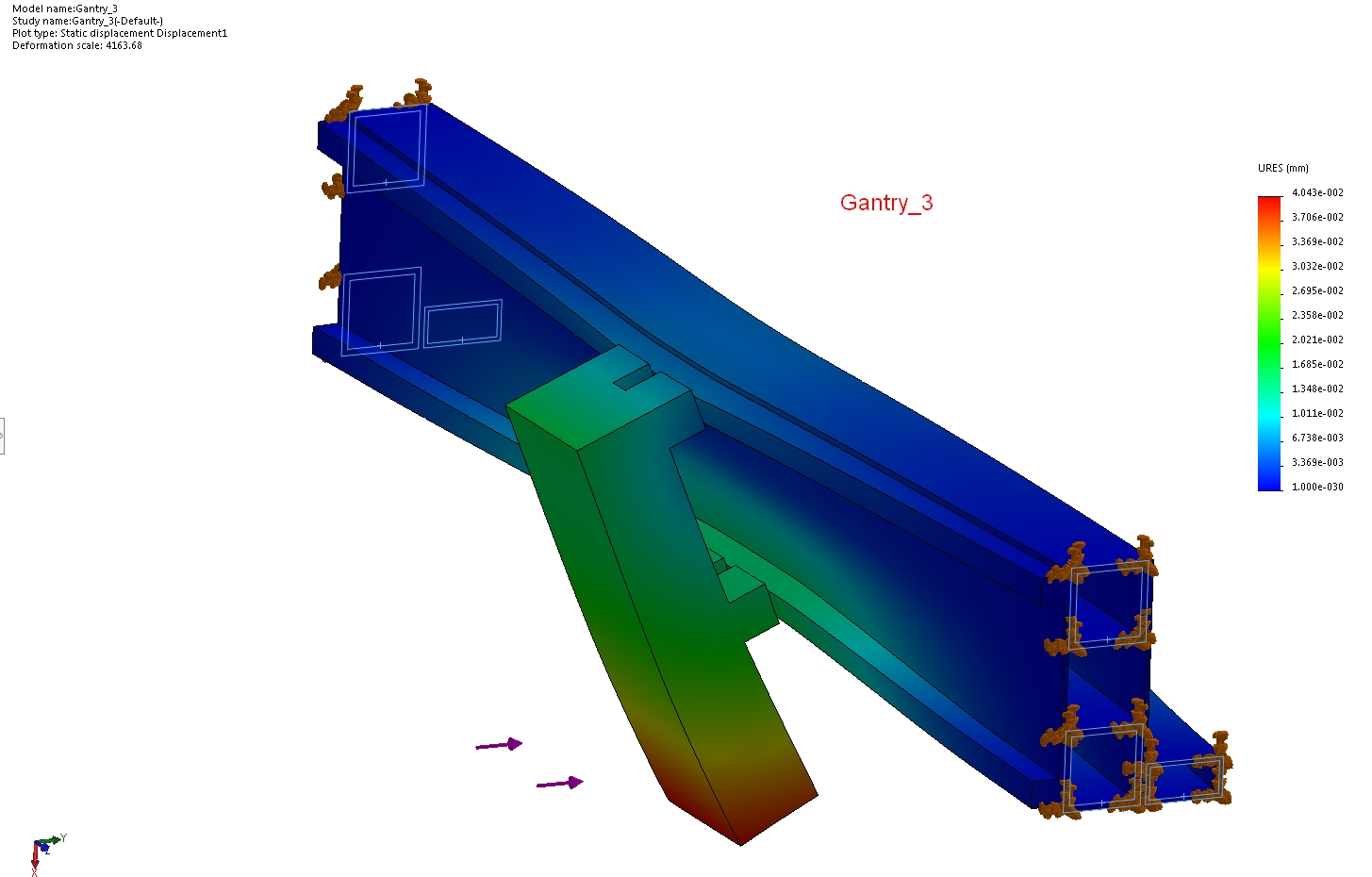

    I added an "L" shaped 1/2 size extrusion to the lower edge of the gantry and ran the deflection calculations again. Got another 20% reduction in the displacement metric. 0.056 to 0.040mm. Not as much reduction as I expected and the gantry is getting pretty heavy. I will try a full size extrusion soon and see how that works as an "L" beam. After that I might try 4 half size extrusions to form the frame of a 250mm square box tube.
ID:	23248Click image for larger version.
ID:	23249Click image for larger version.
ID:	23251Click image for larger version.
    John C
    I don't think the weight will be an issue but are you also taking account of the spindle weight ?
    Try a different L arrangement, http://www.mycncuk.com/threads/6565-...5076#post55076
    Also try the Y rails on the top and bottom faces rather than the front face. This makes the rails further apart which is good and also allows the Z axis to be closer to the gantry.
