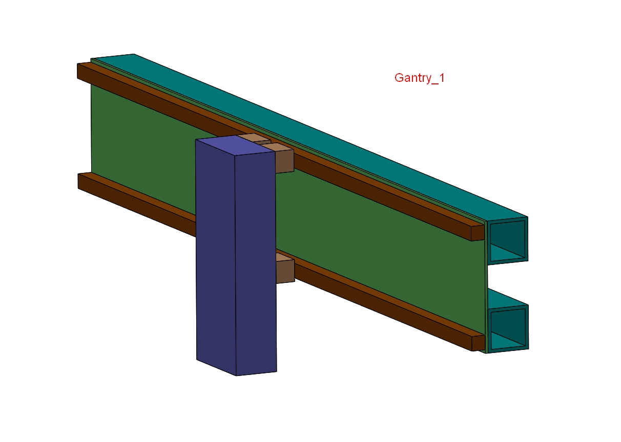

    Next is my first configuration change where I box the beams with a plate underneath the rails. Gantry_1. Again the images are Geometry, Loadcase, and results. This time the displacement is about 0.086mm compared to the original of 0.125. So the plate helped some.

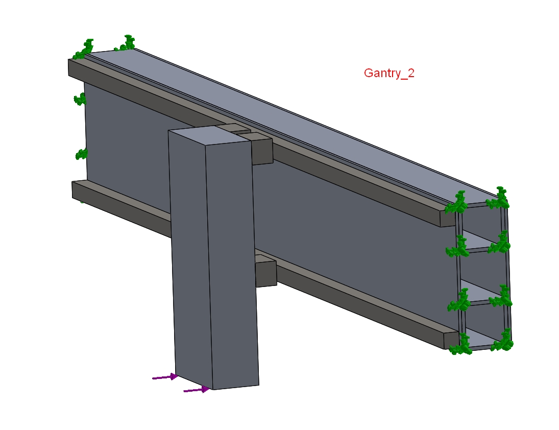

    My next configuration (Gantry_2) is to box the other side of the gantry and see what I get.

    Image progression is the same as above. Resulting displacement is 0.056mm for further improvement in the stiffness of the beam. Hard to see in the results image but the majority of the flex is in the lower beam at the Z axis attachment. See below.
