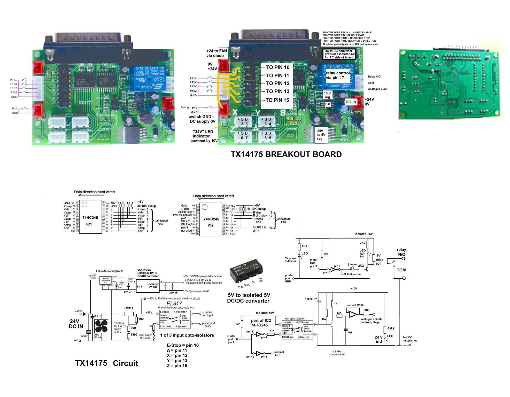

    not all 6040 machines use the same control electronics
    so its unlikely they use the same Mach3 setup
    some have controllers with a combined 3 axis stepper driver & breakout board plus a single stepper driver on 4 axis machines
    others use a breakout board like the TX14175 that I reverse engineered a while back
Name:	TX14175 circuit and board.jpg
    and 3 or 4 stepper drivers like the TX14207 (TB6560 stepper)
    you will need to post more information of what is in the controller
    photos will help
    for machines using TB6560 stepper driver IC
    some suppliers play safe and use a 24V power supply that limits the maximum speed of your machine
    if you attempt to step too quickly you will lose steps
    others use a 36V power supply that over runs the TB6560
    (the TB6560's upper limit is 34V !!!! )
