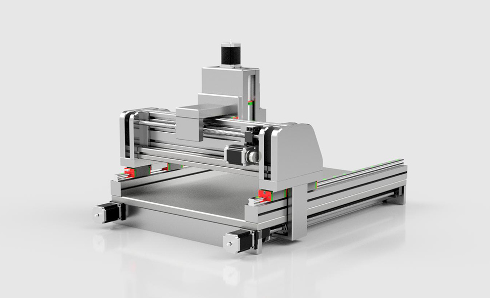

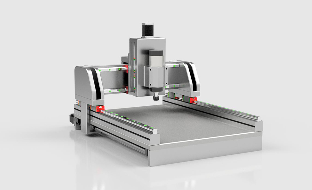

    Well, after a bit of agonising over whether to attach the X axis rails to the sides, under the bed or on top, I have decided to go for the gantry resting on top kind of design, which is what seems to be the consensus for best sturdiness, albeit this router will be built in aluminium, not steel, and its main use will be to cut aluminium.
    Suggestions welcome.
    Specs:
    Bed built with 25mm tooling plate
    X rails plus linear blocks, 25mm Hiwin
    Y and Z rails and blocks, 20mm Hiwin.
    Ballscrews 1605 TBI grade C5 with double ballnut on X and Y
    Motors Nema 23 - 3.1Nm all round. 68V toroidal PSU. Drivers, Leadshine EM806. Controller: Kflop/KMotionCNC
    Y rail mounted on 50x50 heavy duty extrusion.
    Gantry to bed distance 120mm, spindle to bed 135mm. Z rail mounted on the 25mm moving plate.
    Gantry construction: Two piece "L" shape with heavy duty extrusion, 160mm tall in total plus 10mm tooling plate bolted in front.
    Gantry sides, 25mm thick plus additional square brackets in 20mm.
    Underside bed, heavy duty extrusion frame with braces.
    Spindle 2.2Kw.Chinese watercooled.

    Looking beefy :D
    What size slots does 50x50 extrusion use?
    Is the double gantry sides connected somehow or just there for beauty?
    Looking beefy :D
    The extrusion has an 8mm slot, but I will be using M6 bolts for the 25mm Hiwin rails.
    The inner extra gantry sides are basically 4x detachable right angle brackets (for front and rear of gantry) that bolt to both gantry and base. Just a little extra support. It's difficult to see because the renderer "fuses" everything as if it were a continuous flat. One way to avoid that is to put a tiny chamfer so it shows separation between pieces, but I haven't bothered with this or with covers and other finishing details.

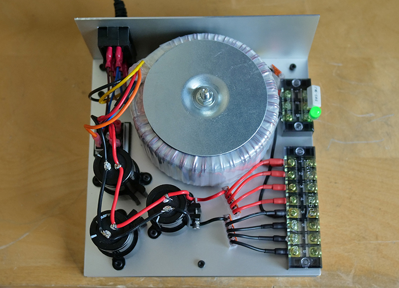

    I've just finished making the toroidal power supply as per instructions by your posts here in this forum. Working well. Here is the video testing one of the four steppers in slow jog, then fast jog and then fast rapid at 3000rpm.
    m_c will be partial to the lovely control board. The driver is an EM806. The microstep was set at 1600
    The transformer is 24V-24V, it gives me 70V output with the driver connected. 3x capacitors 4700uf, 100V, 105deg. Bleeder resistor is 3K9 5W with Led in series. With nothing connected is discharges the capacitors completely in around 4 mins. With one driver, in 7 seconds. Slow blow 5A fuse in the 240V input.
