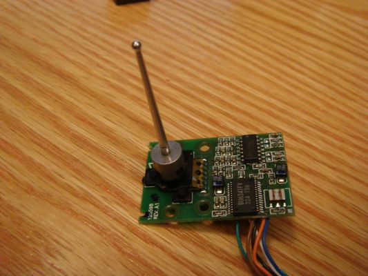

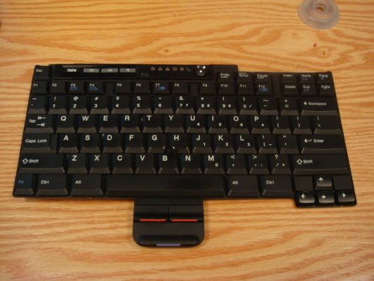

    Well have you seen the edge finder a guy posted on the zone ? i also read about a guy who took the mouse from an old laptop and turned it into a edge finder.
    Is that the kind of thing you mean or ?

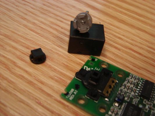

    Just found the pics i was looking for irving:
ID:	802   Click image for larger version.
ID:	803   Click image for larger version.
ID:	804   Click image for larger version.
ID:	805   Click image for larger version.
