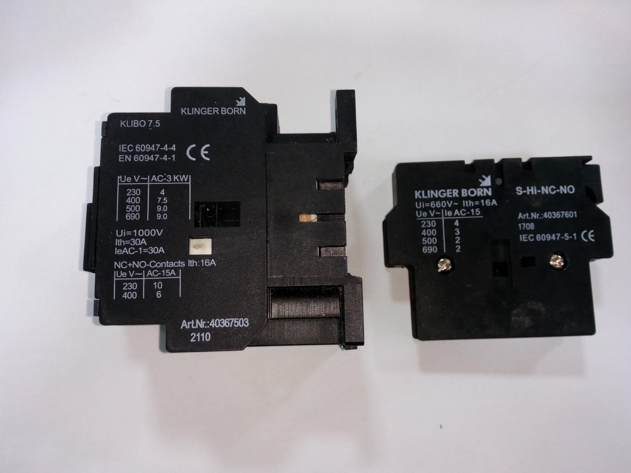

    I would refit the original contactor and auxiliary as there may be some time delay involved here.
    The drawing is one of the worst I've seen and it's not easy, for me anyway, to determine exactly what's going on, and I've used some complex drawing in the past.
    I've attached a copy of the single phase version if it helps sort this out, (not studied it yet though)
    Yes I get the loud humming noise when I stop the machine.
    Here is a picture of the original contacts and auxiliary, I've split them apart so you can see the information.
    I can not see that they have a 1 second delay, can you? Click image for larger version.

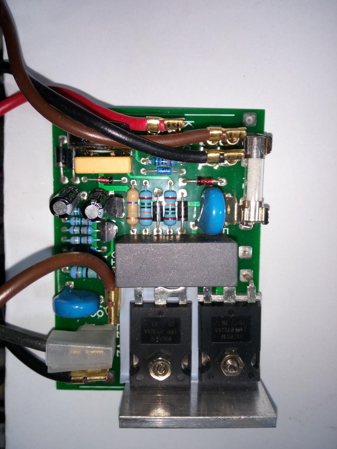

    See pictures - Yes the wires are connected on the PCB board, paired together as you thought, I checked them with "the tester"
    Other red wire goes to 24 and brown to R7

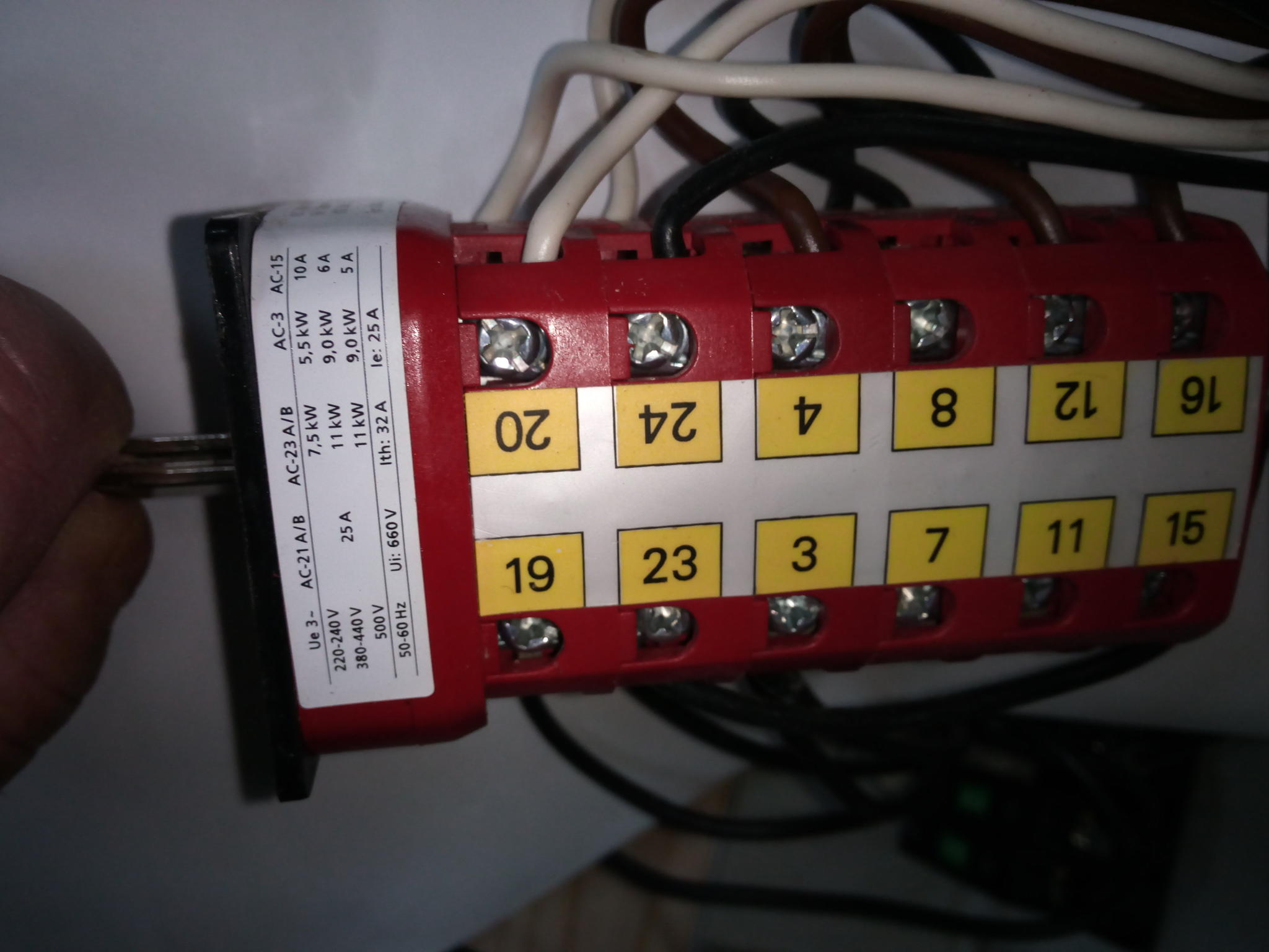

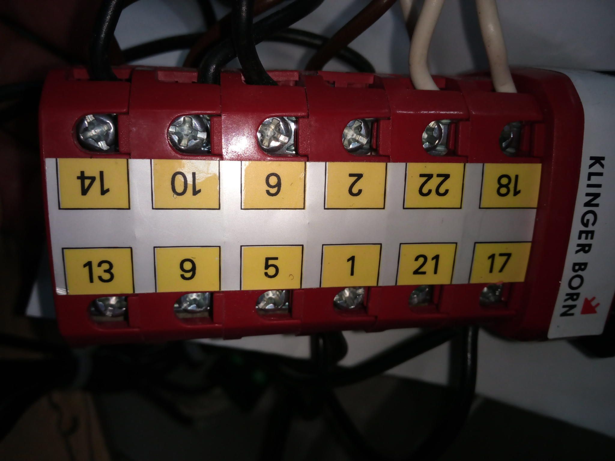

    Also see pictures of rotary switch, you may be able to work out how it works. It could be the issue if you see my other post to Mr EddycurrantClick image for larger version.

  4. #24
    This is the brake unit I think; http://www.klibo.com/brake_16a.html?L=1
    and there are drawings etc.
  5. #25
    Lives in East Lothian, United Kingdom. Last Activity: 15 Hours Ago Forum Superstar, has done so much to help others, they deserve a medal. Has a total post count of 2,994. Received thanks 376 times, giving thanks to others 9 times.
    So it is a DC injection brake, in which case disconnecting the link as I suggested will stop the brake from functioning, although I think you'll also want to disconnect the wire going to the Sp terminal on the braking module, as going by the diagram for it, the Sp appears to be some kind of detection signal (it only gets powered when the contactor is active).
    However, I still suspect the real problem is the supply voltage sagging with the starting load.
    What happens to the main phases powering the control circuit (L2 & 3 on the diagram) when everything is starting?

  7. #27
    I agree with m_c about which wires to remove, however it may be easier just to pull the connections from C1 and SP at the brake board.(insulate them after diconnecting)
    I don't know about the switch enigma but as a starting point you should always check contacts with the wires disconnected to prevent feedback.
    If it's okay in the saw position I suggest getting the machine running like that for a start.
    Operation of the brake looks like this to me.
    If there is voltage or has been voltage at terminal SP (even briefly) and there is a circuit from C1 through the motor winding back to L3 (i.e. contactor has just been de-energised) then brake.
    If there is voltage at terminal SP (even briefly) and there is no circuit from C1 through the motor winding back to L3 (i.e. contactor energised) then do not brake.
    If there is no voltage at terminal SP (or a brake operation has just completed) and there is a circuit from C1 through the motor winding back to L3 then do not brake.
    This also explains why the brake will activate if 'start' is pressed while an e/stop is activated. Start button contact 23/24 apply voltage to SP briefly when pressed but the contactor is de-energised.

    There is nothing in the diagram that indicates why the contacts 1 & 2 would show as having continuity, however the other two main contacts could, so it's probably a discrepancy between the diagram and the actual machine.
    As Eddy says, you should only be testing for continuity with the wiring removed from the contactor.
  9. #29
    The rotary switch (10) has 4 positions.
    1. Saw
    2. spindle moulder forward
    3. spindle moulder reverse
    4. planer
    It's hard to see why there should be the difference in readings across the contactor as the assumption is that switch 10 just swaps motors.
