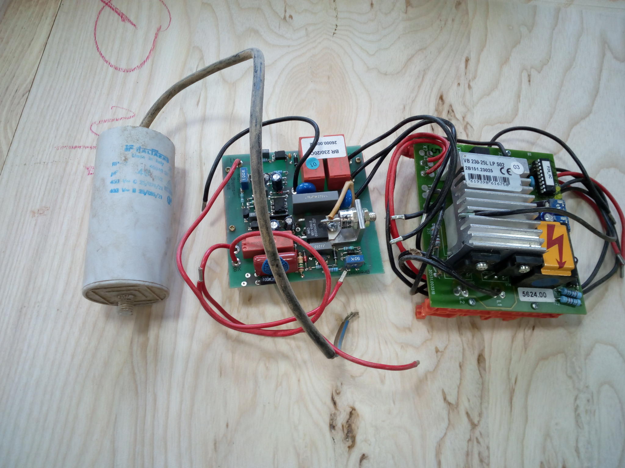

    While I was rummaging around I came across these old spares for the 240v machine, don’t even know if they work, yours for the asking.Click image for larger version.
Name:	Spare Parts C3-31 240v.jpg

    I was thinking you could have bought the brake unit direct from Klinger Born.
    I'll send a pm about the spares, many thanks.

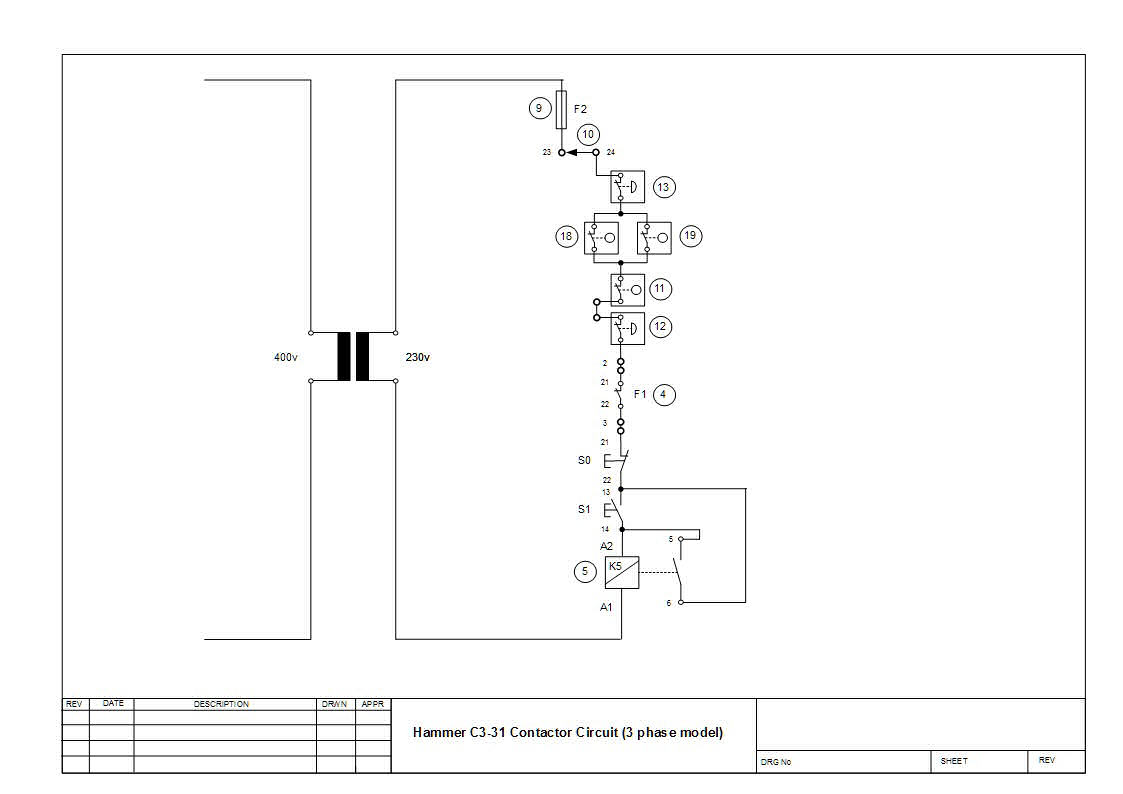

    If it does, then measure the input voltage.
    If it doesn't drop, then you need to work your way through the various things that can control the 230V on it's route from the transformer to the contactor.
  7. #47
    I can't see why the braking circuit is affecting it, especially when a new part from the manufacturer results in the same probelm.
    I have drawn out the coil circuit for the contactor and I'll post it tomorrow all being well.
    As you say, I would normally start at the supply, but as we have found this does not give results you would expect from a standard 3 phase supply.

    As far as I can make out, the attached drawing is the coil circuit for the main contactor that is chattering. It may aid in the fault finding process.
    The important question is, which components were included in the replacement control box that Felder suipplied ? because the fault is obviously external to that.
