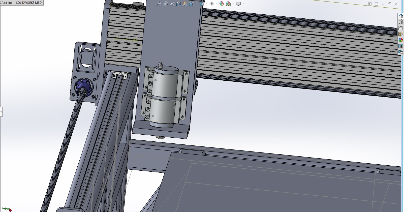

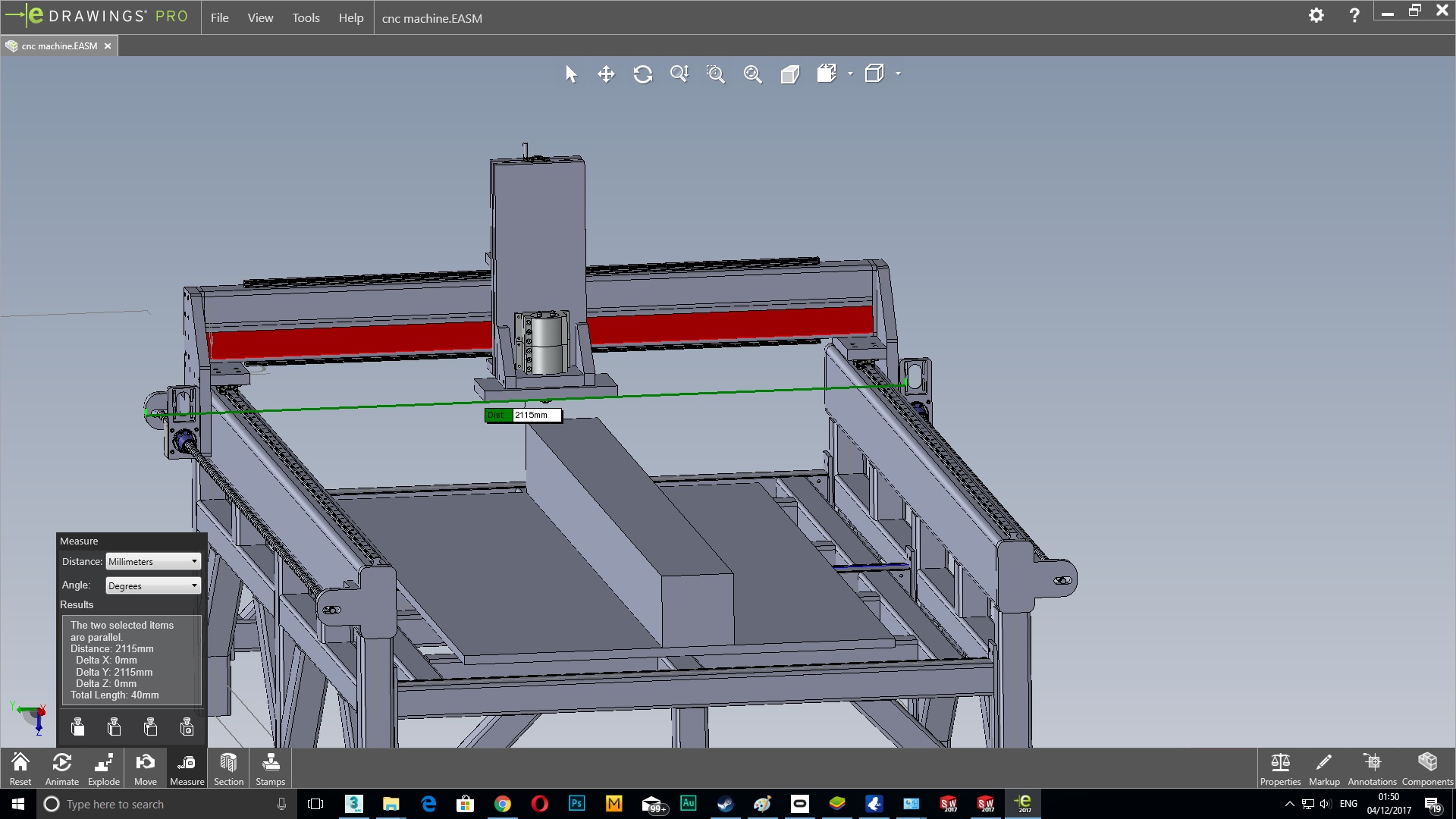

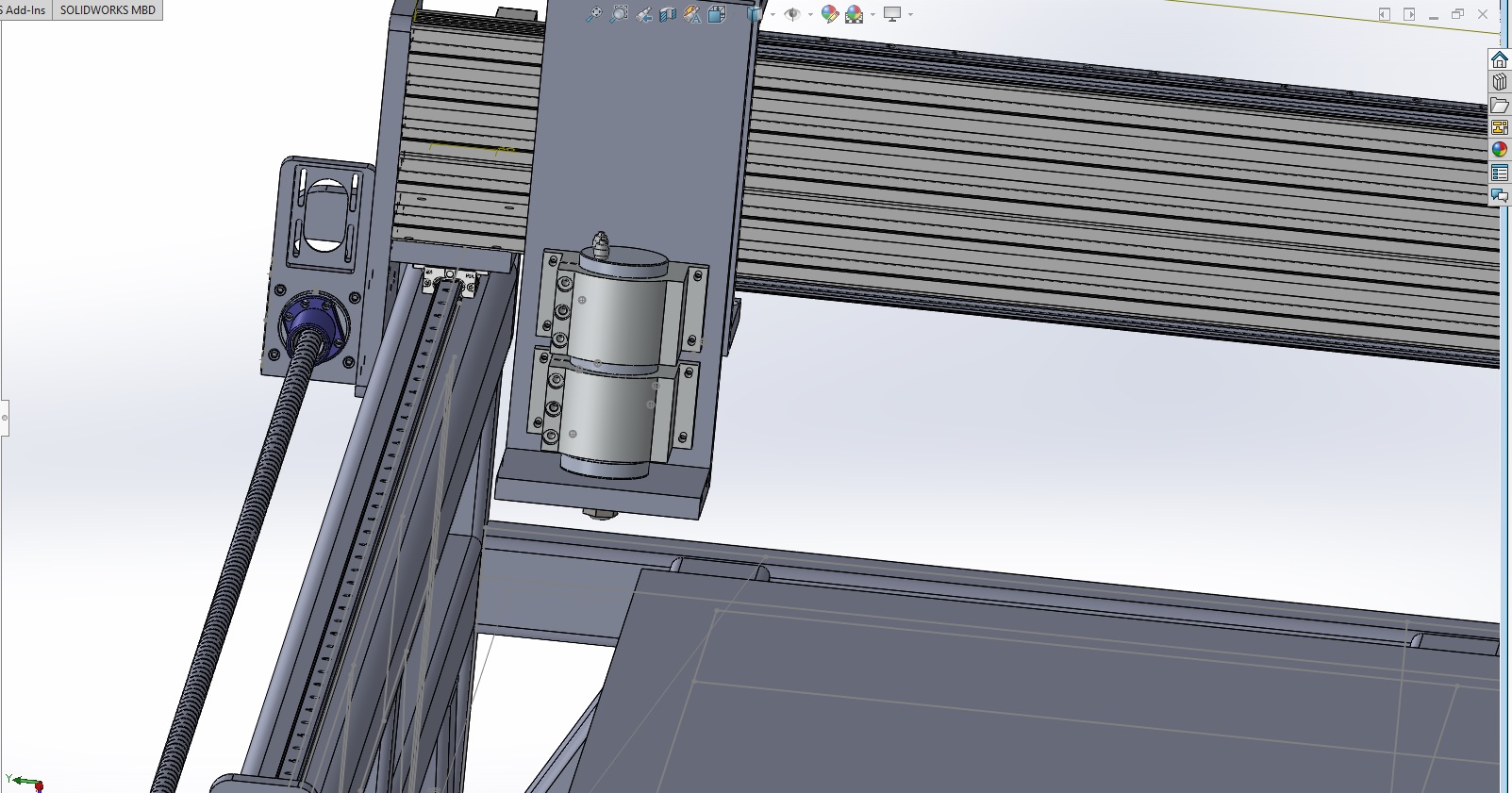

    ok so i am bringing my size down from cutting 8x4 sheets to 4x4 due to size issues, i need to try and get the whole machine size as close to 5ft wide as possible but i cant seem to bring it any lower then just over 7ft with the design i have. I am just focusing on cutting wood only now but at very high resolution so if anyone can give me some pointers on how to get this thing smaller while still keeping it very strong would be great.

    If your rails were on the underside your ball screws could be on the inside, this could save you significant width as only the vertical moving parts of the gantry would need to be outboard of the working area.

    Here's something a bit more radical. You say you want to cut wood, but that spindle bracket and Z plate assembly looks as if it's designed to carve battleships from the solid. Why not slim down the Z plate so that, below X rail height, it is no wider than the spindle and its mounting. The mounting itself stiffens the Z plate anyway. Put just one hiwin carriage on the bottom Y rail right behind the spindle. Keep, or widen, the top of the Z assembly and use two carriages which can go over the top of the X rails for more resistance to twisting. That could buy you about 100mm extra Y travel, at a guess.
    My feeling is that our size machines barely make the hiwin slides break into a sweat - they are happy to take much higher loads than we usually put on them, and one at the bottom might well be sufficient.

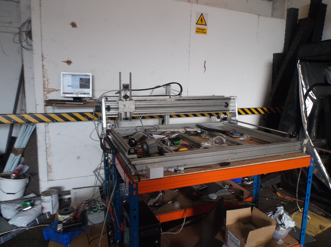

    I have 1.3m of travel * 80cm of travel in a footprint of 1.6m*1.1m plus the bit my nema 23's stick out but they could be belt driven and slung under the body to save space.

    Although I used aluminium extrusion
    My Z axis wastes 25cm of travel! Simple redesign could easily save 10cm
