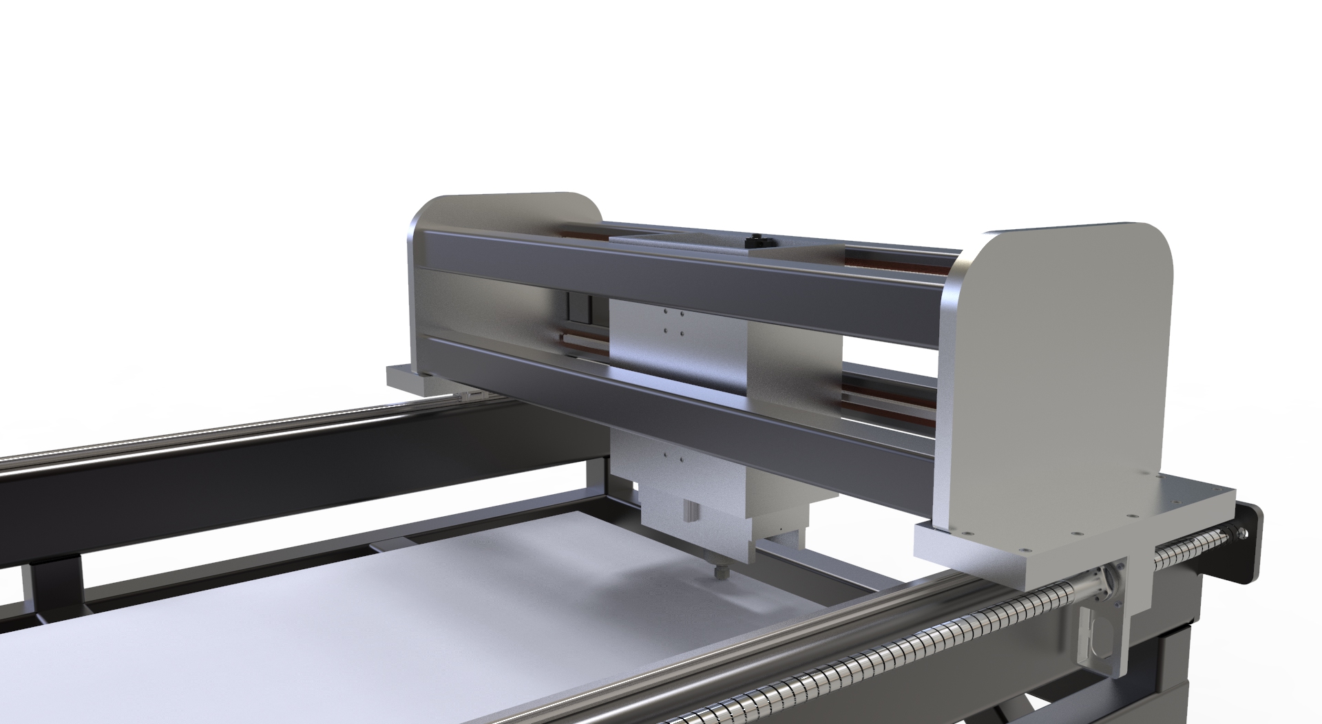

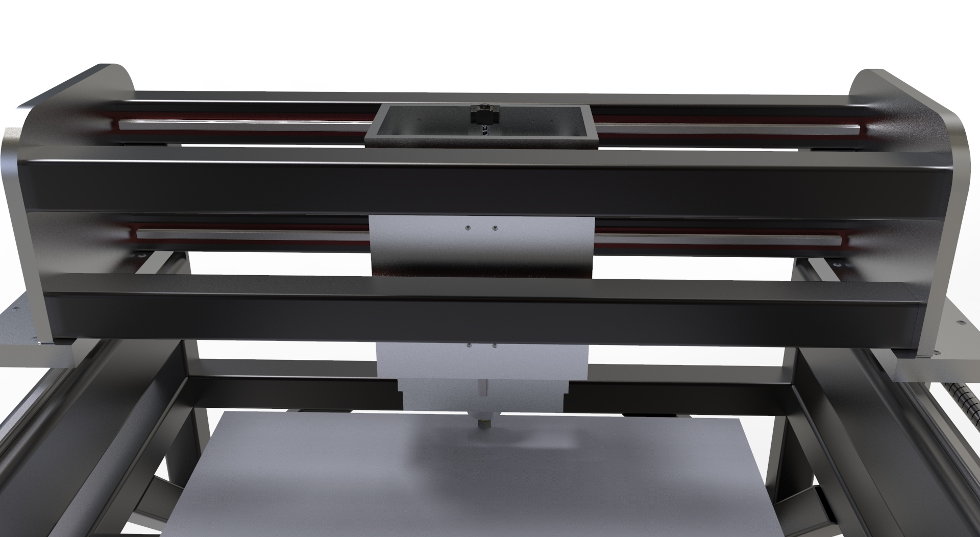

    What do you think of my idea which probably some of you may think its a waste of money on the extra epoxy resin.
    There will be 2 gantry sections so the z axis is boxed in the middle.
    this is just a quick rough up, the red pieces are the epoxy resin fully cured
    1. weld the steel box sections together
    2. lay the sections down on a level surface and pour epoxy resin
    3. after 10 days or however long it takes to cure flip the sections back to normal position.
    4. attach gantry side plates and adjust and bolt to as square as you can get it.
    5. again pour epoxy resin to level both sections on the same plane
    6. attach the linear rail on the front of the sections and then use a magnetic gauge indicator and use the top to line up the rails.

    I dont quite get it.. will one set of rails be on top and 2 sets in between? :D
    For question 1 you should read boyans build threads. Somewhere in there he states DIN numbers for the necessary straight edge and where to find them. If Im not misstaken he also wrote about the squares..
  4. #184
    no just 2 sets in between and the epoxy on the top is just a reference for the gauge indicator, one some videos people sit a magnetic block onto to linear bearing blocks and the have the gauge indicator touch against the aluminium extrusion all the way down the rail until its square but aluminium extrusion is not perfectly straight but with the epoxy resin being very flat and straight then i thought doing it this way may work.

    Now I get it, smart! ;)

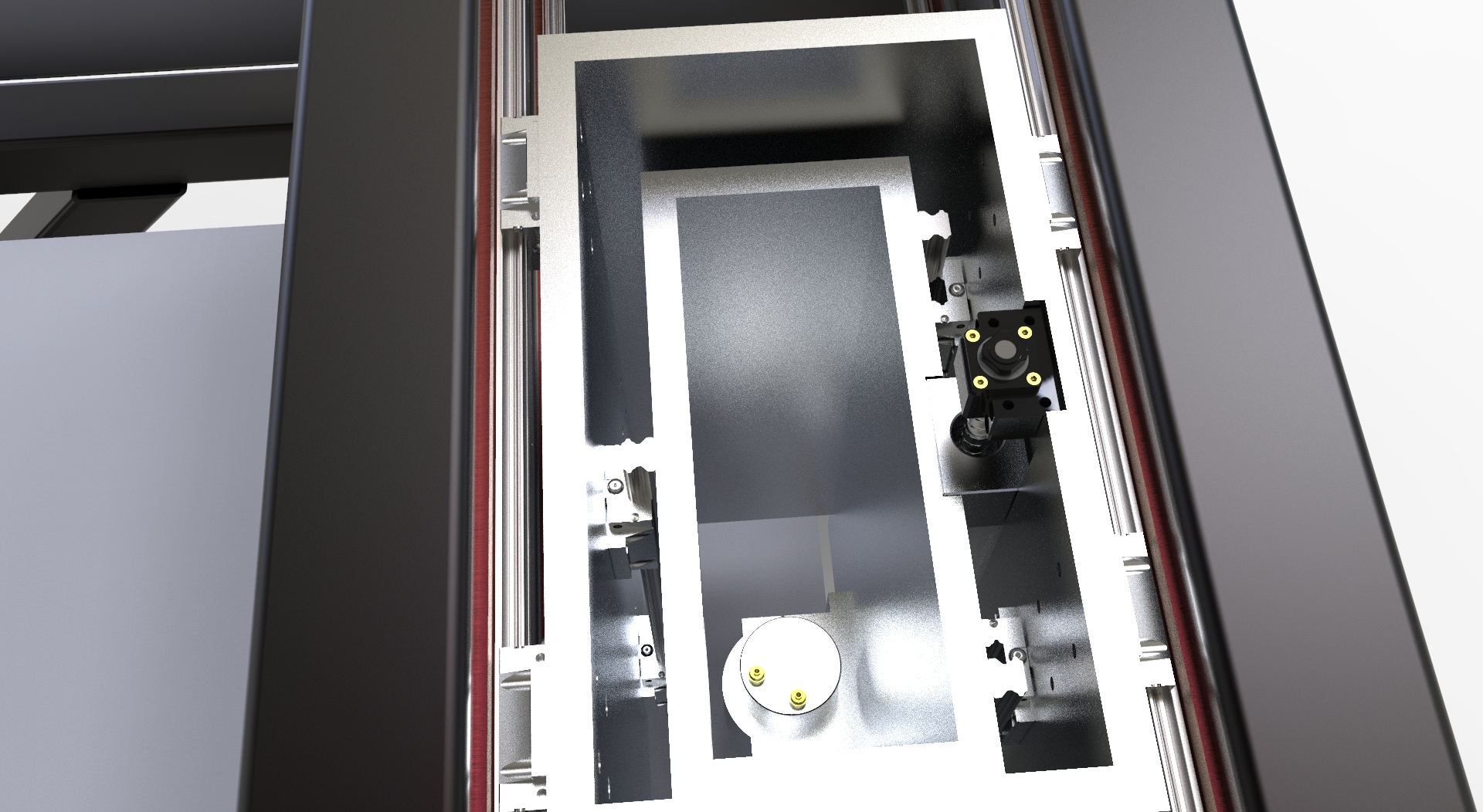

    Cheers mate, still need to brace the bed frame a little more at the bottom and brace the side gantry plates but would like some feedback if anyone thinks i will run into any problems. will be extending the bed by another meter at the bottom for a 4th axis, z height is 200mm but can also do up to 400mm by making the 4th axis centre in line with the bed so with the z axis boxed in do you think this is strong enough for what i wanted it for?
