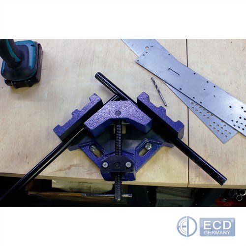

    would this be useful i just heard of it watching a video but not sure of the accuracy

    So design your base so that the two rails which must be in the horizontal plane bolt to it!
    Hey Presto!
    No machining!
    No Epoxy!
    If you pay for fuel I'll provide use of my Optical Clinometer which is good for ridiculous tolerance when you level the feet for the base and then set the rails.
