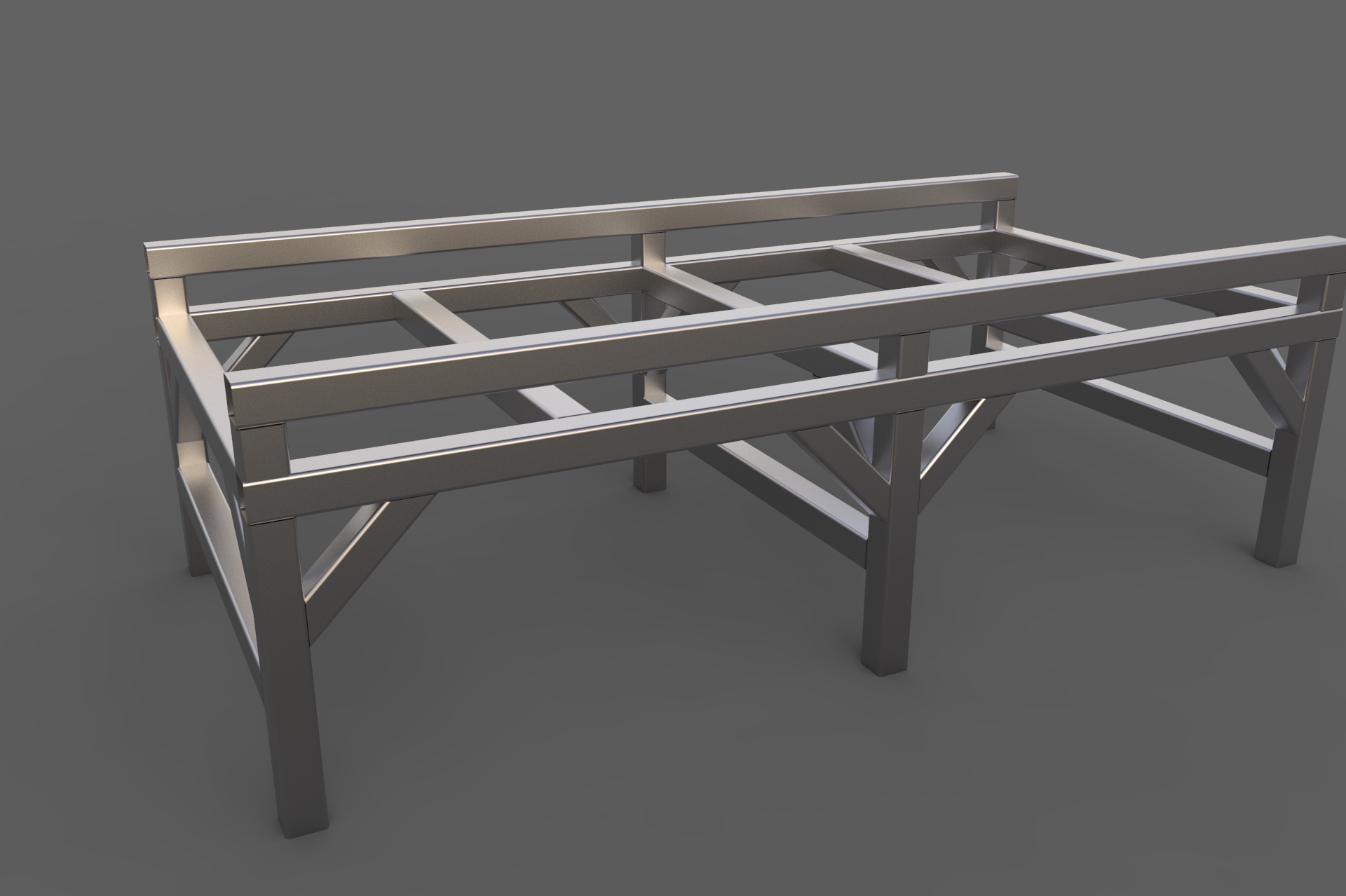

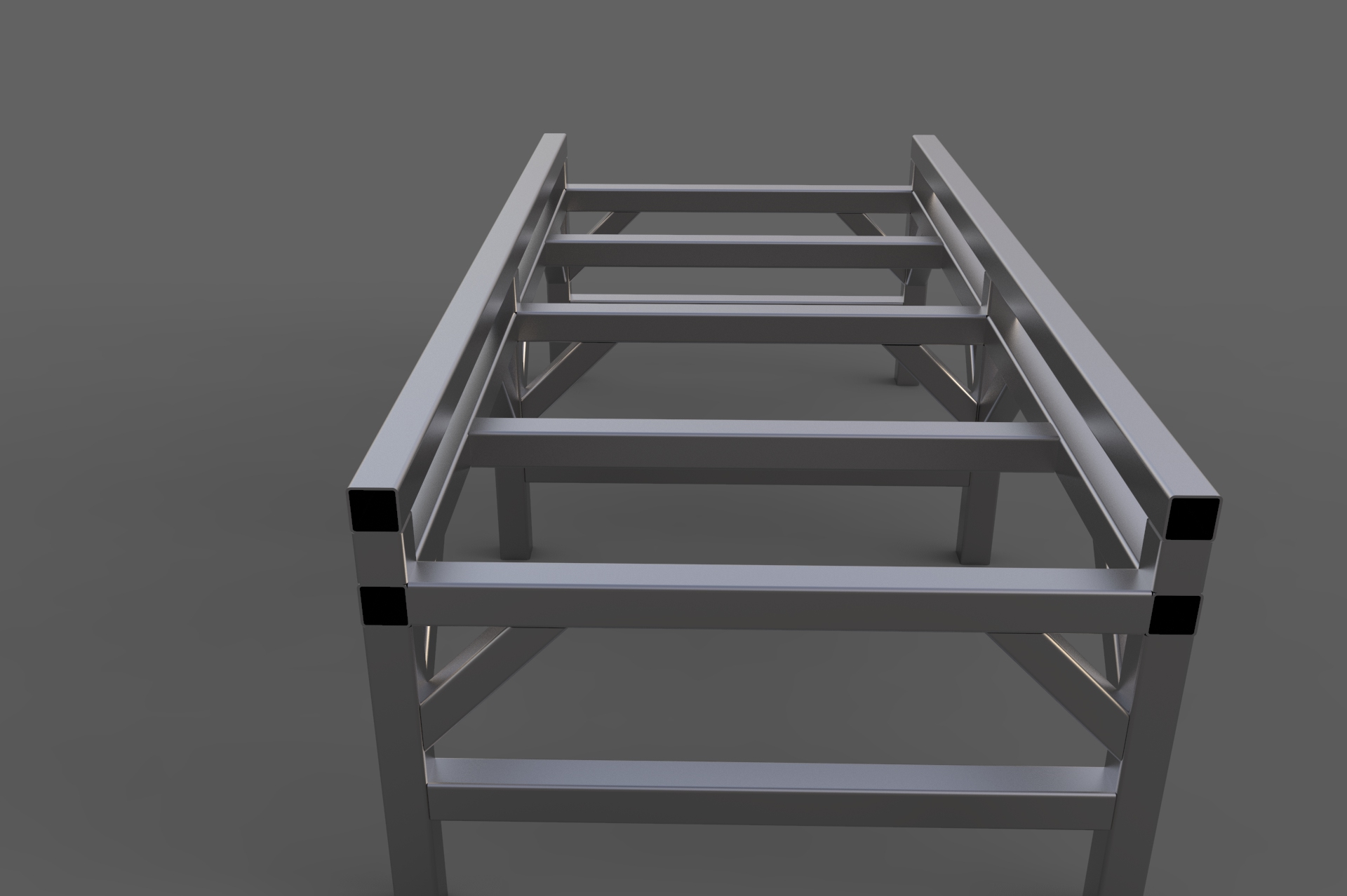

    thanks boyan, about the frame do you think i am on the right track with the frame design? i just want to get the design nailed so i can crack on with pricing and getting required tools ect.

  7. #47
    Lives in East Lothian, United Kingdom. Last Activity: 20 Hours Ago Forum Superstar, has done so much to help others, they deserve a medal. Has a total post count of 2,994. Received thanks 376 times, giving thanks to others 9 times.
    Weld it on as flat a surface as you can.
    If I was going to do something like that, I'd be buying a big spirit level to ensure the main frame was set as level as possible to welding, and a big set square for ease of checking things are square during initial setup (I'd also be measuring corner to corner to check squareness after the initial tacks are in place).
    If you order metal pre-cut, you may still have to grind it to length, as cut tolerances can be quite big (typically -0mm to + several mm).
    As for welder, I'd go for something in the 150-200A range. You won't need that much capacity, but at that rating you shouldn't need to worry about duty cycle. Ideally gas MIG is better, but the cost of gas can mount up if you're using disposable bottles, and the rent on full size bottles is quite costly. There are suppliers where you can buy bottles, but you really need to find one locally, and check to see how much the gas works out to per litre (some of the schemes where you buy bottles don't fill bottles to that high a pressure, so you don't actually get much value for money).
    Other option is gasless MIG using flux cored wire, but then you have to deal with flux/slag cleanup afterwards (best way to describe is, is it's pretty much ARC welding, but with a roll of wire instead of rods).
  8. If you don't want the cost of mig I had pretty good success with a cheap Clarke stick welder from machine mart. No gas to buy either. Defiantly get an auto darkening visor though and some decent rods. For a welding table i bought a massive lump of 12mm steel plate from a guy in Telford for about £20. I found welding very satisfying!
  9. Helpful video:
  10. Ps I find it hard to comment on a frame without seeing it in context with the rest of the machine but on the face of it it looks pretty solid
