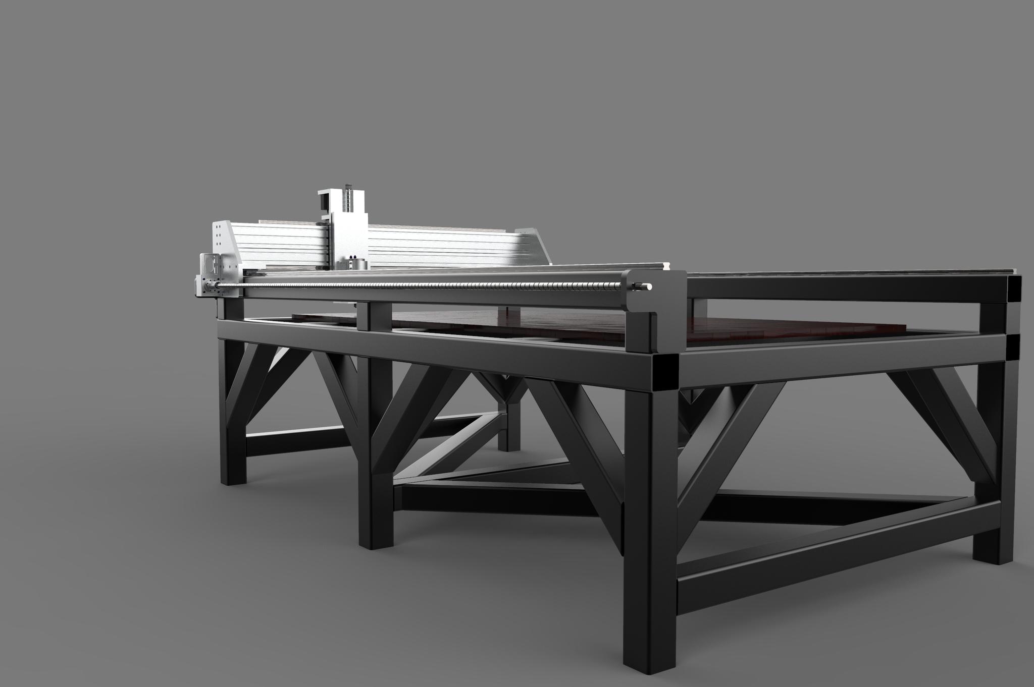

    Quote Originally Posted by reefy86 View Post
    anything wrong with this frame and is the diagonal supports ott? i will be adding adjustable feet on aswell
    cheers
    Attachment 23334
    Attachment 23335
    You forgot diagonals when looking in the plan view, see here what I mean; http://www.mycncuk.com/threads/6565-...2425#post52425

    You forgot diagonals when looking in the plan vew, see here what I mean; http://www.mycncuk.com/threads/6565-...2425#post52425
    Thanks eddy ill add these in :)

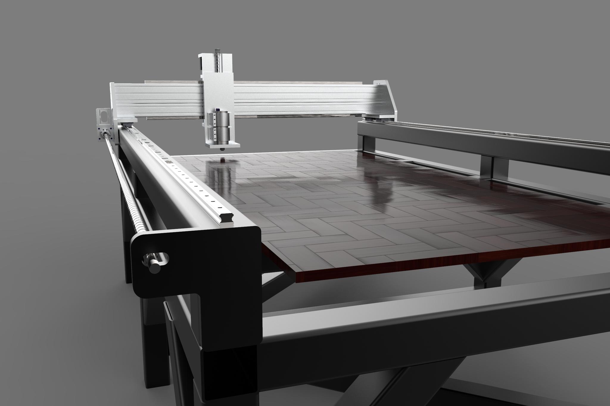

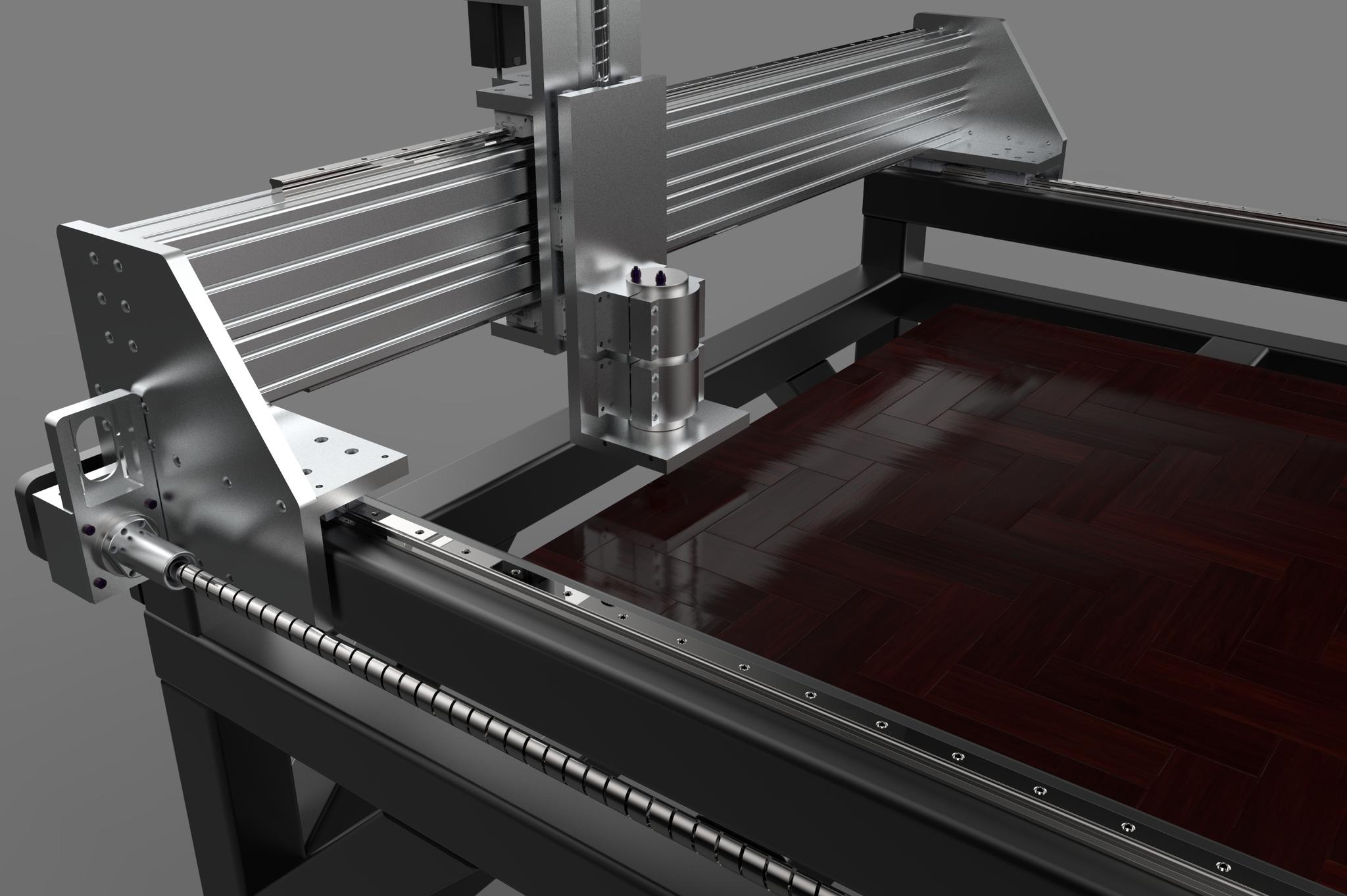

    if only you could get the steel this clean lol, anyways i know i did this all before but ive done a few tweaks but i am a little concerned with the gantry side plates being so wide and because the aluminium gantry beam is pushed to the back it leaves a large space on the flange plates. this is because i was reading about not having the z axis over hanging and to have the gantry side plates in front of the z axis.
    I have gone with 100x100x5mm all round for the frame
    all plates are 20mm thick aluminium
    linear rails 25mm
    ballscrews r2010 driven on both sides with nema 23's 4nm and a rotating ball nut due to long 3000mm ballscrews
    still thinking for the rest but whats your thoughts?

  8. What's with the parquet bed?!
