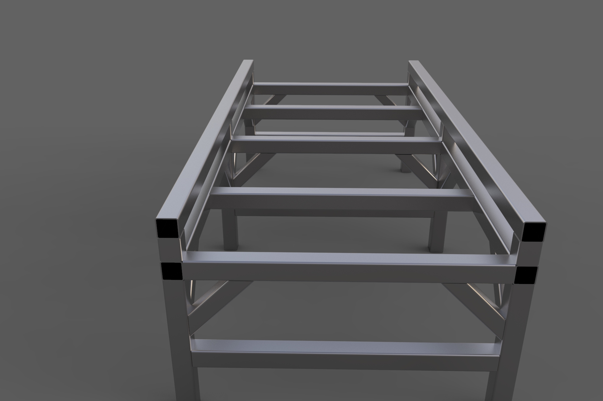

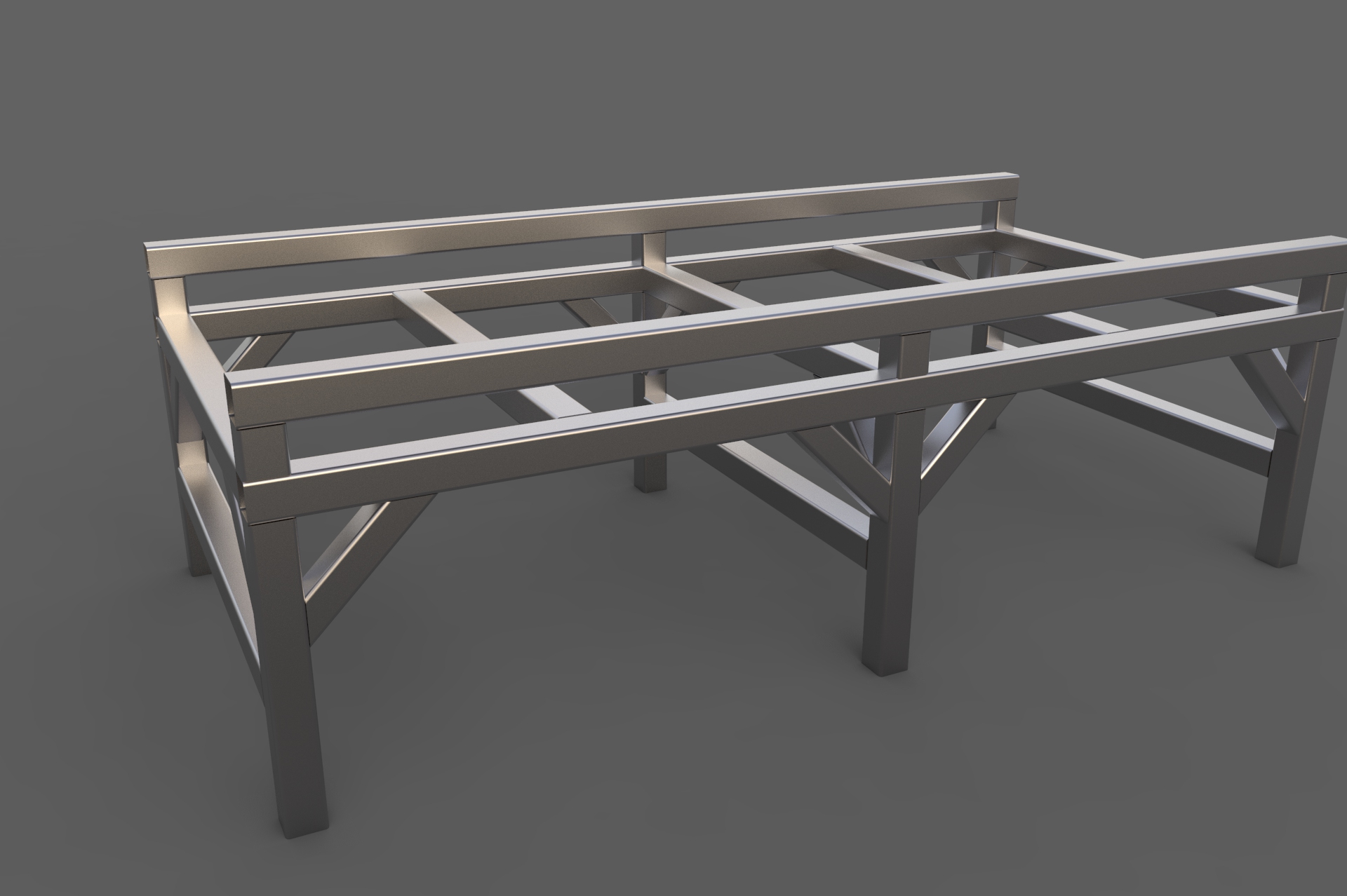

    Quote Originally Posted by reefy86 View Post
    anything wrong with this frame and is the diagonal supports ott? i will be adding adjustable feet on aswell
    cheers

    You forgot diagonals when looking in the plan view, see here what I mean; http://www.mycncuk.com/threads/6565-...2425#post52425
