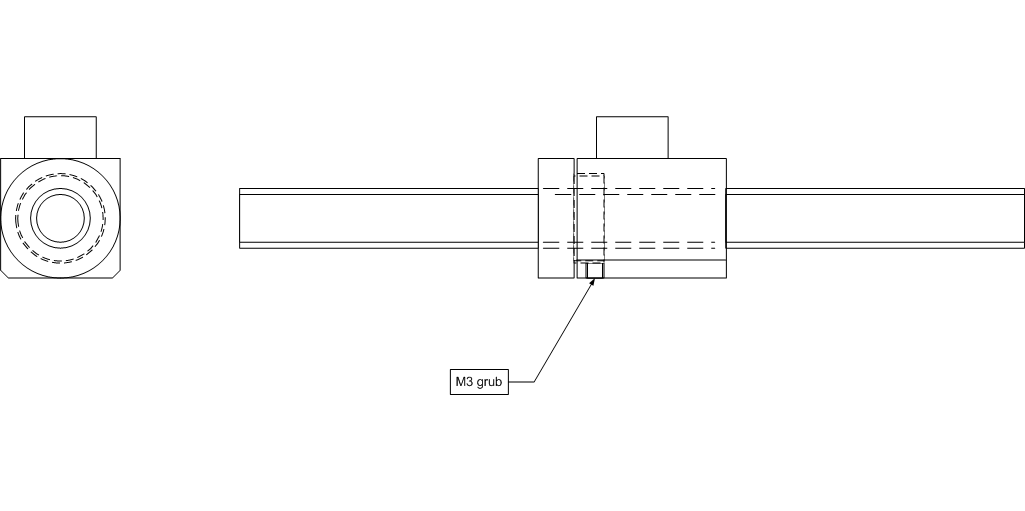

    And , if you're going to make your own nut, it'd be worth adding some kind of backlash adjustment to it (you can't adjust a tap, the way you can a split die :() .
  5. Quote Originally Posted by BillTodd View Post
    Is the compound/topslide LHT?
    If you are going to the extent of fitting new screws then adding dials is a must, surely?
    Yes they are both LH threads. And you are right, it makes sense to add the dials, its not that much more work (!)
    As regards backlash adjustment, what do you suggest? the current nut is about 20mm square so I was thinking that a 20mm cylindrical section screwed into the block and locked in place with a small grub screw. It would need to be a fine thread, maybe 20tpi. Not sure I could do that with the changewheels I have today.
    Here is a rough pic...

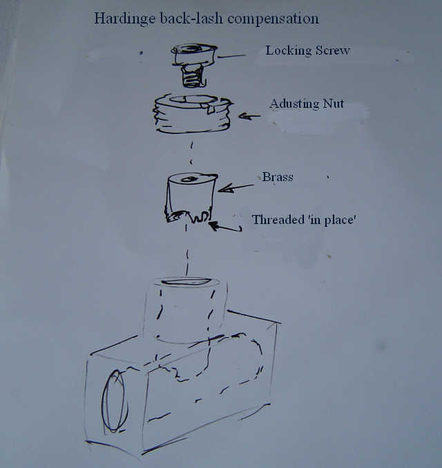

  6. As regards backlash adjustment, what do you suggest? the current nut is about 20mm square so I was thinking that a 20mm cylindrical section screwed into the block and locked in place with a small grub screw. It would need to be a fine thread, maybe 20tpi. Not sure I could do that with the changewheels I have today.
    Sounds like a good plan to me :)
    Can you get at to adjust it in place? (I can just reach the SB adjuster from the back of the crosslide)

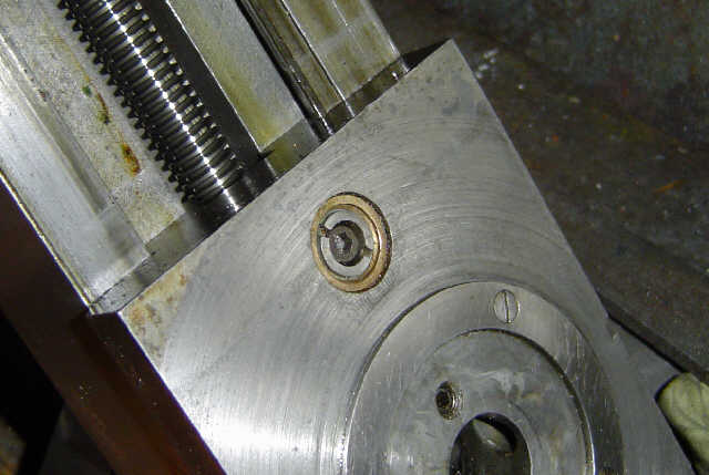

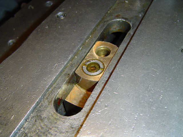

    An alternative (used on the hardinge) is a brass bar (with the end threaded in place) pressing down on the screw via the nut mounting hole (I'll add a picture later).
Name:	HLV-H backlash compensation.jpg
ID:	782   Click image for larger version.
Name:	Compound-slide compensation.jpg
ID:	783   Click image for larger version.
Name:	cross-slide compensation.jpg

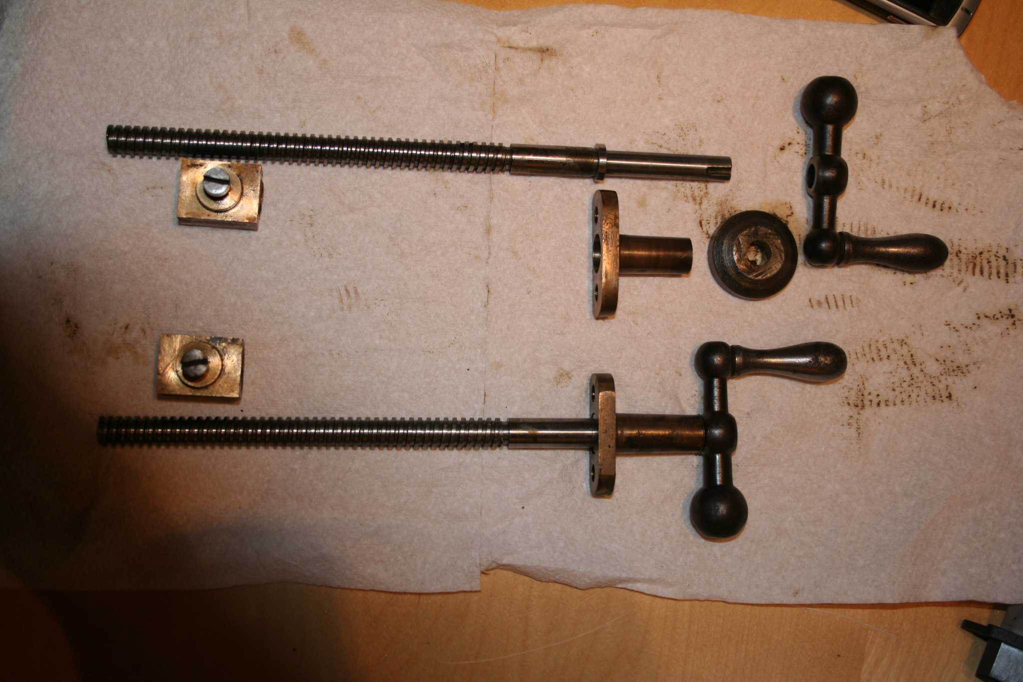

  10. Took the other leadscrew (cross-slide) off today. Its identical to the topslide one, although at some time in the past somone has lopped 7/16" off the brass bearing and inserted a (poorly machined) micrometer dial and attempted to solder a pointer (now missing) to the brass sleeve.
    I now have everything ordered I need to do this except some 7/16-10 LH leadscrew, wanted to find a UK source as the US source is 10 days shipping and was hoping to make a start this weekend. Kingston Engineering don't go down to 7/16, their smallest is 1/2 but this won't fit through the holes in the slides :sad:
    Anyone know of a UK source for 400mm or so 7/16-10 leadscrew? I wanted to go metric but although MD have 10x2D LH at 99p/100mm I cant get a 10x2D LH tap at reasonable cost unless someone has one they can lend me...
