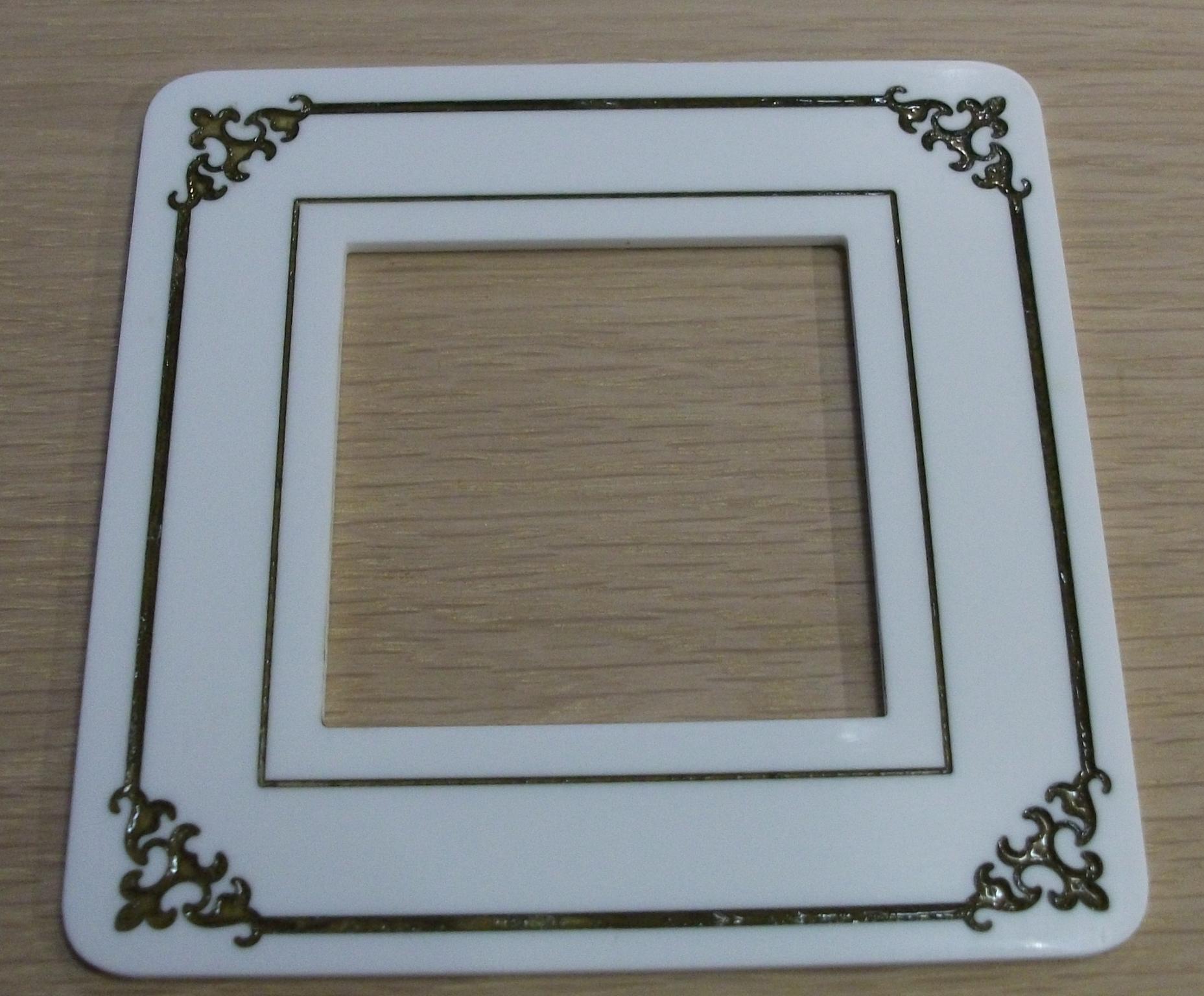

    I thought I would do a quick project, to cut a light switch surround plate out of white acrylic, with a design on it. However the thing is biting me on the bum.

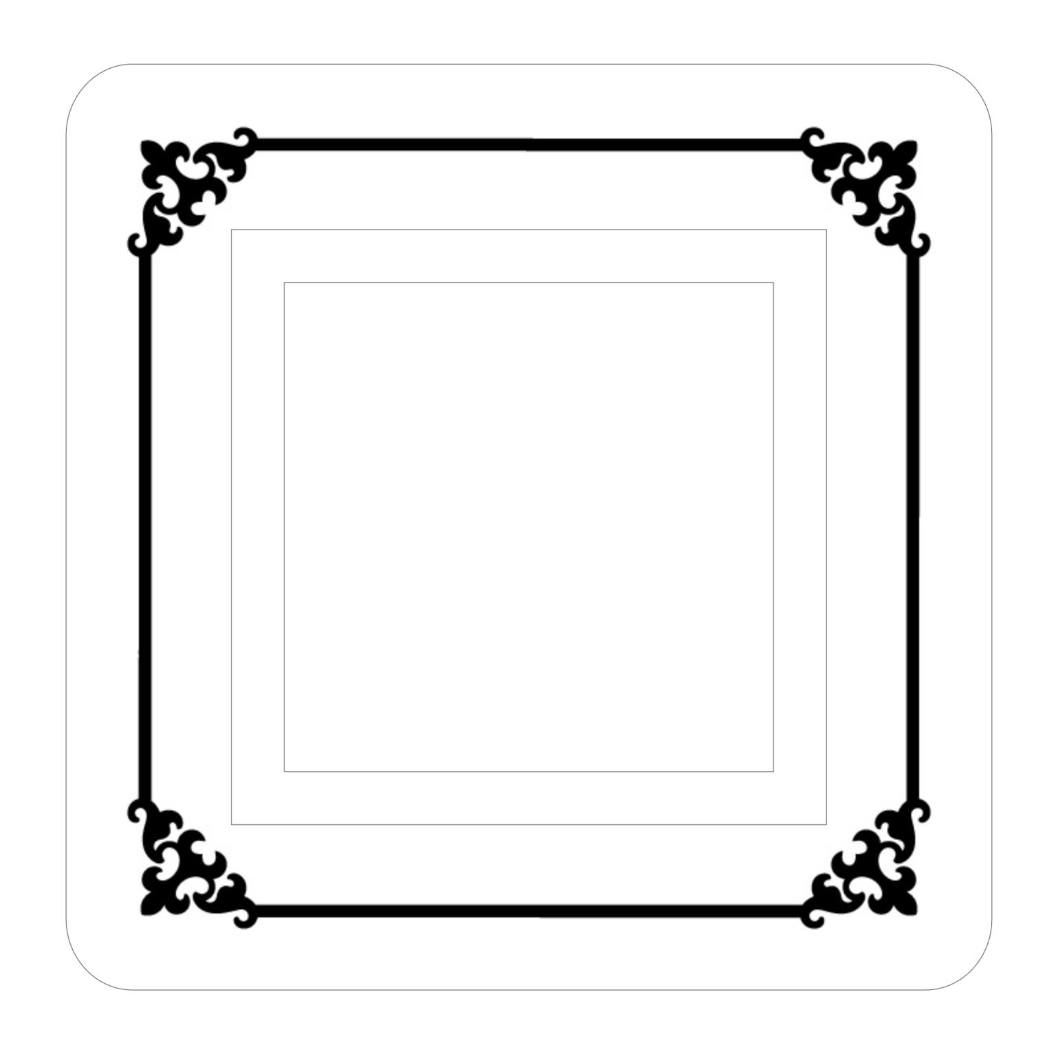

    What I cant get is the inner design, which started out as a Scan2CAD dxf file, to appear on the dxf file I load into Estlcam. Help please !!
    Here are all the files concerned The original Scan2CAD file is Frame1.dxf.

    Hi Rob,
    I downloaded your files, combined 'em and saved back out as a .dxf and a .pdf - sizes were a bit screwy - I take it you don't want a switch surround that's 1.5 metres across..? - Although it might make for a nice focal point for the room...
    Anyway, here are the files:
    https://www.dropbox.com/s/mxnewkwwev...FRAME.dxf?dl=0
    https://www.dropbox.com/s/vrx4m0jlb1...FRAME.pdf?dl=0
    Hope this helps!
    Wal.

    Thanks Wal, The decorative scroll was too small, but at least it was addressable with my software. I corrected the size and have created the Gcode. The trial cut in a bit of scrap ply has finished and it looks GOOD !
    I will set up a piece of perspex sheet and cut it out now.
    All cut out, now I need some bronze enamel to do the infills.Click image for larger version.

    Thanks again Wal, but I could do with knowing what you did exactly as I have several other designs to do the same with in the near future. I think the software I have doesn't handle these files properly as I get errors when saving them as .dwg in AutoCAD. I have also tried Inkscape with similar results.

    Rob, I use Adobe Illustrator - I just opened up your files, plonked them into one and re-saved in those two formats. I wonder if the decorative scroll vectors were that big they simply went beyond the canvas in estlcam? I've never used that software so can't offer any meaningful advice beyond that..
    Job done !
    Humbrol enamel takes an age to dry. Then I cleaned up with 1500 wet and dry and finished with 2500 to give a matt look to it.
    Now I need to put it behind the switch !
