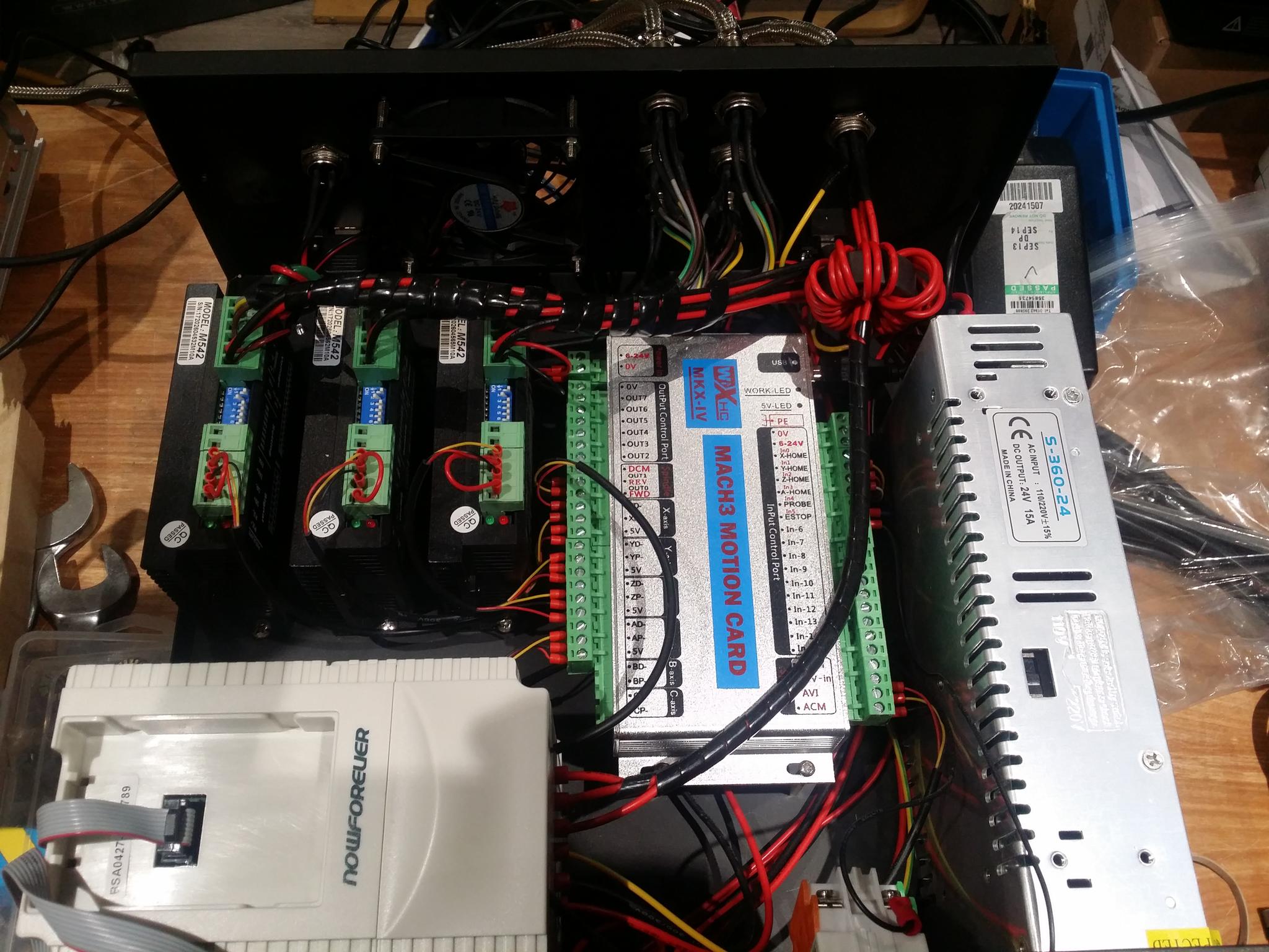

    Here is the inside of my controller box. Plenty of issues to deal with.
    NOTHING is earthed or shielded.
    The VFD should bt even be in this box and the VFD output wires are draped right over the unshielded inputs of the controller.
    Many if the power cables are undersized. Labelled as 1.5mm, but looking at them, I don't even think they are 0.75mm2.
    Plan... rewire the whole thing. Shield and ground everything. Move VFD to seperate shielded enclosure...Click image for larger version.

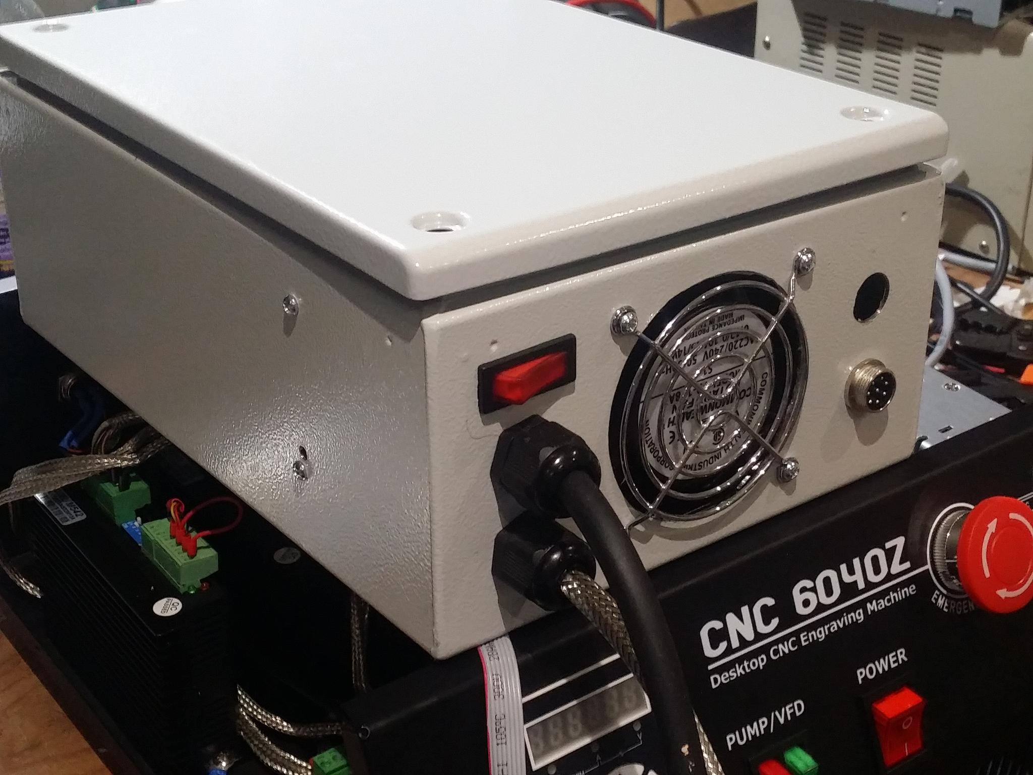

  2. #22
    That last post was from 2 days ago.
    I've rewired and shielded everything.
    Moved VFD to its own box.
    Fixed a few electrical safety issues.
    Pump switch removed. If the controllers on, cooling pump is on. Simple.
    It's all technically sound, but I think I need to go back in later and make it a bit neater.
    I also plan to replace the 24v fan with a 240v version.
    I haven't decided whether to move VFD control panel to new VFD box or leave it there. I'll think some more about it.
  3. #23
    Lives in East Lothian, United Kingdom. Last Activity: 3 Days Ago Forum Superstar, has done so much to help others, they deserve a medal. Has a total post count of 2,992. Received thanks 376 times, giving thanks to others 9 times.
    Over the top springs to mind, especially since everything was working with no problems.
    I'm sure you'll carry on with what you think is right, however I'm just posting for the benefit of anybody inexperienced who might read this and think that all this is necessary. It might reduce the chance of problems, but there are thousands of machines that run with unshielded wiring and VFDs inside control boxes, with no issues what so ever.
    And if you really were doing everything correctly, your new choke/filter for the VFD should be mounted on a sub-plate, not directly to the case ;-)

  6. #26
    It's just the photo, it's not mounted to the case, it's actually suspended in mid air. With the stiffness of the wiring looms, it's not going anywhere.
    Quote Originally Posted by PaisleyPCdoctor View Post
    I never realised the ferrite ring was still mounted in that bit of the photo. I was on about the silver box mounted to the side of the enclosure at the bottom of the photo. Technically any power components shouldn't be directly mounted to the case, they should be mounted on a sub-plate.
    As there's a ferrite ring, I wouldn't bother shielding any of the power cabling in the case. Ferrites are very effective at stopping the noise that can potentially cause problems. I would however use good quality shielded and twisted pair wiring for the VFD speed control wiring, as noise on that can cause spindle speed instability. The control wiring less so. It will all be 12 or 24V, and it would take a lot of interference to cause any problems there.
  9. #29
    Good advice. Thanks. The control wires are all double shielded. The silver box you mentioned is an EMI filter for the mains inlet, but you are right, it should be on a sub board. Its earthed and so is the casing. I'm gonna leave it for now. Next time I rejig the innards, I'll move it.
