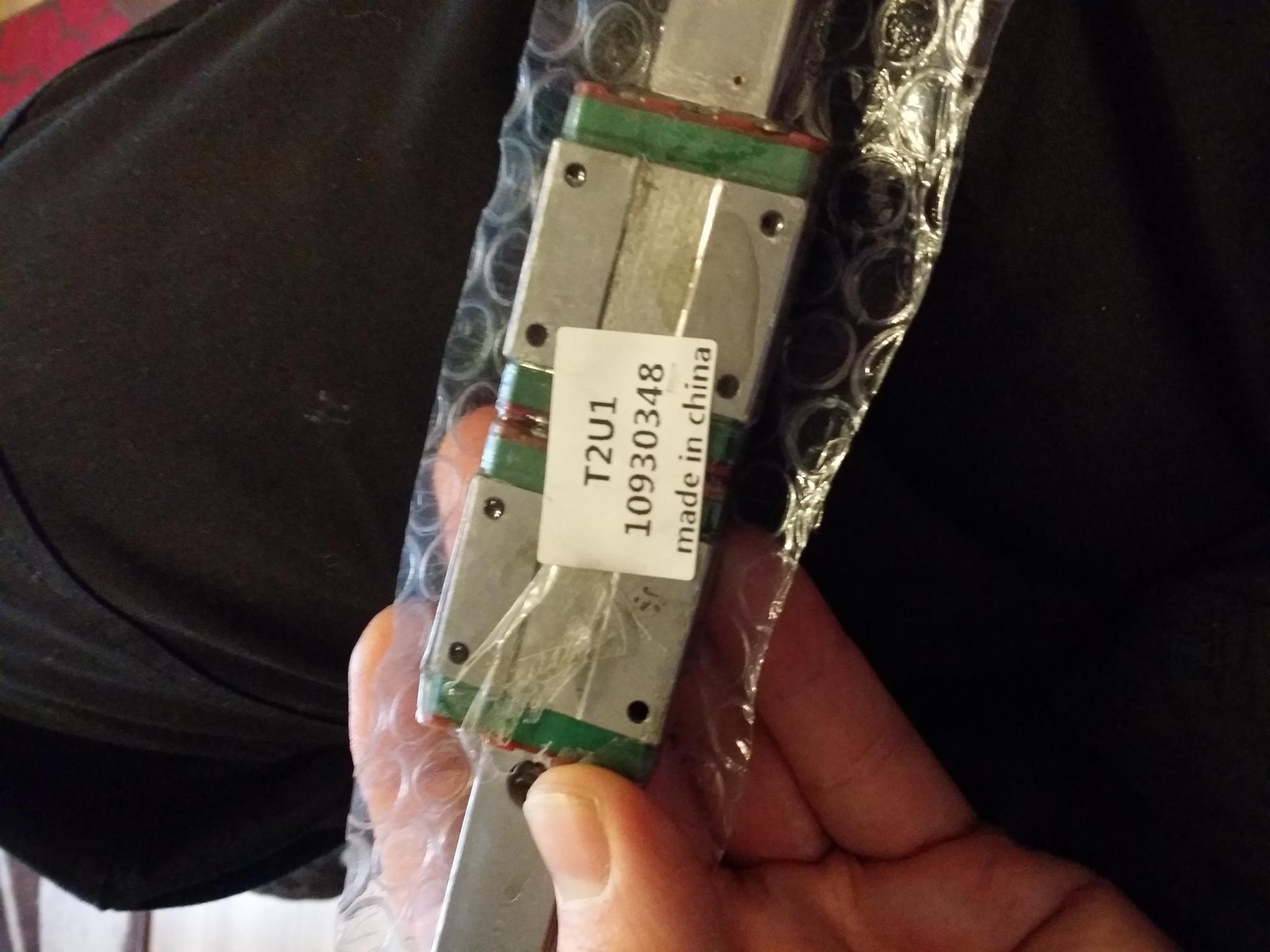

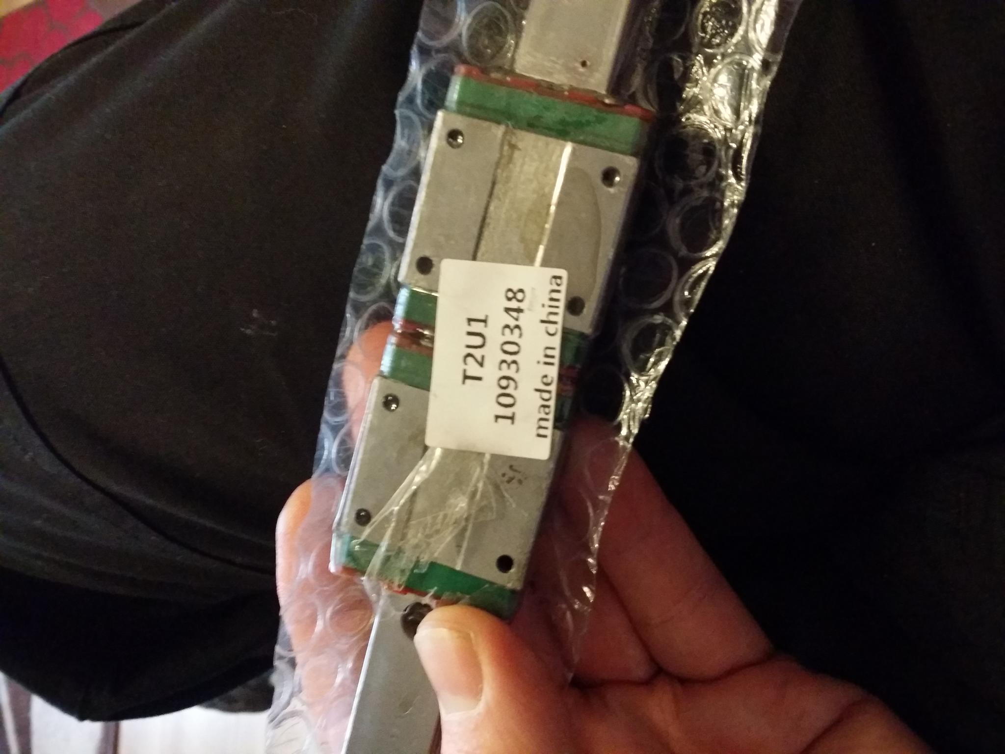

    I recieved my 500mm long, 15mm hiwin clone guide rail and carriages today. Sure singly quick.
    Looks good, except these have M3 holed on the carriages (2x20mm spacing).
    Suppose it will be all right as I'll end up with 2 of these rails in addition to my 2x20mm round rails. I'm sure the M3 threads will take the punishment.

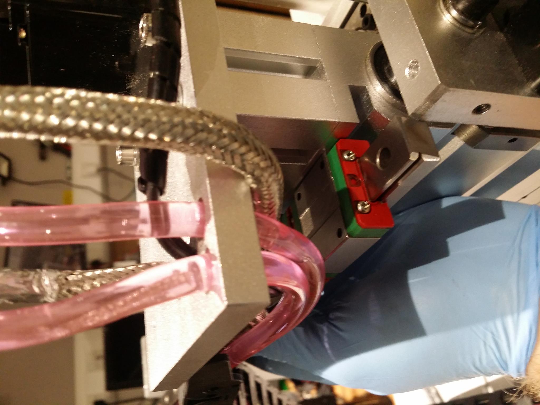

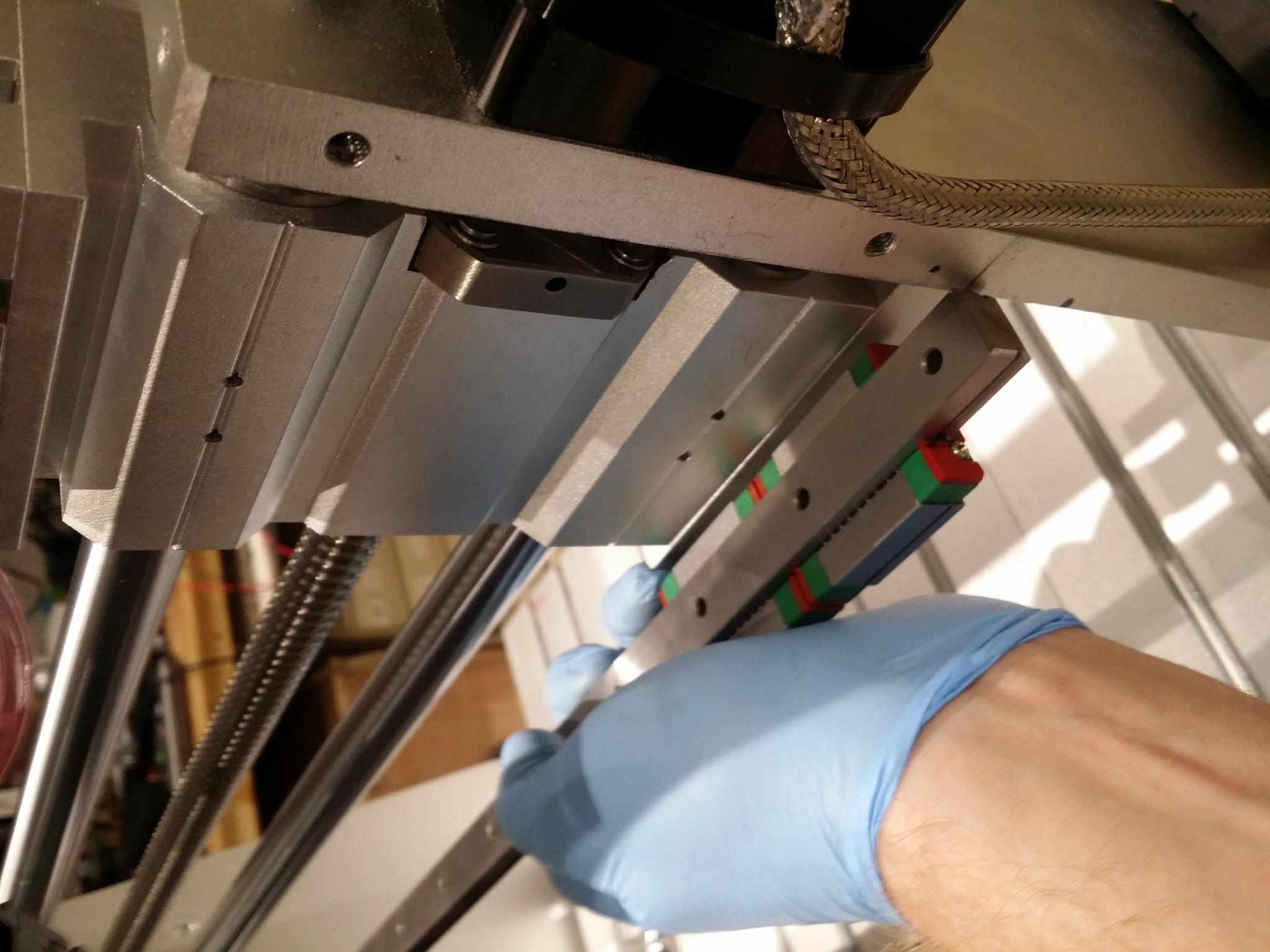

    I've figured out how to add the 15mm square rails.
    New backplate, 20-25mm thick aluminium, 100mm high. 2020 extrusion bolted to top and bottom edge. Square guides bolted to extrusions. Mounting plate coming out from under existing x axis bearing assembly for bottom rail.
    Square block on top of top carriage to mount into handy t-slot in the spacer above existing bearings.
    2 carriages top and 2 carriages bottom.

    Don't take the carriages off the rail EVER! Bearings can and do come out those carriages so the best thing you can do is put a bolt in either end for now so they're captive.
    I think you have low profile rail which is why it's M3 not M4, it's still plenty strong and a superior solution to the round rail by a million times lol.
    That's crazy quick delivery, how much did you pay? if it's not too rude a question.

    15mm x500mm square rails with 2x carriages was £37 off eBay. They were posted from uk but still surprisingly quick for Christmas time.
    I ordered a second today, it'll arrive before I have time to build anything anyway.
