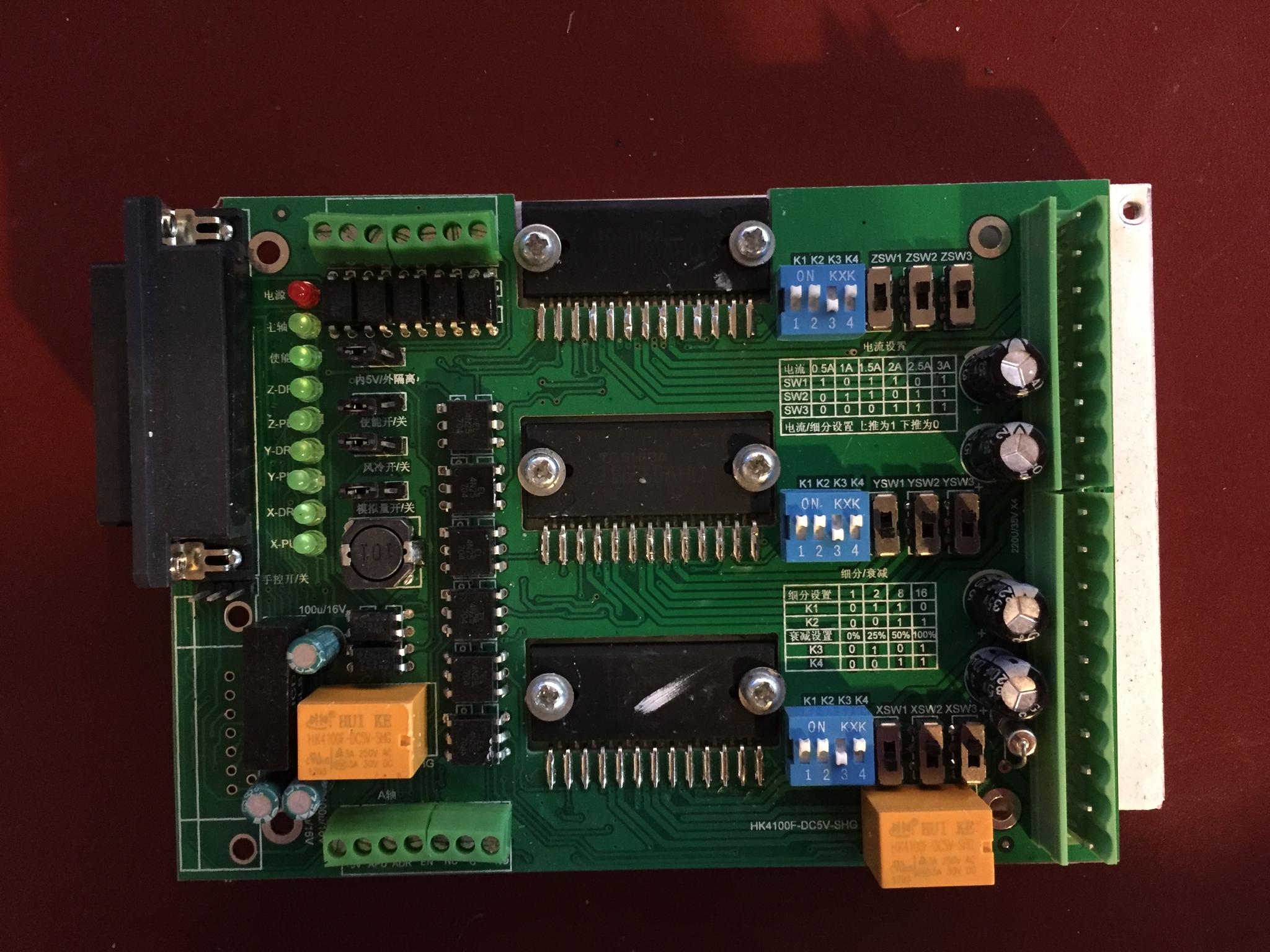

    I brought a fairly inexpensive 6040 from Ebay - Germany (China seller) and although happy with the basic machine I have been trying to get PWM spindle control and direction to work. I also want to add some limit switches. The trouble is i'm really struggling to work out if I can connect to this board and if so what port / pins to use in Mach3
    I managed to get one relay to fire using Port 1 pin 7 just through trial and error, but cannot get any change in voltage through the pin labelled 0-10v it's just stuck at 9.9v.
    Can anyone identify this board or have you used one previously? I would like to keep using it if I can as it seems to have all needed. So just before I look at changing the control board and adding Motor controllers I thought I would ask around and see if anyone knows the board.

    At some point you will have an issue with one axis or another, you could save a lot of grief and make fault diagnosis far simpler by buying separate break-out board (with spindle control options) and axis controllers.
    I started with a 5-axis integrated BOB/controller and never got one with all 5 axes working properly, after a refund I remembered why I like seperates for HiFi - one bad unit doesn't scrap your whole system, you can swap-out to locate a fault and if something is really important you can keep a spare and use it without messing with the bits which work.

    I think I found the control board specs looks like it is a JP-3163B or variation of this. Looks the same.
    Last night I rewired the inside of the control box to add plugs for Limit switches and Spindle direction / speed. I think I have found some documentation showing where to connect and it looks like I have to mess with some jumpers as well, so hopefully I'm making progress.

    This is "throw it in the bin" board. Do yourself a favor and buy a proper supported one. That's the reality of it.
