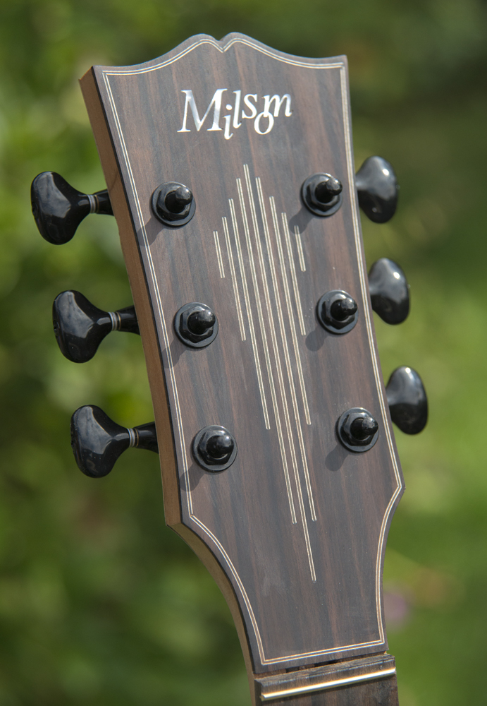

    Well Wal, I've been playing around with the WorkBee for a while now here's one of the latest headstock inlays I've done...
    The MOP inlay was cut with 0.5 and 0.3mm end mills, the wood inlays 1.3mm end mill. Feeds @ 20k rpm for the inlay circa 1.5 mm/sec with 0.3mm depth of cut. The wood inlay pockets were cut circa 5mm / sec 1.2mm depth. I remembered you saying about super gluing your MOP to an ali sheet and soak in boiling water to release the parts. I ended up super gluing to thin MDF and soaking in boiling water. The MDF just swells up and flakes away.

    Francis - that's an awesome looking headstock - that WorkBee is certainly doing the business for you! Good call on the MDF - I take it that you don't get any issues with fibres sticking to the back of the inlay pieces?

    Thanks Wal - no any fibres that do stick a light rub on fine wet-n-dry removes them - I use APT as well for my cutters - very prompt service.

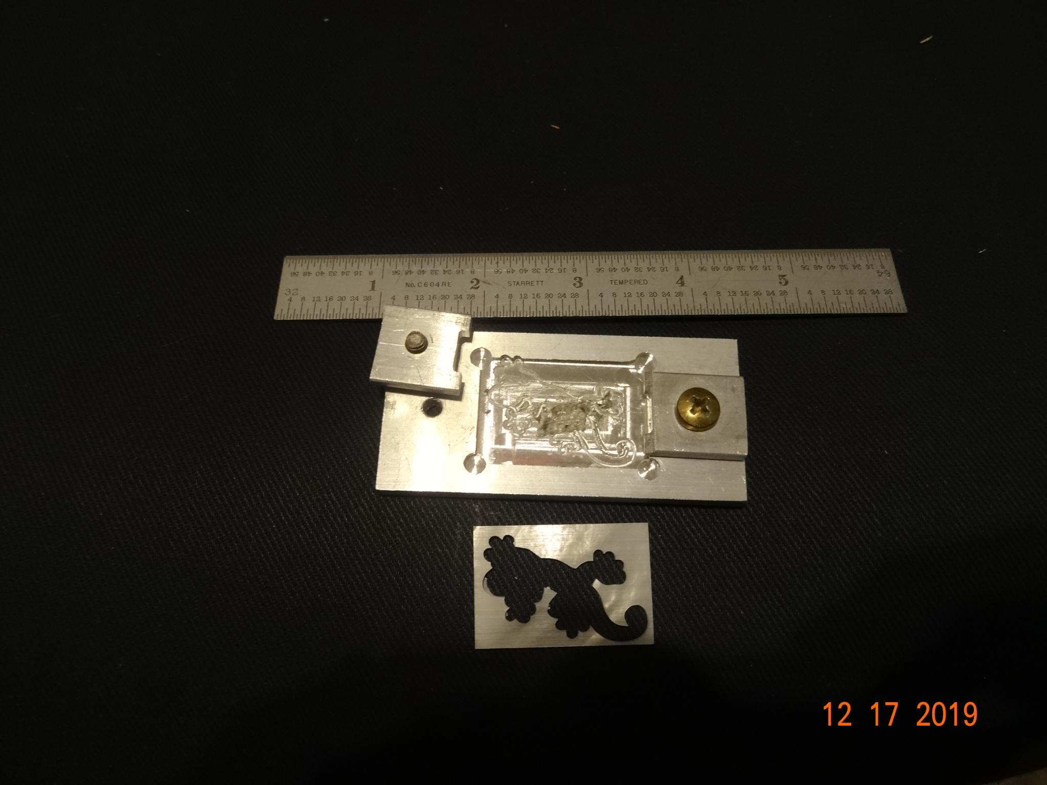

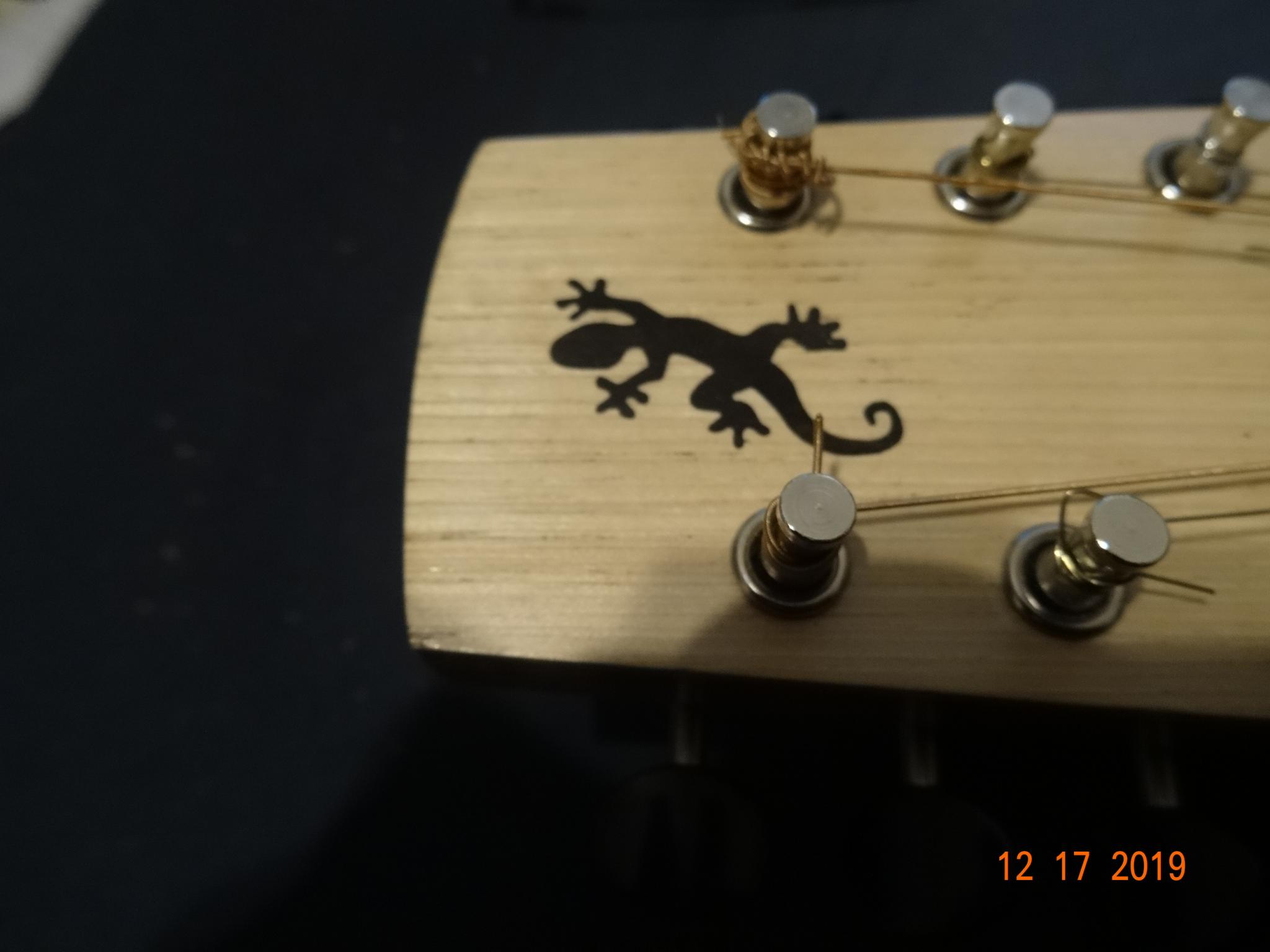

    I've done a bit of MOP machining as well, also for guitar inlays. Your technique of gluing the blanks to a plate for machining sounds excellent. I made a small fixture from aluminum to hold a 1" x 1.5" MOP blank. as shown in the photo. I cut out a lizard figure, and cut the corresponding pocket to inlay it into. There is a photo of a finished inlay, although this one happens to be cut from African blackwood, not MOP;
