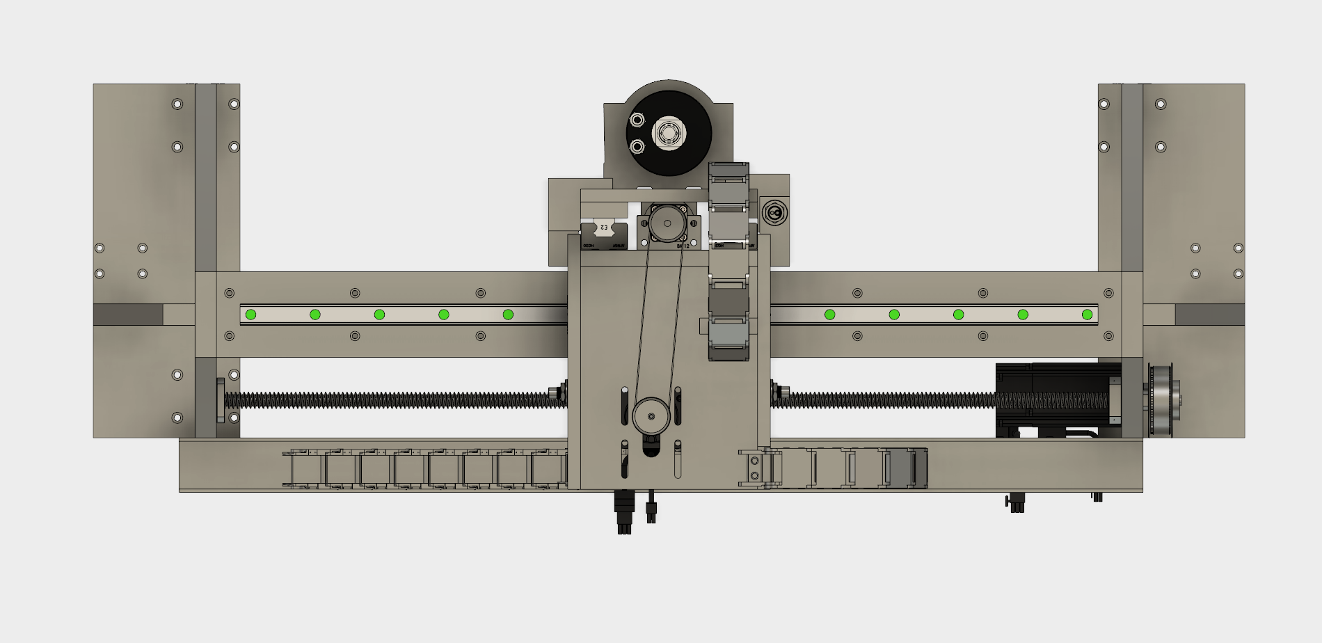

Hi, everyone, hope you haven't had too much trouble in the snow. I've got some more work done on the router, the gantry end plates, X axis carriage plates and reinforcement plates. I haven't quite finished the motor mount in the gantry end plate, but I wanted to get the bits assembled to see if the Y axis ballscrew that I got fitted, and much to my relief it did. I've just started to mount the channel which will support the Y axis drag chain.

Just a small update to follow on from the last one, I got a pair of small supports made to fix the Y axis drag chain support channel to the back of the gantry end plates.

Thanks, it's not going too badly. I want the machine to look good, hence countersinking all the cap head bolts, tucking away the motors and not having them stick out and rounding and slope cutting bit like the gantry end plates. It probably won't add any to the performance of the machine but it should look good and sleek.

Thanks for the compliments, I have done quite a bit woodworking in the past. I've never however done any metalwork with the accuracy needed to build a CNC machine. I took a while to learn the basics of Fusion 360 and model the design and this has helped a lot with visualising the design. You can also isolate individual parts so it's easy to layout, check and make the parts.
