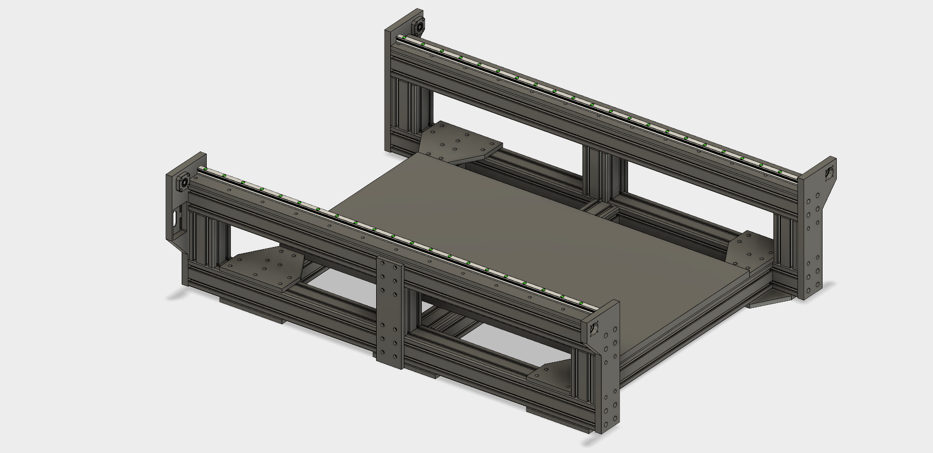

    Following on from the previous post I've made 4 similar braces for the sides of the router frame and some simple plates to bolt them in. All of the main frame is now just about complete and can be bolted together in the garage in its final position.

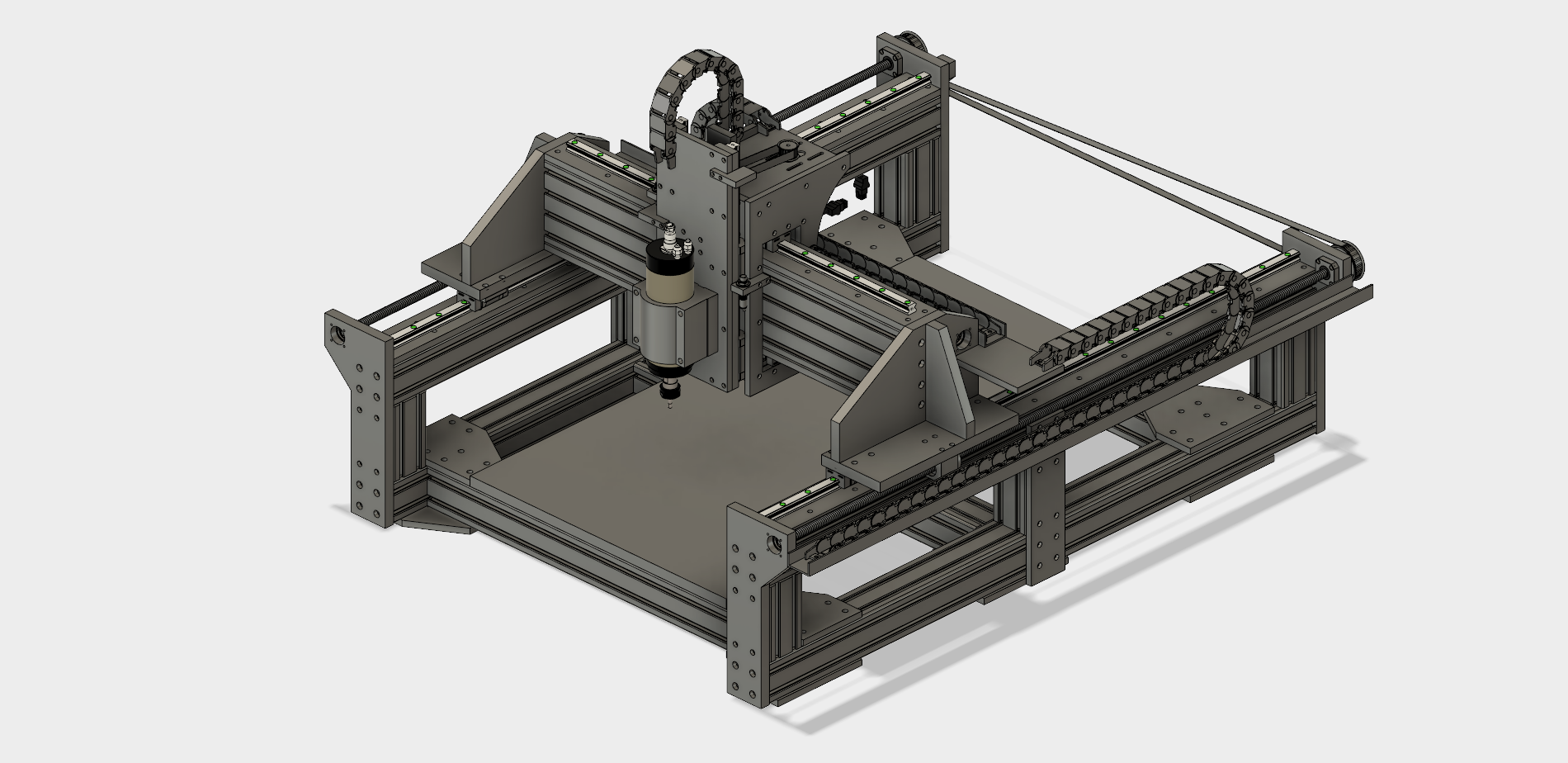

    First let me congratulate on an amazing build. Its amazing what many do with aluminium, basic hand tools and a little patience. I started designing a build (was all steel) but after spending a few hours with Clive its back to the drawing board for some re-jigging about. I thought I would need a mill to turn out the stuff many have done, but you have shown that's not the case, well done.
    I was trying to work out some measurements from your design - is the gantry 90 x 45 heavy - and did you do an L shape pattern ? I think that's what quite a few have done - Heavy-Aluminium-Profile
    I see you have put aluminium on the top of the x and y axis - is that 20mm cast aluminium?
    Many thanks - and sorry for all the questions - I am just learning.
