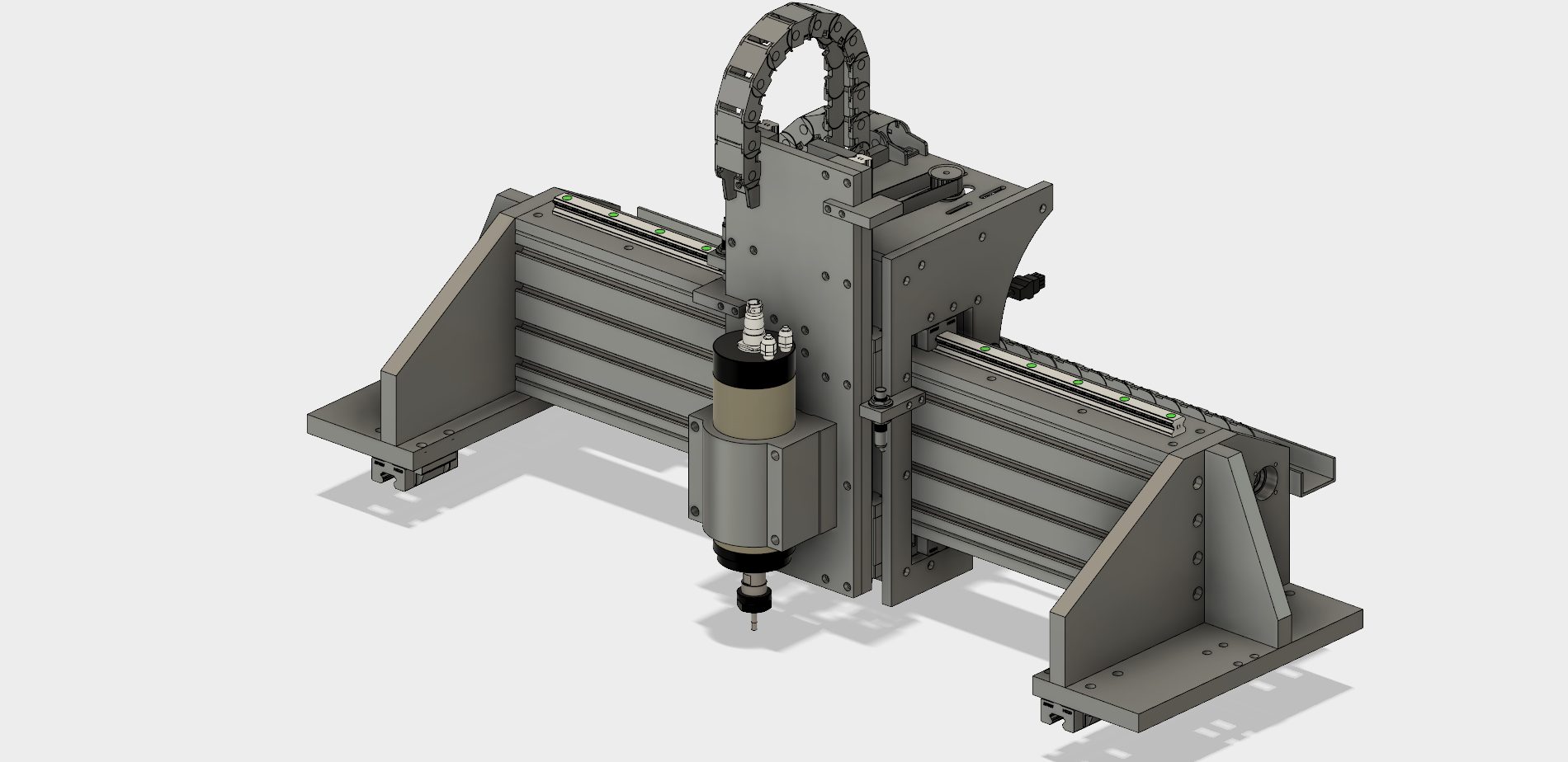

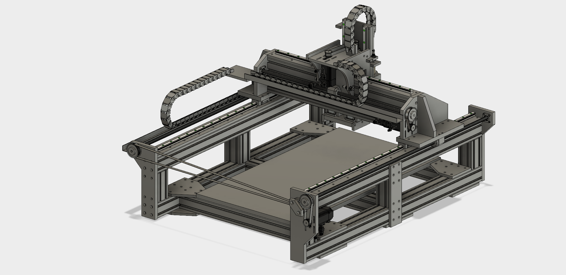

    I've designed a router based on aluminium extrusion and would like to see if the experts on the forums have any advice or can point any silly errors that I've made.
    The cutting area is roughly 600*1000 and it will mainly be used for hardwood cutting although it would be useful if I could do some aluminium as well. I've gone for a Z travel of 180mm as I would like to add a 4th rotary axis at a later date, but I'm not sure if that would adversely affect how it cuts aluminium.
    I'm going to use Hiwin 20mm rails and carriages, with a 1605 ballscrew on the Z and 1610 on the Y and X axes. I was going to get the ballscrews from BST Automation and was wondering if anybody had used the 400W 60ST-M01330 servo motors that he sells, and if that is powerful enough to drive the X Axis.
    I've designed it so there is about 40mm of spindle travel beyond the front of the bed, so I can cut the ends of larger items.
    As for electronics, at this point I would love to use one of the CSMIO controllers.

    Not used those servos but the design is looking good and will run great with steppers
