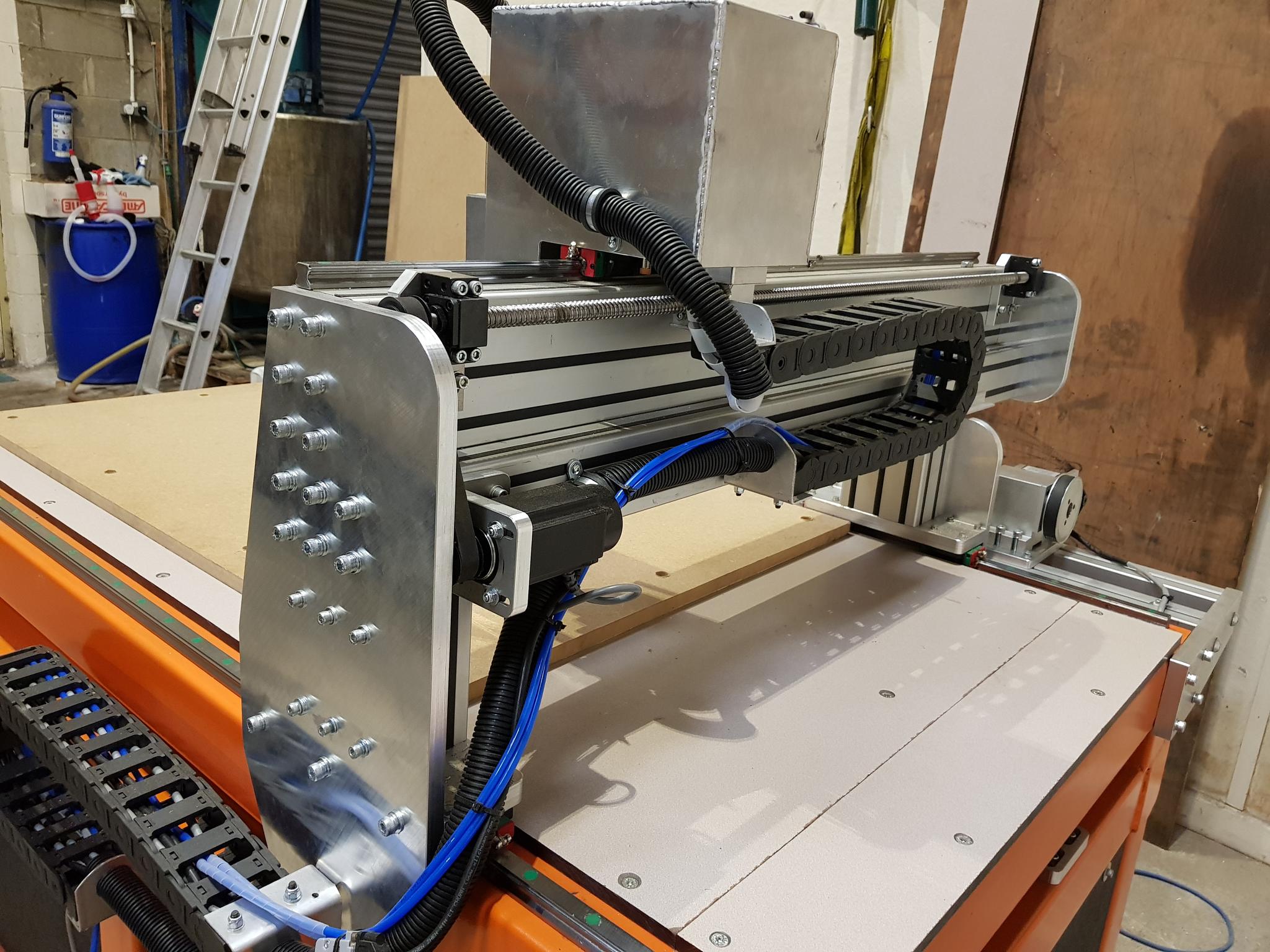

    Hi, thanks for the compliment, I'm quite surprised at how well the build is going myself. I have discovered however that the aluminium cuts a lot like high density hardwoods such as english oak, african blackwood or leadwood, although things need to be well clamped as the aluminium is a bit grabby. In others way it is easier as with a bit of cutting oil you can get really good cuts and keep the cutter cooler than when cutting the hardwoods. I cut a 35mm diameter by 12mm deep hole in one of the gantry end plates for the FF12 ballscrew support just with a standard forstner bit. With the addition of the cutting oil the bit never got very hot and when I had finished it was cool enough that I could hold it, definitely not the case when cutting the denser hardwoods with the same forstner bit.
    In other ways it is easier as with a bit of cutting oil you can get really good cuts and keep the cutter cooler than when cutting the hardwoods.

    I forgot to add that when I used the forstner bits I had to drill a pilot hole through the aluminium as the centre part of the forstner bit won't cut the aluminium. For example I used a 4mm drill for a 36mm forstner bit which also acted as a good guide to get the bit started. Anyhow I got the hole drilled out for the FK12 bearing and test fitted it.

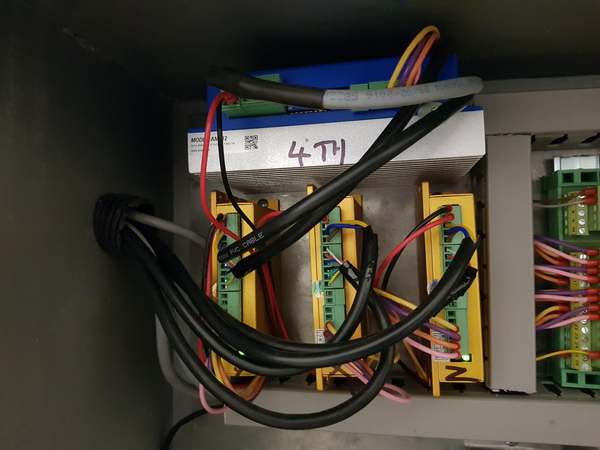

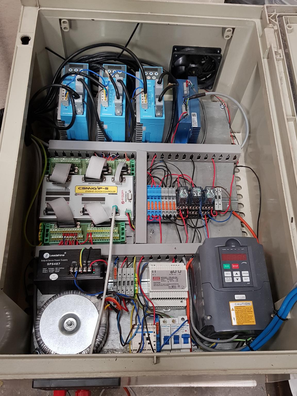

    No 3Nm won't be enough for 2 screws but would if had motor on each screw. Single motor you'll need 6 or 8nm nema 34.
    I've used these on couple of bigger machines, nice drives and motors and never had any issues.
    https://www.aliexpress.com/store/pro...3f34a881y5B3hn
    Yes ATC = Auto tool changer.

    Hi Jazz, that Lichuan drive does look very nice, if I go down the nema 34 route instead of twin motors on the X axis. For the nema 24 motors I was looking at the Leadshine CS-D508 drive which appears to be very similar to the Lichuan LCD375H drive or maybe the Leadshine ES-D808 which I think is similar to the Lichaun LCDA808H that you used. On a side note I wouldn't mind supporting UK companies like Zapp but the price difference is huge. From Aliexpress I could get 4 ES-D808 drives and 4 ES-M22430 motors for under £600 and from Zapp the same price is nearly £1200! Even if you get charged £100 from customs this is a no brainer to buy from China. Even a CSMIO IP-S is roughly £150 cheaper if you buy it directly from CS Labs, and there is no customs charge as it's from the EU. I've got another small question, how much distance does the motor shaft have to go into the HTD pulley. If I used 15mm belts and pulleys which are approximately 25 to 30mm wide, if I loose 3mm to the mount would there still be enough shaft length to securely hold the pulley?
  12. #20
    Quote Originally Posted by NFryer View Post
    I've also used the LCD375H and they are ok as well but let down by only being 50V which means running around 44V which ideally more would be better.
    Carefull here because in Poland you'll pay I think it's 23% Vat on top of web price shown then think it's about £36 carriage so difference might not be that big. Gary doesn't charge shippping over £250.
