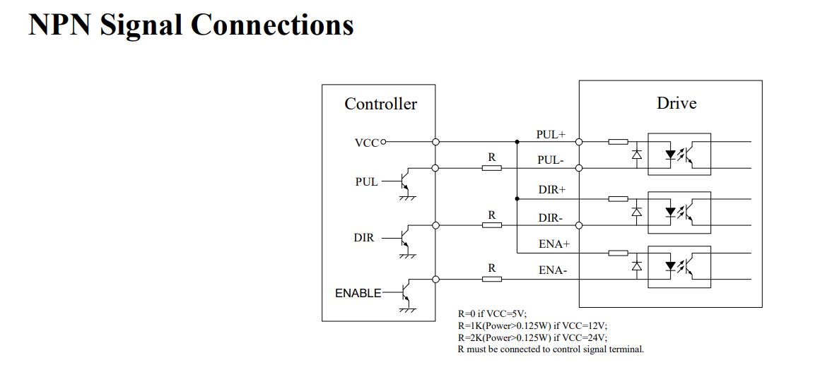

    Managed to reprogram one of the drives last night (its a faff now they're in the cab) to be Enable Active low, and instantly was able to get my first self-powered movements on that axis (huzzah!! - I'll post a video once I have all three axis working and this enable issue resolved, because as usual the garage is a tip).
    I didn't change the enable wiring, and noticed that the drive was enabled whatever happened (one of the other unconnected drives faulted out which dropped the OSSD output, but it had no effect on the active low drive). Therefore, the problem isn't that I've got my logic states messed up, or at least that's not exclusively the problem.
    My next step is to try experimenting with wiring setups to try and get the enable functioning. First I'm going to try Vsarak's two suggestions above, first utilising the 5V rail and another output (schematic B), and second, using a differential connection from a spare axis output (schematic A).
    The third step would be to try the NPN connection recommendation in the EM806 manual (which I now realise is effectively what I've been trying to do). The only difference here is that the resistors are placed on the ENABLE - line rather than the ENABLE + line - would that really make a big difference? See attached.

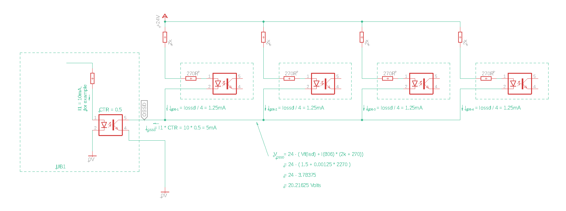

    I'm trying not to mis-direct this thread (tangent?, what tangent...), but to explain my logic....
    If I redraw your schematic (lesson #1, "Eagle" is not good for this)
Name:	Screenshot 2020-02-04 at 20.07.06.png
    and zoom into a bit of text that I torturously added
Name:	Screenshot 2020-02-04 at 20.07.39.png
    If you /assume/ that the opto-isolator on the UB1 OSSD output has a forward current through the LED (I1) of 10mA (not unreasonable, and likely a design goal). Also, /assume/ the CTR is 0.5 for that device. That means that the switching current (Iossd) would be I1 * CTR = 5mA.
    Now, Kirchoff's law says basically that the sum of the currents at a node equals zero. So, if 5mA is flowing into the OSSD input, then the sum of currents through the 4 separate '806 drivers must also equal 5mA. Give them the benefit of the doubt and say that all '806's are created equal, then your forward current through each '806 LED is that 5mA, divided equally by 4, or 1.25mA. Not the 10mA that you believe you have. Then you're at the mercy of the circuit design in the '806 behind the internal opto-isolator. That 1.25mA is multiplied by the local CTR and further diminished. Also, the CTR is impacted by the forward current - it's less at 1.25mA than if driven by 10mA, and so the internal switched voltage swing is further diminished, and may, or may not impact on the performance of the ENA input.
    The bit of maths around Vossd is easily verified by yourself - measure the voltage, wrt ground, at the OSSD output when you have a fault condition. If the OSSD output was an ideal switch you'd expect it to be 0V. I expect it to be rather higher (calculated around 20V), based on the less-than-ideal switching behaviour of the opto-isolator (and if I have to correct my auto-correct for opto/onto once more....).
    I'm cautious of playing too much behind a calculator - measure the voltage yourself. Reality beats theory any day. The one thing that worries me about my theory is that I would expect the behaviour to be accurately described in the owner's manual of the UB1. And the manual doesn't describe my perceived behaviour - so I could be wrong here.
    I've tried to look online for a high-res image of the UB1 for information on the opto-isolator chosen - to no avail. If you can check and advise? It could be an intelligent selection of a device with an unusually high CTR. Pretty sure they are not buffered devices as they look to be 4-pin devices.
    EDIT:
    Here's an idea. Short the OSSD output to ground (or just the wire from the OSSD output). Either that will work as expected (inhibit each driver) or not. That's a quick way to fault-find the circuit.

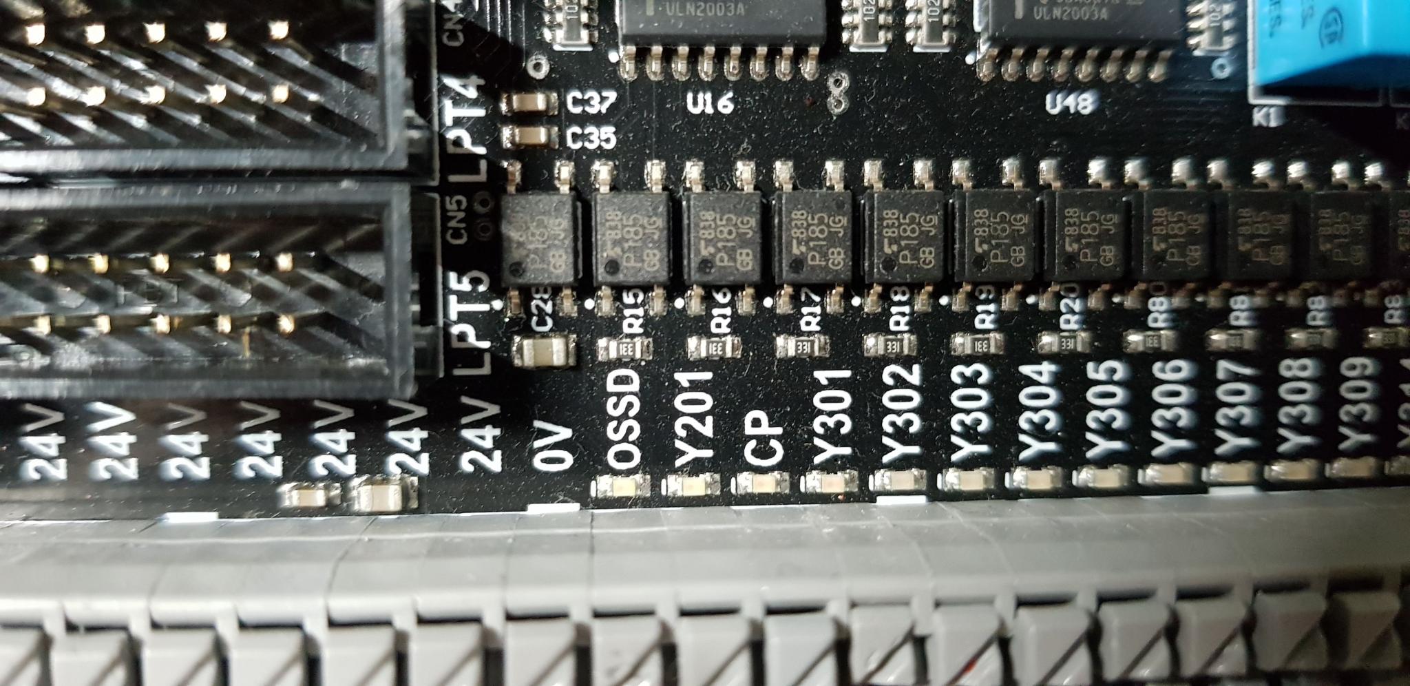

    Wow thanks for that Doddy, I see what you mean now :)
    What I think are the optoisolators (4pin IC directly above each output) have 838 written in small font above a larger central "P185". Bottom row is "GB JG".
    Also, how the hell did that board get so dusty?
    Measured the voltage but wrt 24V not ground (oops). Withe all drives on and connected, OSSD output off (i.e. fault condition drive should be disabled) I get 0V reading (so the OSSD pin is at 24V). With the OSSD output on (drives should enable) I get a reading of 23.3V (so OSSD pin is at 0.7V).
    Connected a single drive to 5V and the OSSD pin without resistors, worked perfectly. Enabled and disabled the drive like a champ exactly as expected in both active low enable mode and active high enable mode (enabled in opposite situations obviously). Will try connecting all drives simultaneously next, and I guess worst case will just run them through a spare relay operated by the OSSD pin?

    Likely a TLP185 or equivalent. CTR = 100-400%. Your measured voltage is fine and indicates the behaviour should be as you expected. Disregard all my random ramblings about optos.
