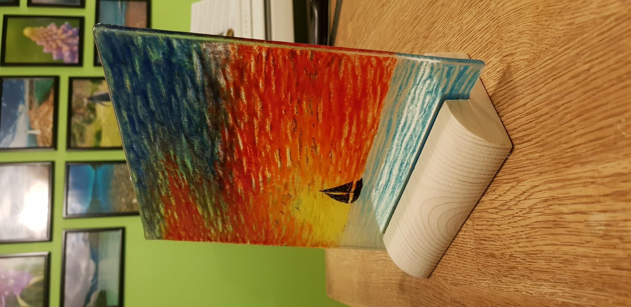

    The wife is happy! The CNC has produced something for her glass!
    Psstt... don't tell her that it would have probably been quicker on the table saw.....

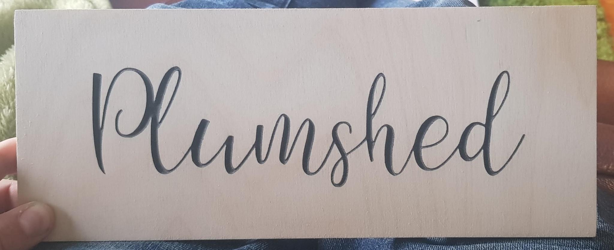

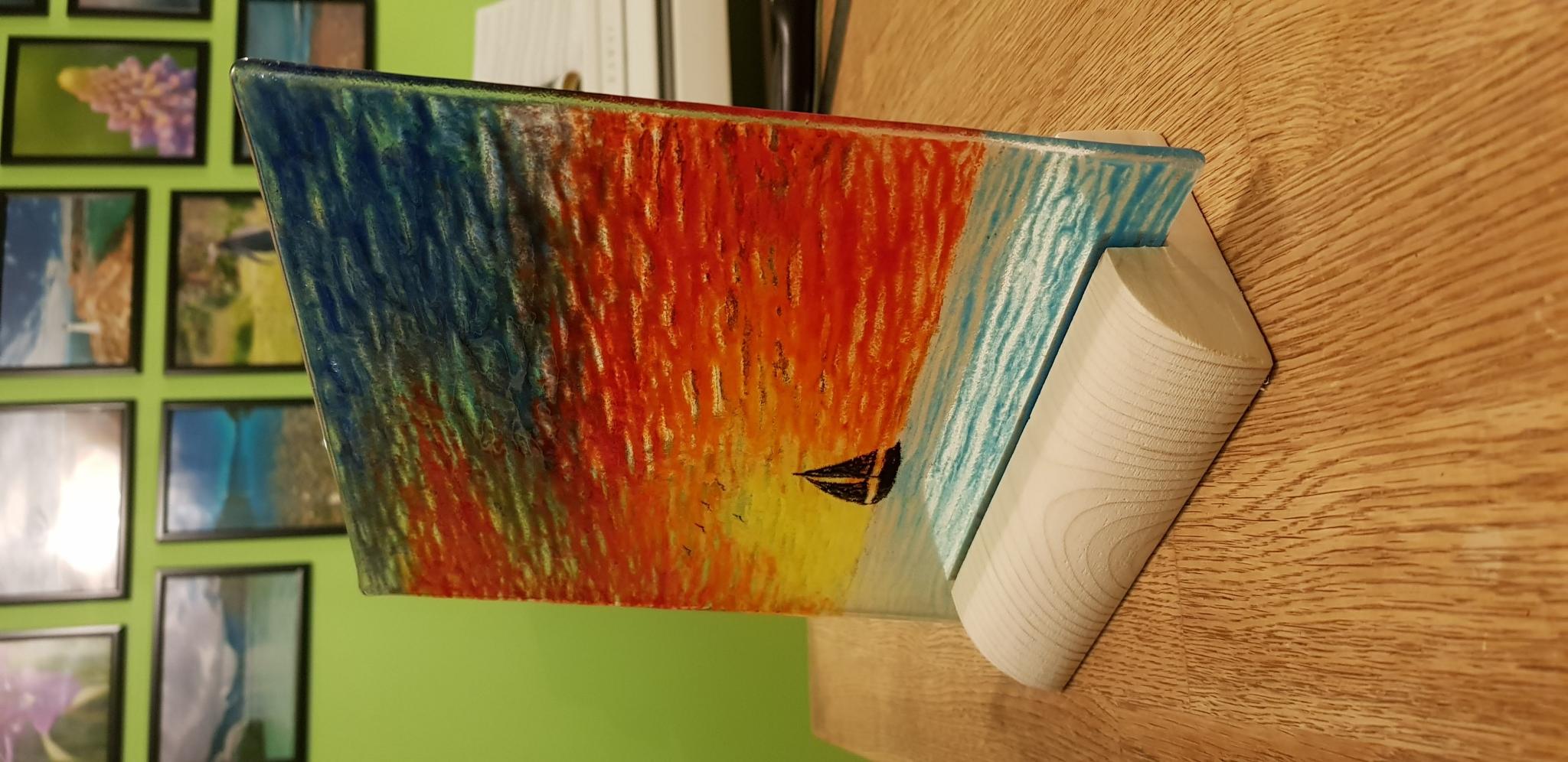

    Anyhow, very valuable day of learning. First cut was a V carve little sign. Very simple CAD and CAM in Vectric. Second cut was trying to get more serious making the above model, mostly to test the pathway through fusion. Unfortunately I didn't home the machine first, and the bastard had G28s hidden throughout... goodbye 4mm endmill and a few VFD fuses!! The item you see above is my 3rd ever cut with a little sanding. This is going to be a steep learning curve.....
    Nice one Andy - good to see actual cutting and know it's possible to get there in the end! Although if its a steep learning curve for you it'll be a mountain for me:)

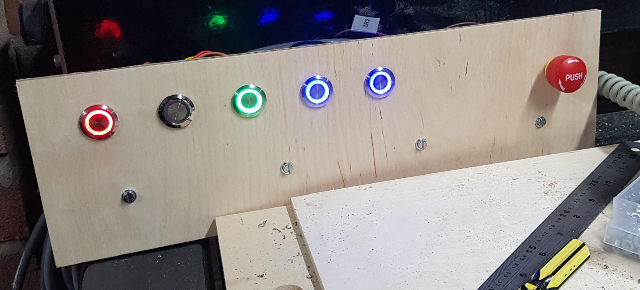

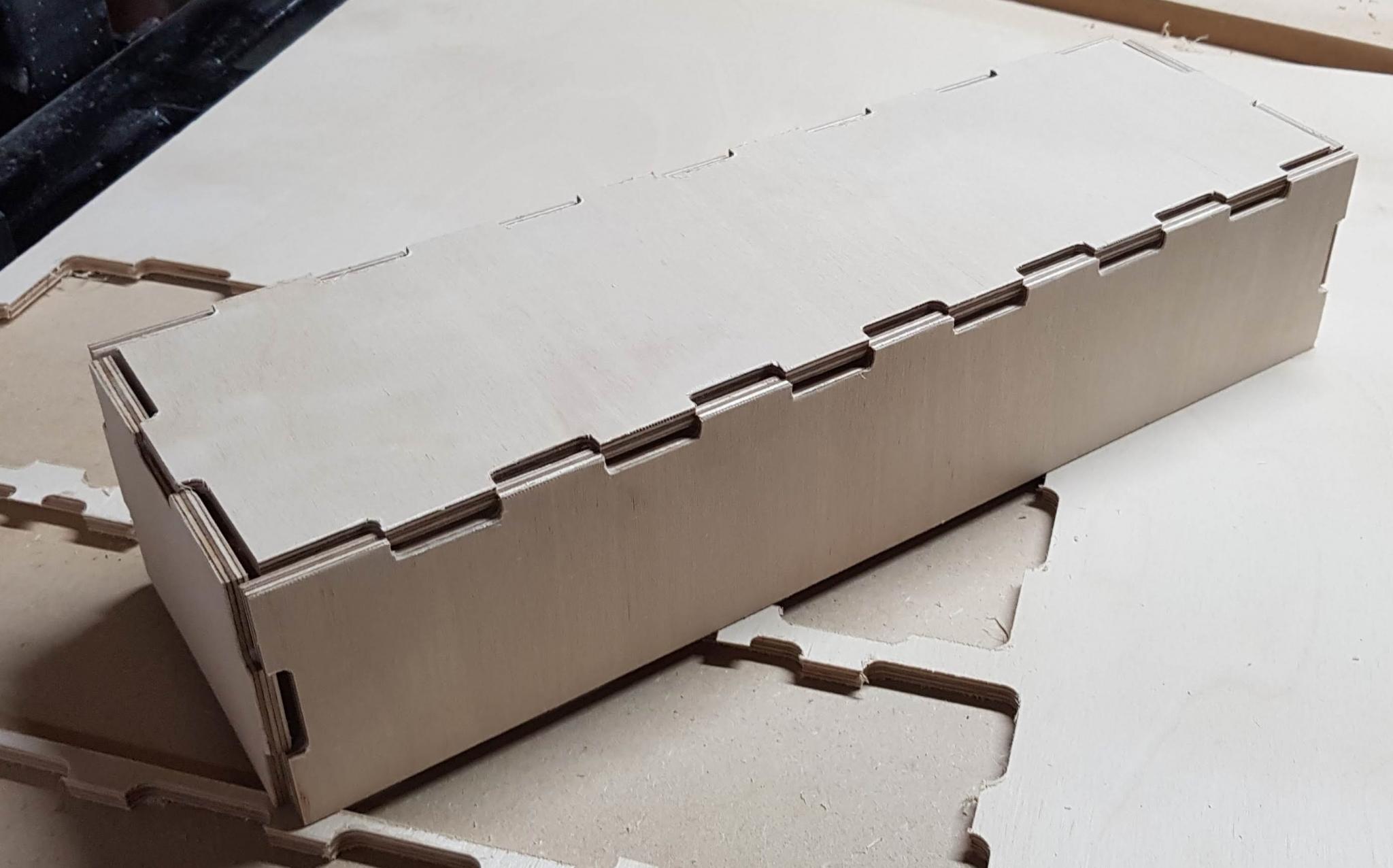

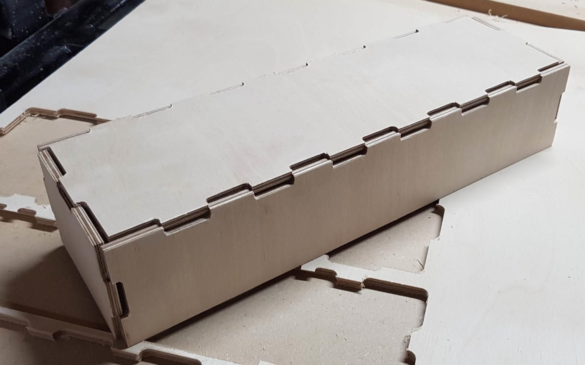

    First thing was to make a quick and temporary control box - the random DIN rail with buttons hanging off was getting a little haphazard. Found an online CAD generator for the tabbed box of whatever size. I had to manually sharpen up those corners though, so it all got a bit rough! I tried using a compression bit, but hadn't got the first pass deep enough, hence the furry edges.
ID:	27824 Click image for larger version.

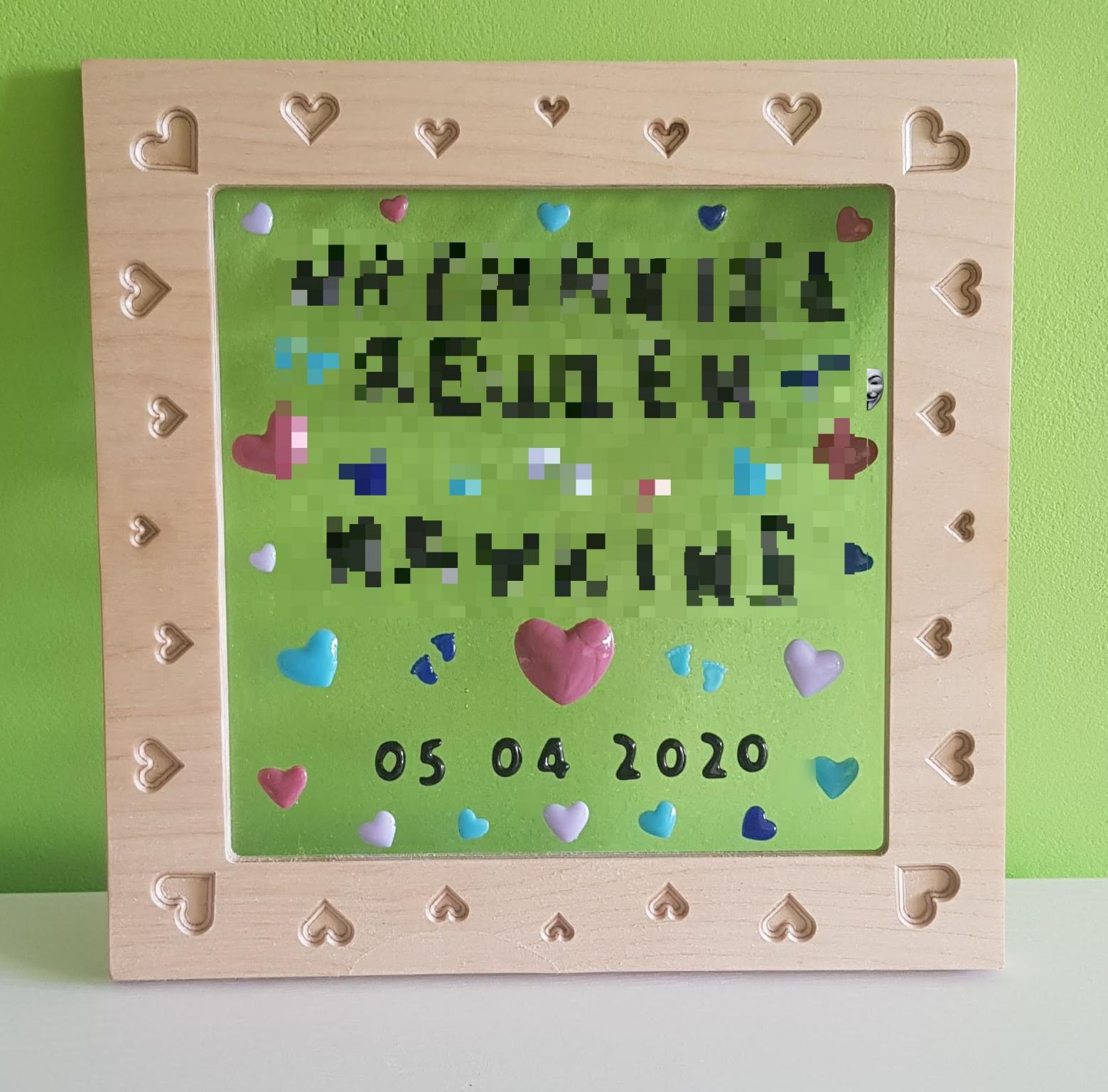

    Then I gained a new nephew - so clearly this needed more glass work and a frame. First try of 2-sided machining to create a pocket on the back for the glass plate to sit into.

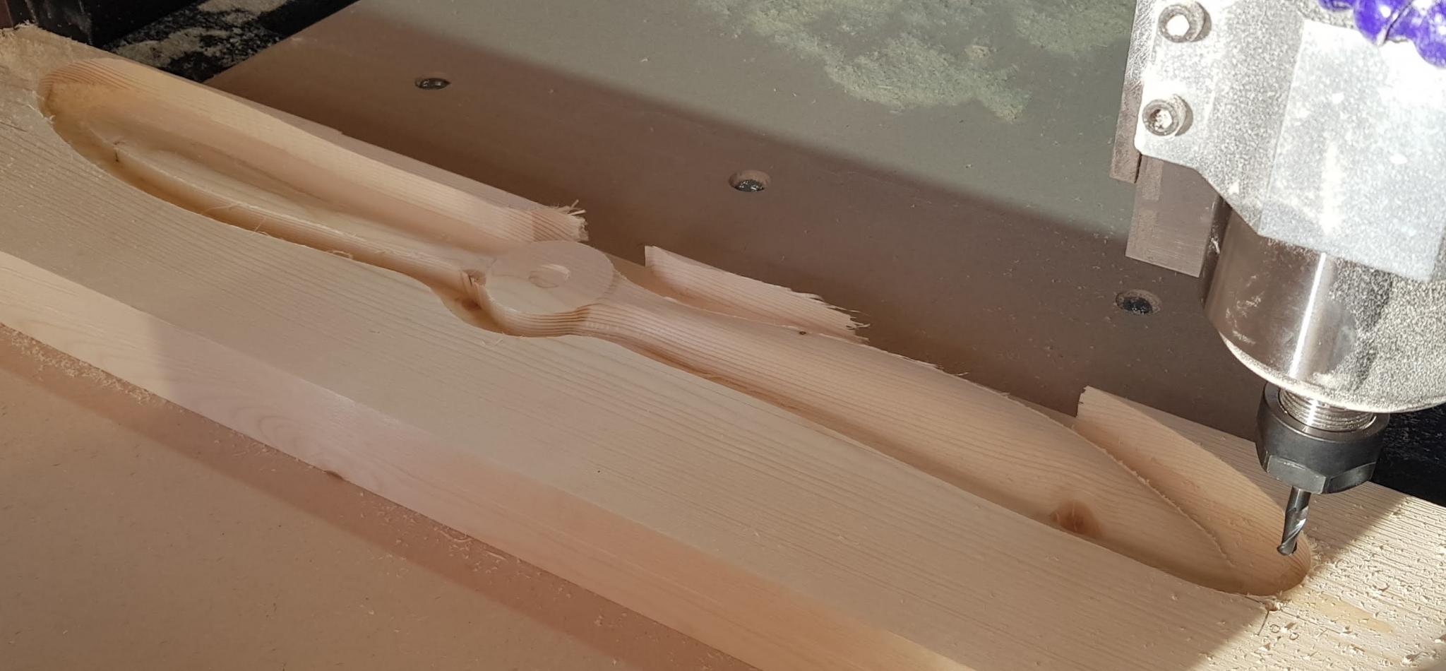

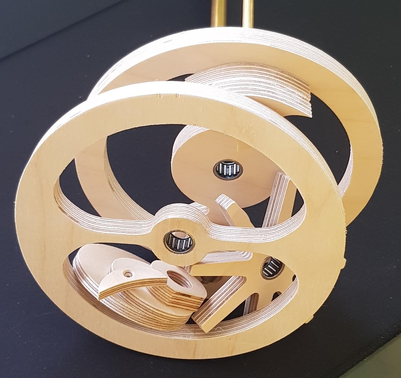

    I'm currently working on a project that I'll probably make a thread about once I'm happy with it... but here is a sneak peak:
    Any guesses?

    There are loads of designs for wooden joints that are designed not to have sharp corners so you can cut then on a CNC machine. Some nice examples at the link below. I've used the first, simple finger tenon design for some boxes.
    I suspect you're building something inspired by David C Roy.

    I was ready to say that the project is one of those wheels for kids that they push them around the house and make a noise that drill your ears,but after that I think that this is not a wise man's choice to build something like that now that we stay home because of the pandemic!
    I am kidding,I do not know what it is.
    Thanks Kitwn, really helpful link! :)
    Yep - got it in one, I suspected anyone into their wooden clocks would know.
