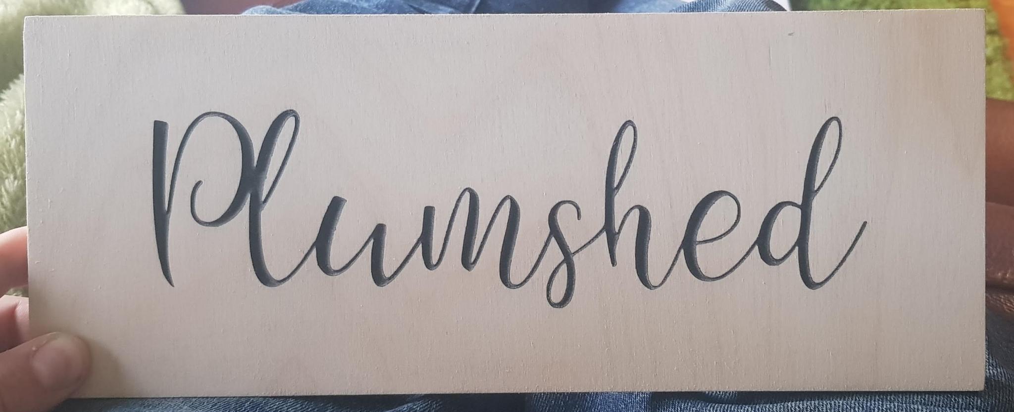

    Couple more projects - My Brother wanted a 'Plumshed' sign (don't ask - long story), so I did a V Carve with some google fonts. Really love how much the black paint adds.

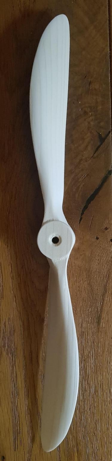

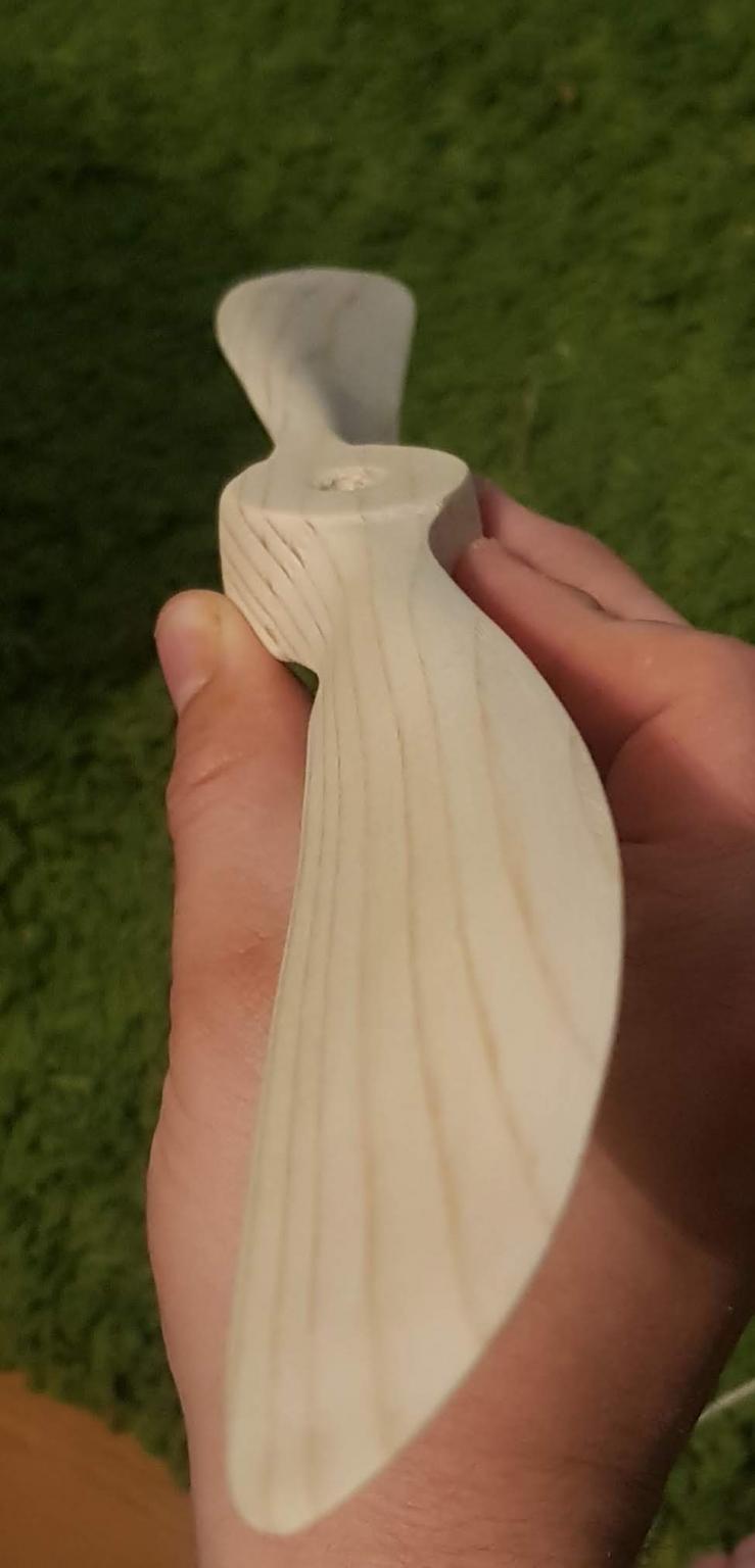

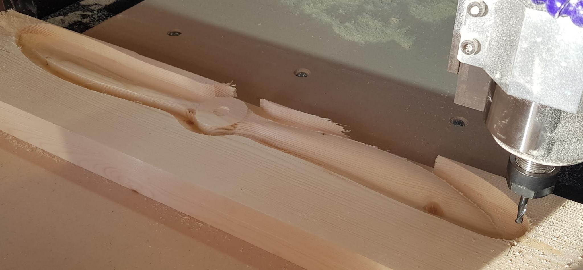

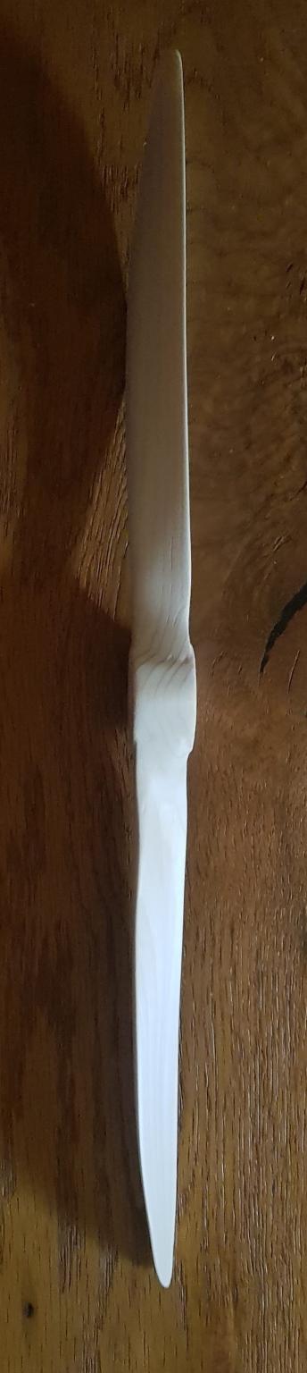

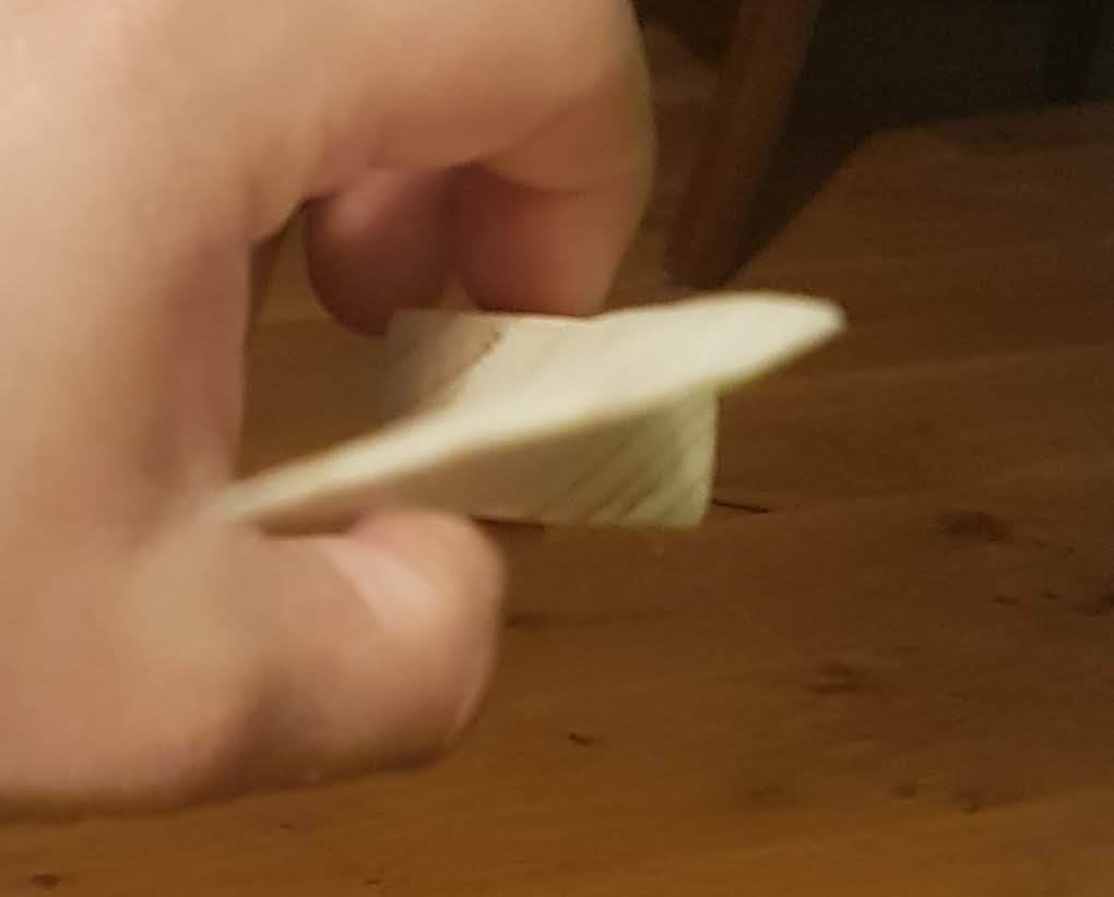

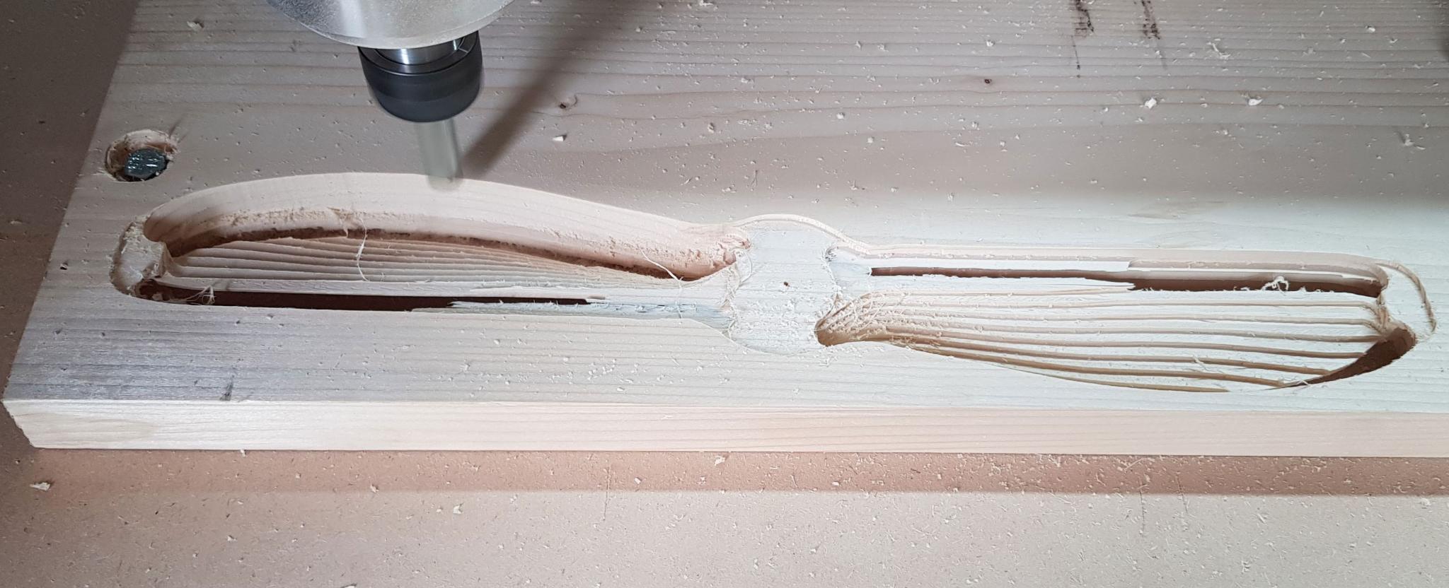

    Heres how the prop turned out, after a few duds and a bit more learning. Nothing special, but I'm rather pleased with my first two-sided 3D carve - quite hard to photograph that twisting shape though..

    Right - lets get back to building machines shall we? Its become rather apparent that dust collection is essential. I'm thinking I'll print one of Boyan's turbo shoes, but has anyone got any dust collection system recommendations? I'd like to be in the garage while its on, so thats a consideration.

    Andy,
    That prop looks great. I love the way the grain flows along the blades.
    I do take a certain pleasure in the idea of a wooden pendulum clock being the most accurate timekeeper you can own. The mixing of technologies is fun, though some of the purist mechanical clock builders are not convinced.
  8. #146
    The grains that run the whole length of the propeller was the first thing I notice too, on purpose cutted from the piece of wood for more strength? Maybe a working propeller?
    Andy did you hand sanded after the finish passes?
    Is the propeller balanced? I mean did you try to spin it and see if it is?
  9. #147
    The grain is deliberately running the length, yes. I did try a miniature one (10cm rather than 40cm) with the grain running in the opposite direction, but it snapped during the bottom side roughing.
    I believe that's how real ones are supposed to be done for strength during use? But I have no intention of using this in anger - although it's quite tempting! This one is purely "because I can" and it was a challenge for my CAD, CAM and CNC experience!
    Yes, hand sanded to remove tabs and clean up a bit, but the shaping is all through a 6mm ballnose. Obviously the photo is just a roughing cut - see the earlier post for what one side looks like after finishing pass. Prop isn't balanced perfectly - but does produce some wind! I should have machined the central shaft with the CNC but didn't want to risk the part at that stage as it's taken a few attempts - each requiring a few hours. It's not too far out though, I think a bit of selective sanding and it would be useable. I have a prop balancer somewhere; I'll stick it on later and see.
    I think the real one's (Spitfire etc) are laminated not one piece . You have made a very good job of it
  11. The Following User Says Thank You to Clive S For This Useful Post:
  12. #149
    I think spitfire had an aluminum alloy propeller, but yes the old blade of WWI was wood multilayer made.
    You usually make two cuts on the wood to his length and then rotate the center beam 180 degrees at his longitudinal axe, for a small scale wooden propeller.
    With your cnc you can always make an aluminum one.

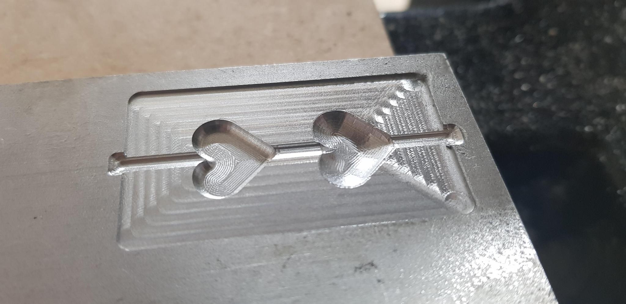

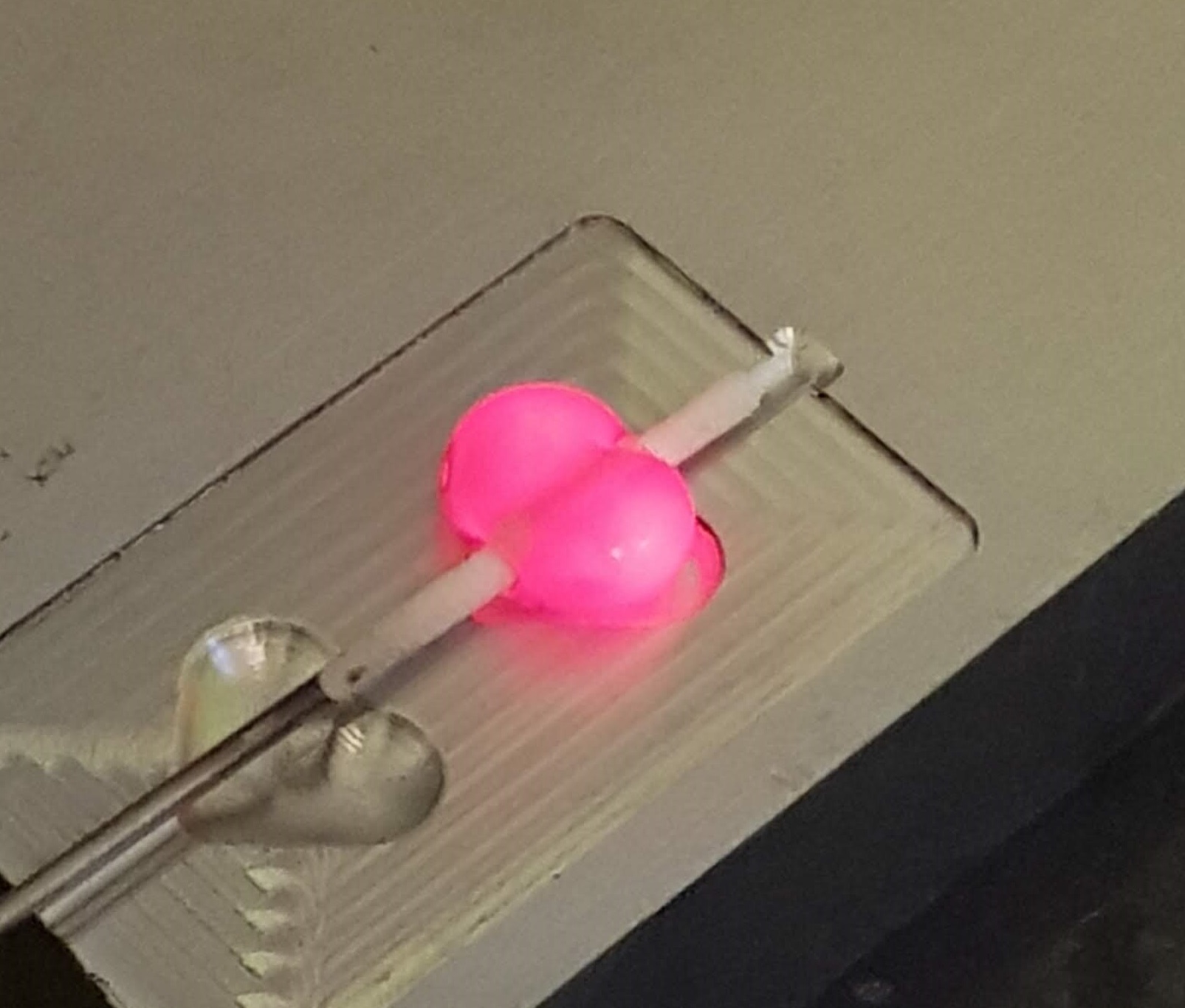

    Promised an update when I ventured into Aluminium; its only the smallest of steps, but I'm pleased with the results.
    The "client" has requested a lampwork beadmaking tool which could form the molten glass into a heart shape. This is the first in a series of tests; the eventual product will need to have two identical sides to squish the bead into shape, but we've just started with a single side for now.
    Tried two shapes, a 3D heart and a 2D heart. I pocketed and roughed with a 4mm single flute endmill at 18k RPM and 1.5m/min. Kept the DOC very low at 0.5mm as this is my first time, but the router wasn't phased in the slightest. Then finished with a 3mm Diameter ball nose, 24k RPM 1m/min. Very basic tool paths from aspire, nothing fancy. Went a bit overkill and gave it lots of air blasts to clear the ships and plenty of WD40 in between!
    To give an idea of scale, these hearts are designed to fit within a 15mm diameter circle. Very small.
