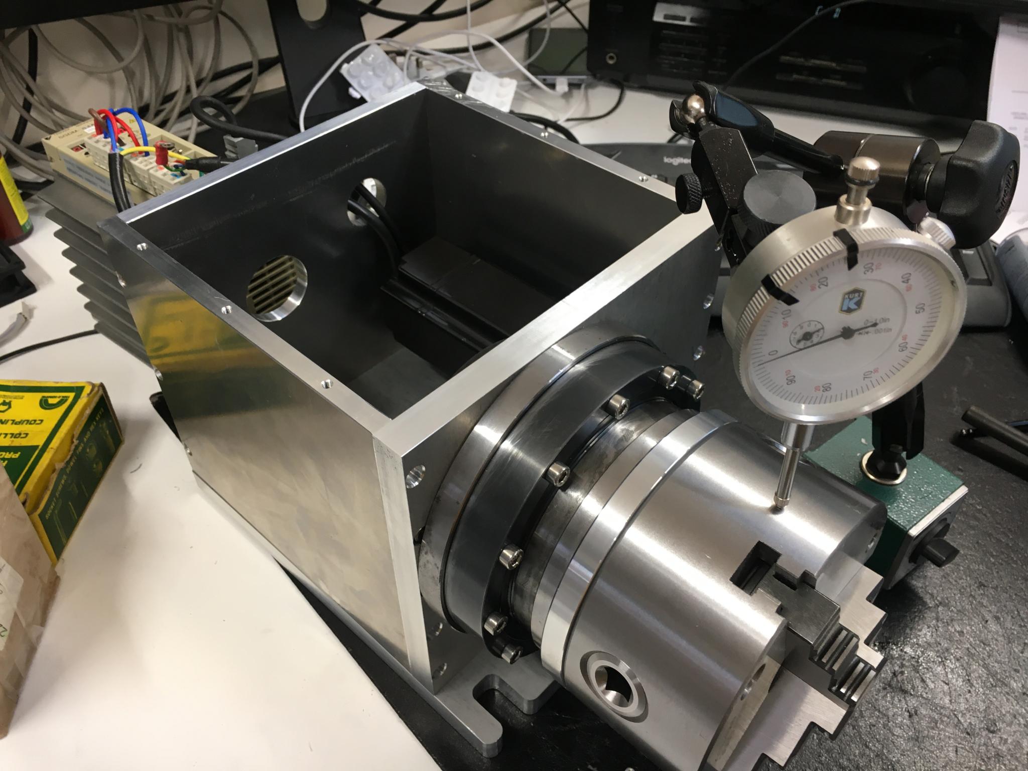

    Not sure if it's quite what you are after but I've just about finished a fairly conventional 4th axis using one of the harmonic drives and a servo motor, all culled from one of the Korean scrapyards. Looks good so far - had it jogging yesterday.
    This is for a metalworking milling machine, so has a 125mm 3 jaw chuck which I have bored through 36mm, so I can hold long stock.

  7. The Following 3 Users Say Thank You to Muzzer For This Useful Post:
  8. #156
    I like! Thanks Muzzer :)

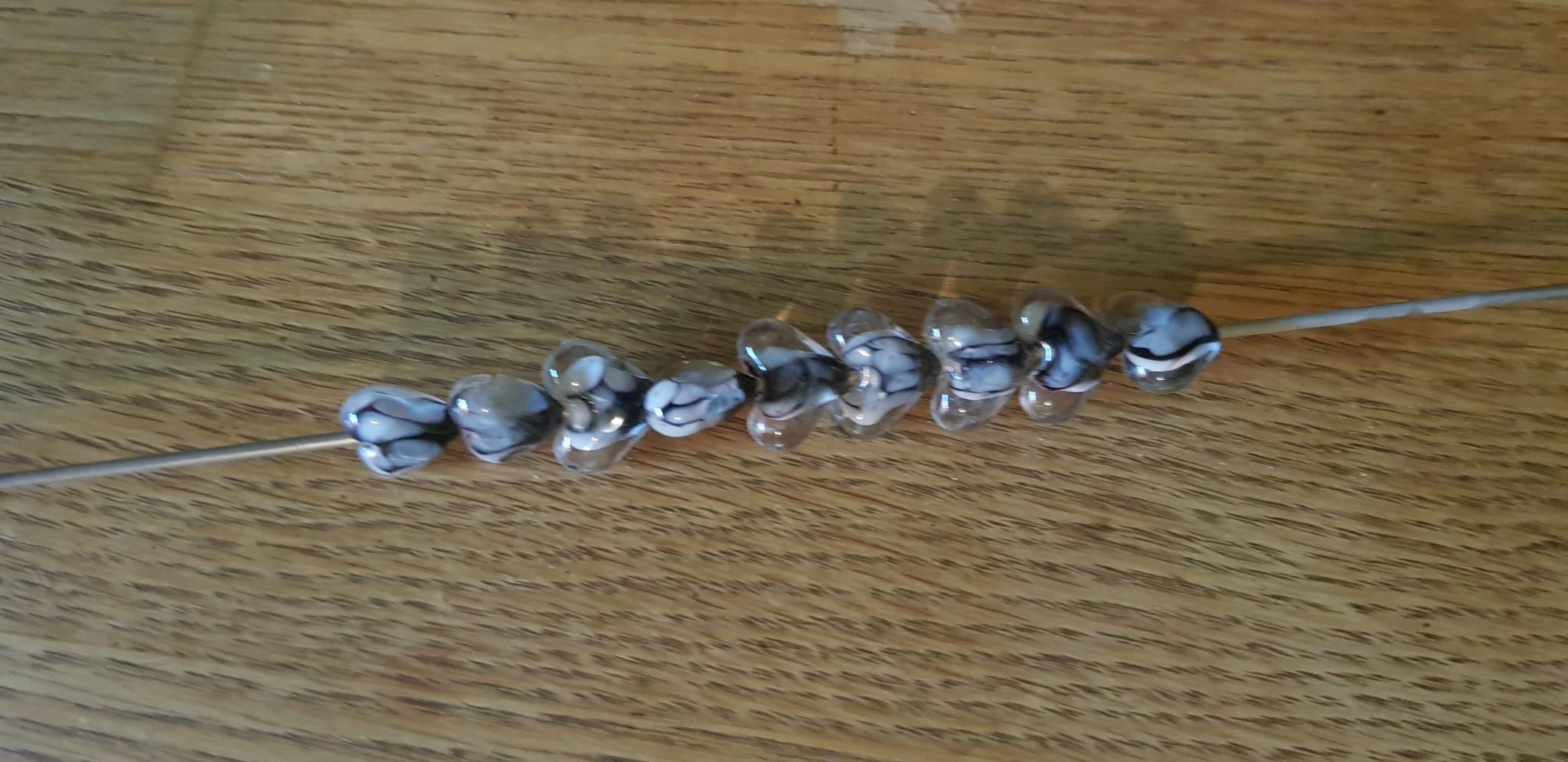

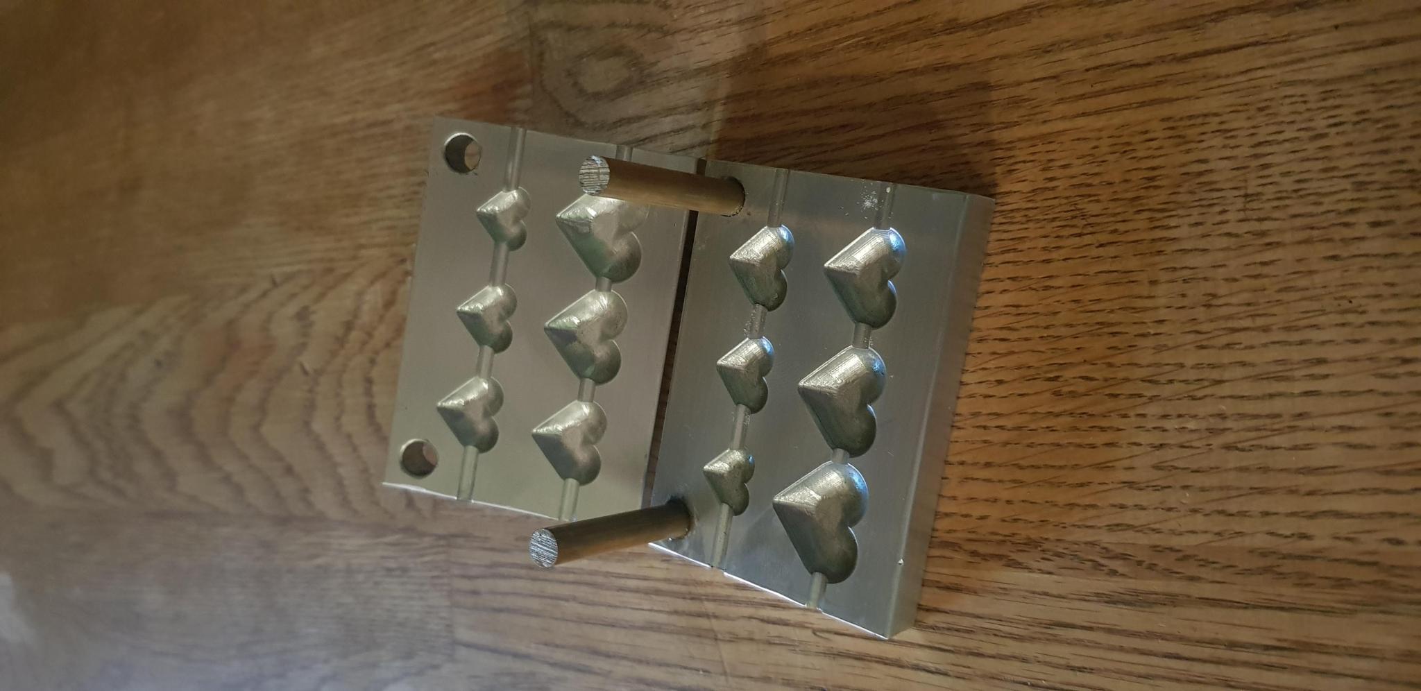

    Quick update to the Aluminium Bead Presses. Other half demanded six sizes of the 3D hearts in both a horizontal and vertical press. Settled on a 0.2mm step-over - we did some tests lower down but whilst the finish was buttery smooth the tooling marks arn't translating into the glass, so decided this was a good compromise (or if they are, they're soon rounded up by heat). Getting some great consistency out of the presses, so happy customer :)
ID:	29030 Click image for larger version.
ID:	29029 Click image for larger version.
    We're now exploring other shapes.... (The ribs are intentional - not poor machining!)
