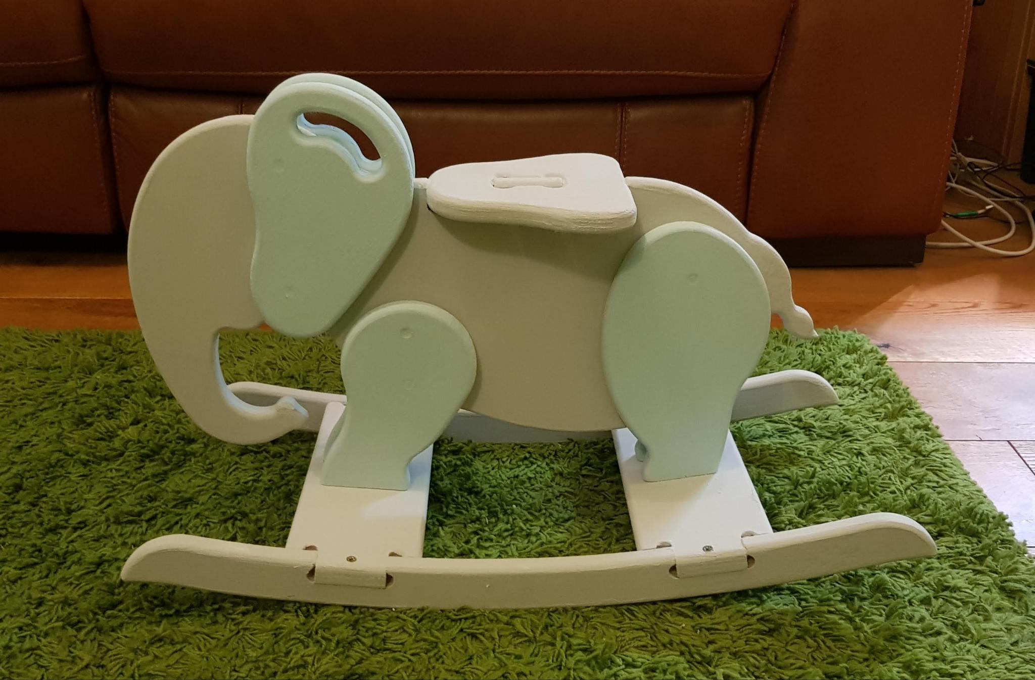

    Had a weekend playing with the machine and finishing up a few bits.
