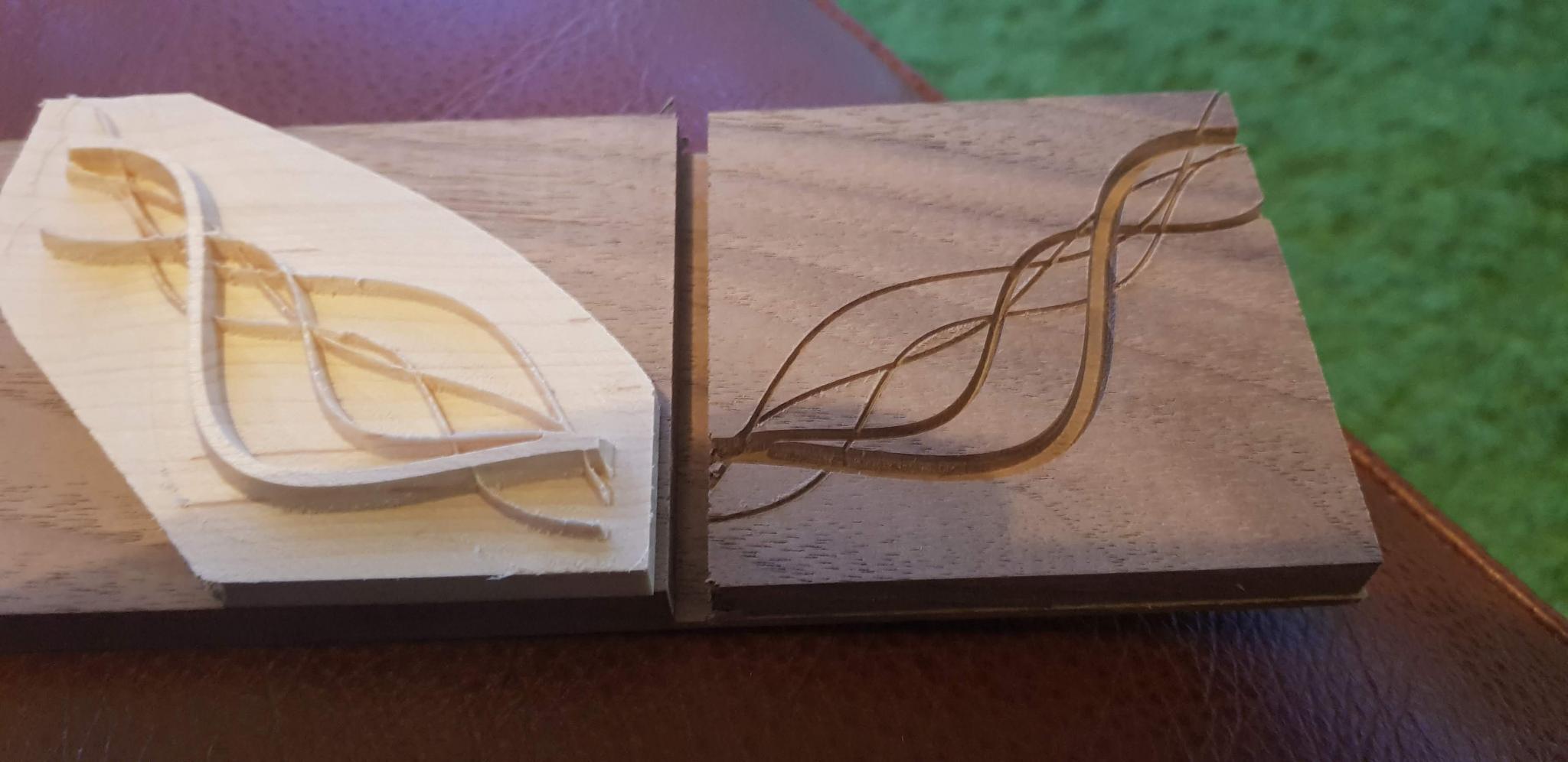

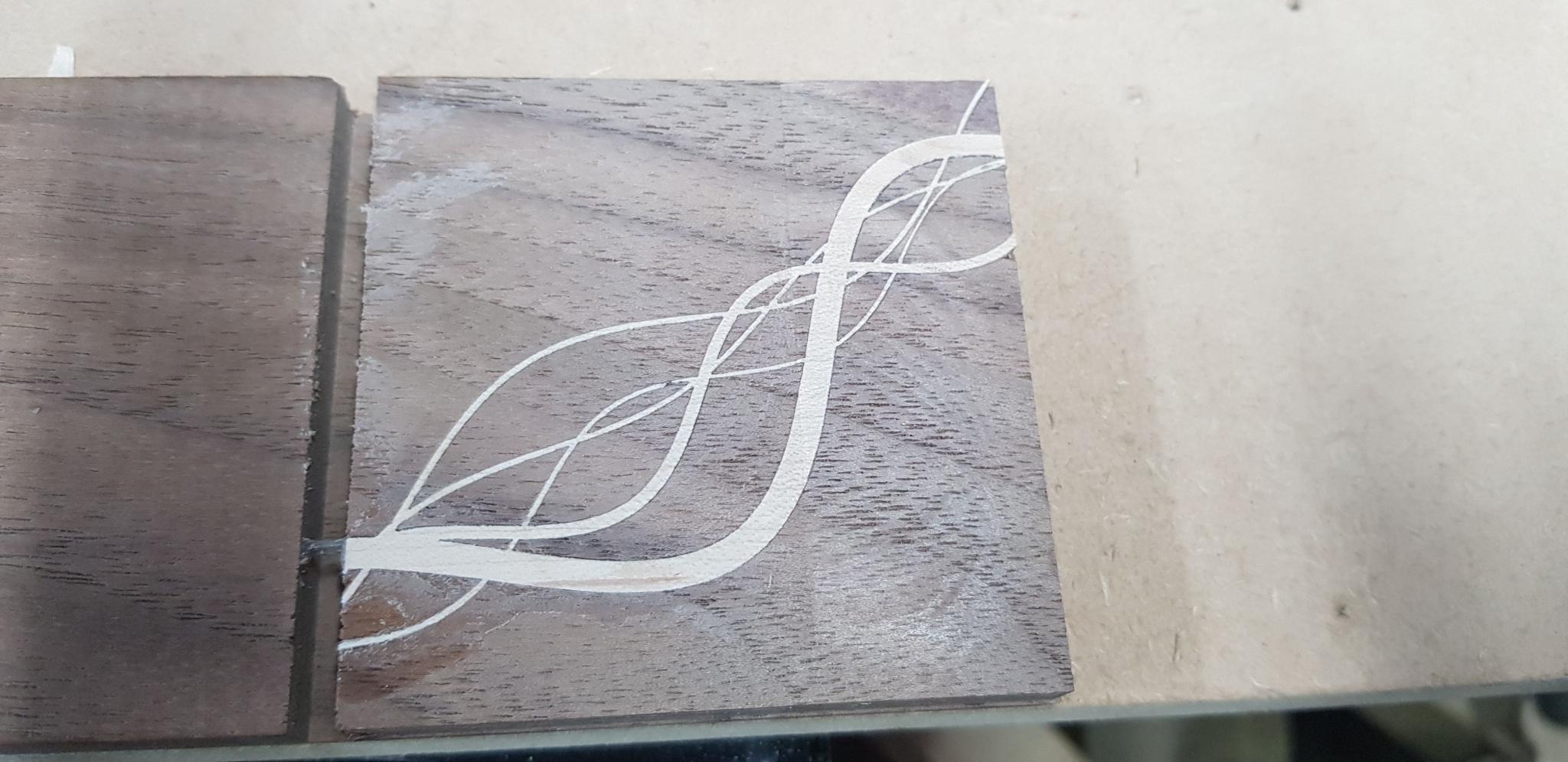

    Finally got around to trying my first inlay with this machine. Tried to challenge it by using a series of line widths, 0.5mm up to 3mm. Classic walnut and maple. 70x70mm square.
    Used a 30 degree V bit, 2mm inlay depth, 1mm glue void depth, 1mm air gap above.
    Plug and base (are there real names for these?) - Ran the cut twice on each to clear up some fuzzy bits - suspect my feeds and speeds arn't quite right, but I was being conservative.

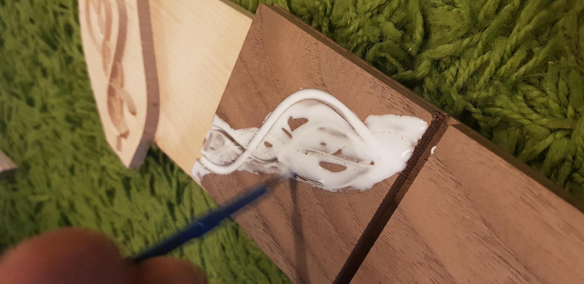

    Glue time.... used some pretty standard PVA, that might come back to bite me but seems to be working.

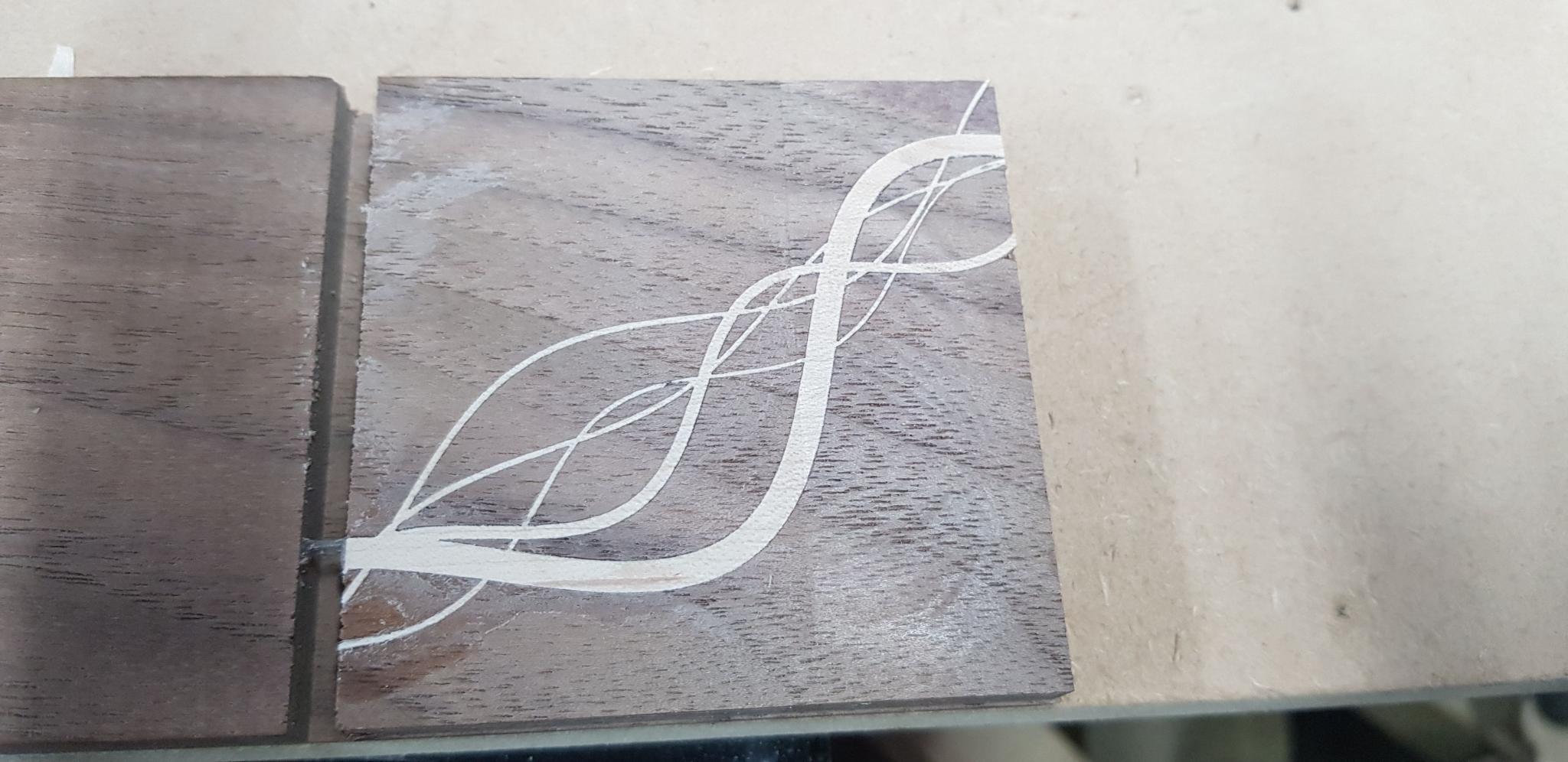

    Trimmed the excess slowly and gently... reveal time!

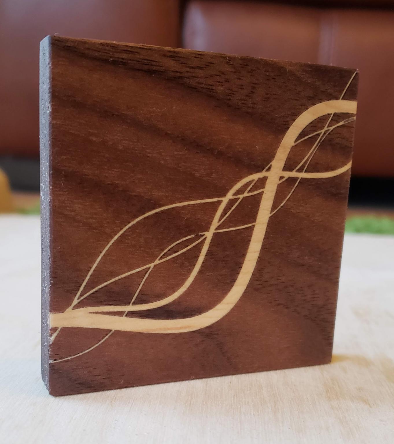

    Some sanding through the grits, add oil... et voilà.
    Not perfect; looks like theres some reaction going on at the interface between the two woods, and I think there was an imperfection in the maple or the plug cutting that caused that slight discontinuity, but overall quite pleased for a first attempt.

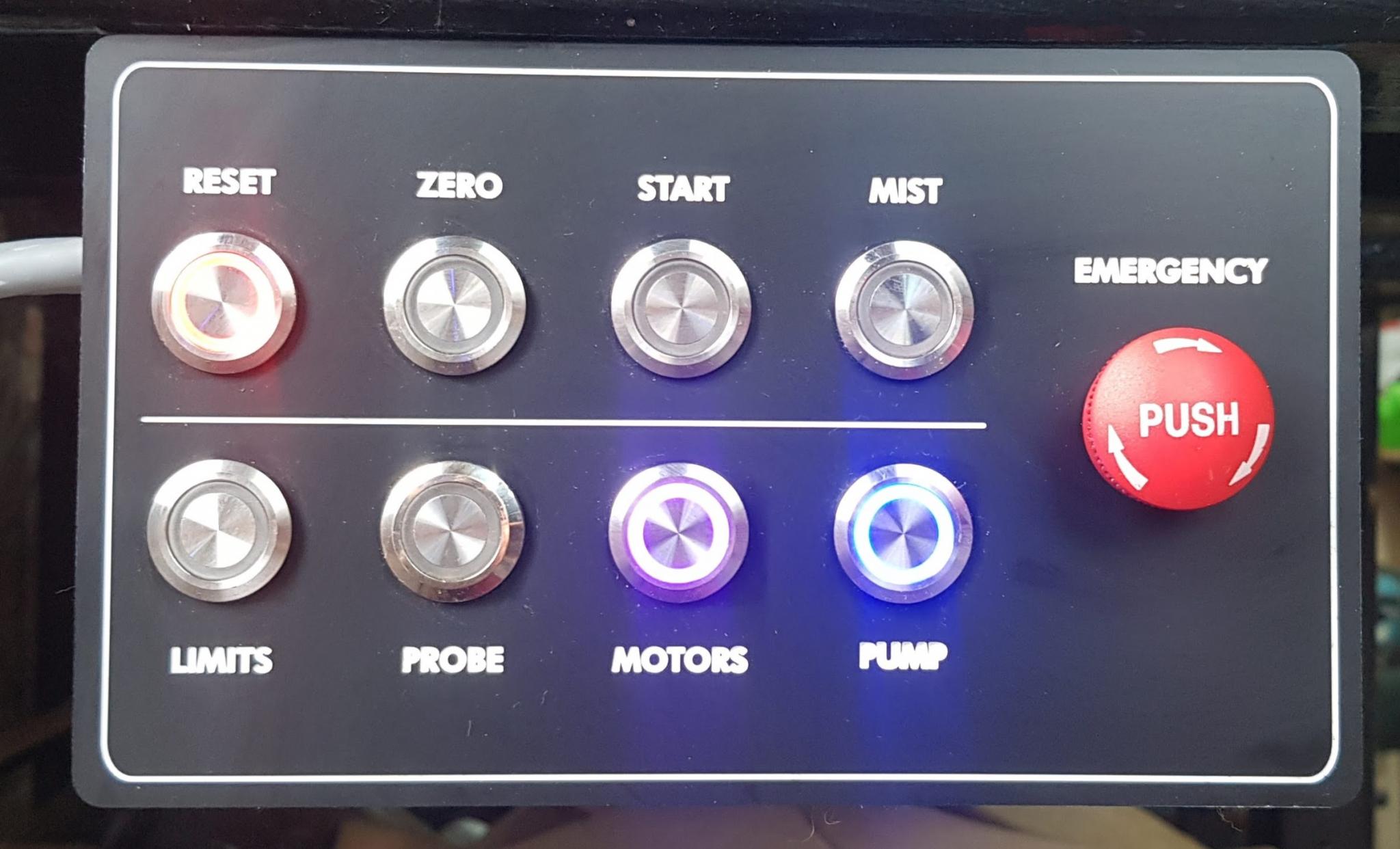

    Well... I once said this about my wooden control box:
    First thing was to make a quick and temporary control box...
    Attachment 27824 Attachment 27825
    Turned out temporary is over a year! I've also got a much better idea about the buttons I wanted, so popped a few more on there.
    Also coming up with a few ideas for design modifications. I'm considering adopting the two plates idea on the X axis to make the gantry adjustment more independent from the ballscrew and linear rails. It will also add a little height to the gantry; I'm finding that although the bed height is adjustable in theory, the work involved is quite prohibitive (its bloody heavy, you need to re-level everything, and then you're working at a non-optimal height). I've found that with tool length, my current setup can only manage a depth of about 50mm or so. With a small bed height adjustment and a few tweeks I should be able to get a bit more room. Then theres the lack of a tramming plate on the Z axis, and it would be nice to have my Z probe plate wired so that it travels around with the spindle and is always close to hand....
