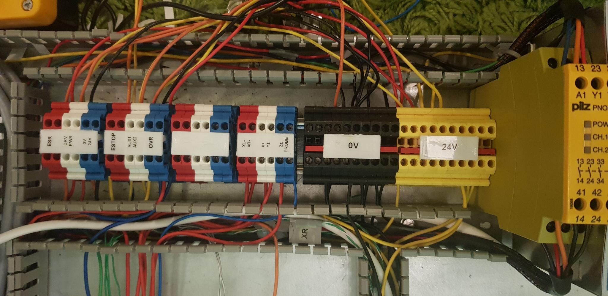

    Lets talk cabinet layout for a moment or two.
    I've just started a thread about tidy wiring (here) so I'm currently still deciding how to do my wiring channels (shown as green in the annotated diagram) as neatly as possible, but I think I've got a plan for the overall layout.
ID:	26184 Click image for larger version.
    As you can see, I've silently been buying more and more electronical bits (psst... please don't tell the wife how much this stuff costs...). My plan is to have the drives vertical in the bottom right with heatsinks facing each other, right by the inlet fan. The outlet fan will then be at the top of the case directly above the VFD (or possibly top left facing out sideways... which might be better from a water point of view if the roof were to leak (a real possibility in my garage...). My thinking here is that they'll have the most urgent cooling need in the cabinet, so they get the coldest air first. I'll probably put the two X drives at the top, as they'll be working the hardest and I don't want their heat transferring to the Y and Z drives - Who knows if that logic makes any sense or not? Maybe it should even be the other way around...
    This position allows the driver outputs to get straight out through the GX20 connections on the base, and the input signals can come directly in from the right hand edge (as shown) of the UB1 where all the step and direction signals come from. The drive PSU is a little awkward here, but shouldn't be too far for the power to get to the drives from the right hand side of the PSU.
    The GX16 connections (limit switches, homing switches etc) also come in at the bottom and can go straight up to the UB1.
    My plan is for mains to come in bottom left, skirt behind or up the side of the PSU, and into the distribution/fuses area. From there each mains device will connect via individual EMF filters and relays/contactors/big on off switch as required.
    Finally, theres a low voltage section up top. My plan for this is to have the safety / 24V circuits up here. This is where the control panel will interface - I have a selection of LED buttons for this, each with a specific function in mind, but I still haven't decided exactly where the panel will go (having a glass fronted cabinet is nice, but not so many options for things like buttons!).
    Anyhow, I hope that either this post is helpful to others, or someone can point out any glaring problems or things I've not thought about! Update on the mechanicals soon - there is currently paint drying, and the garage has been even messier than usual in the last few weeks so I've not gotten around to photographing and writing up the most recent developments.

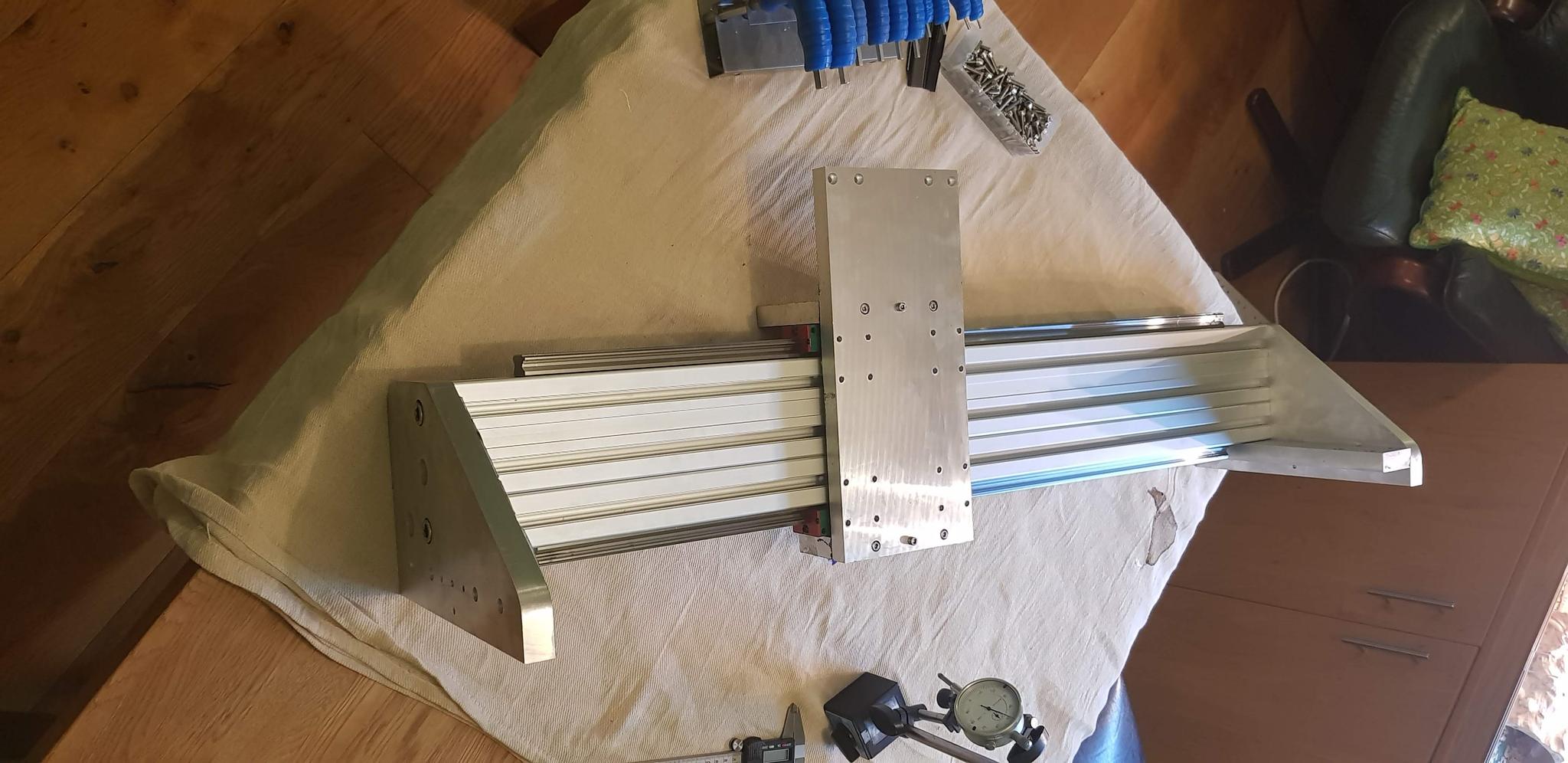

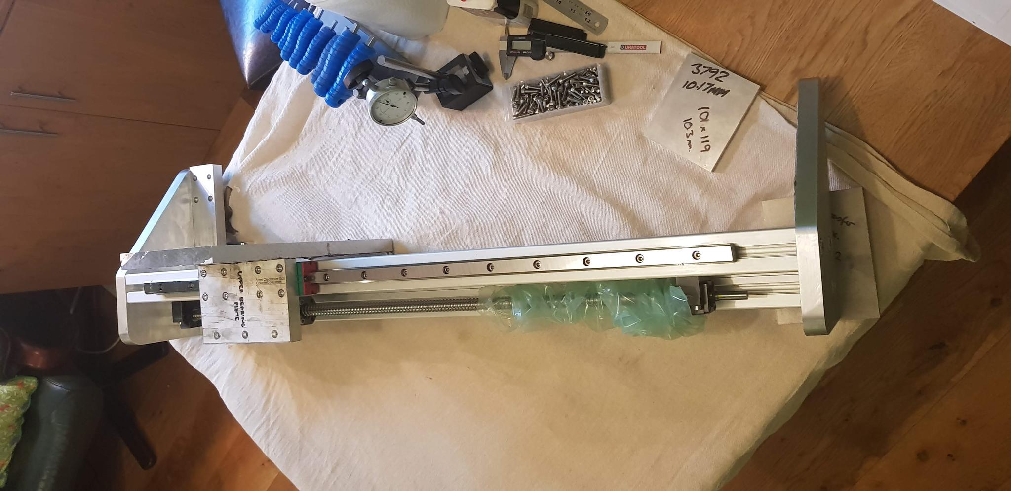

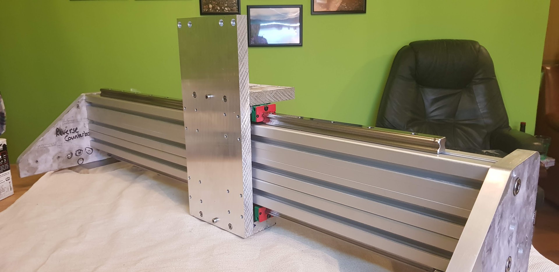

    I promised an update on the frame - here she is in all her badly painted glory!!
    Since the last photos, I've
    • Faired the edge of the epoxy into the frame and repainted the box sections.
    • Filed off the meniscus along the edges and at the ends.
    • Marked drilled and tapped the epoxy for the rails.
    • Roughly aligned the rails for parallelism
    • Checked the levelling with a precision straight edge - more details below.
    • Thrown the gantry on the rails - it glides super smooth (and made me very happy!)
    • After getting happy about that, I then got very sad. Turns out my steel frame is a bit of a rhombus! When I bring the gantry to one edge, it hits the end of one rail about 3-5mm before the end of the other, and the opposite occurs at the other end. I don' t think this will actually affect anything, except perhaps my pride...
    • I then did some more milling, making my Z and Y nema 23 motor mounts. That was fun. :)
    • Did a rough assembly - All I need now to make the Z and Y axis move under their own power are the belts which are on order. It was nice to be able to measure the distances between pulley centres physically rather than just in CAD.
    The rails both show the same trend, they're high at the ends and low in the middle with an error of about 0.05mm - I'm sure this could be better, the epoxy still set relatively quickly, so I'm sure there are improvements to make. It could be that I just haven't filed down the ends of the epoxy enough and they're slightly propped up at the ends, but its 'close enough' for me at this stage. The other consideration is that this value is the stated accuracy of my straight edge, so optimising it now seems counter productive. I will probably come back and shim the rails, but I'm keen to do a 'proof of concept' and am aiming to have the machine cut something by Christmas.
    I've noticed that the Z axis isn't as smooth as the others; I think it might be the alignment of the ballscrew vs the rails, I've discovered that my design is a bit of a nightmare to try and measure the alignment between the two, because the rails and the screw are attached to different parts. The other thing it might be is that the Z axis is the only one thats had a load of EP2 applied - does that typically increase the resistance on the screw? I can turn the pully by hand no problem, but you can feel that it has more and less resistance at different ends of the travel, which is something I don't feel on the Y. Any hints or tips?
    The other problem I'm now considering is how to check the axis are perpendicular... can anyone point me in the right direction? I think Boyan mentioned needing two precision squares to align properly... I can see why you'd need one, but two?
    Thanks!

  7. #6
    If the diagonals of the x (long axis ) are equal, then the axis is orthogonal,start from this !
    Then bring the Y axis at a point and measure with a square, that you know it is at true angle.
    How you know that you square is really a square?
    Check this video:
    https://m.youtube.com/watch?v=gDh-E5xhm0o
    If your square is not as it should ,do not through it away,check on YouTube how you can make it square again.
    Good luck!
    And remember any precision tool that is fall on the ground or it it is banged on something hard,stops to be a precise any more,it needs re calibration.

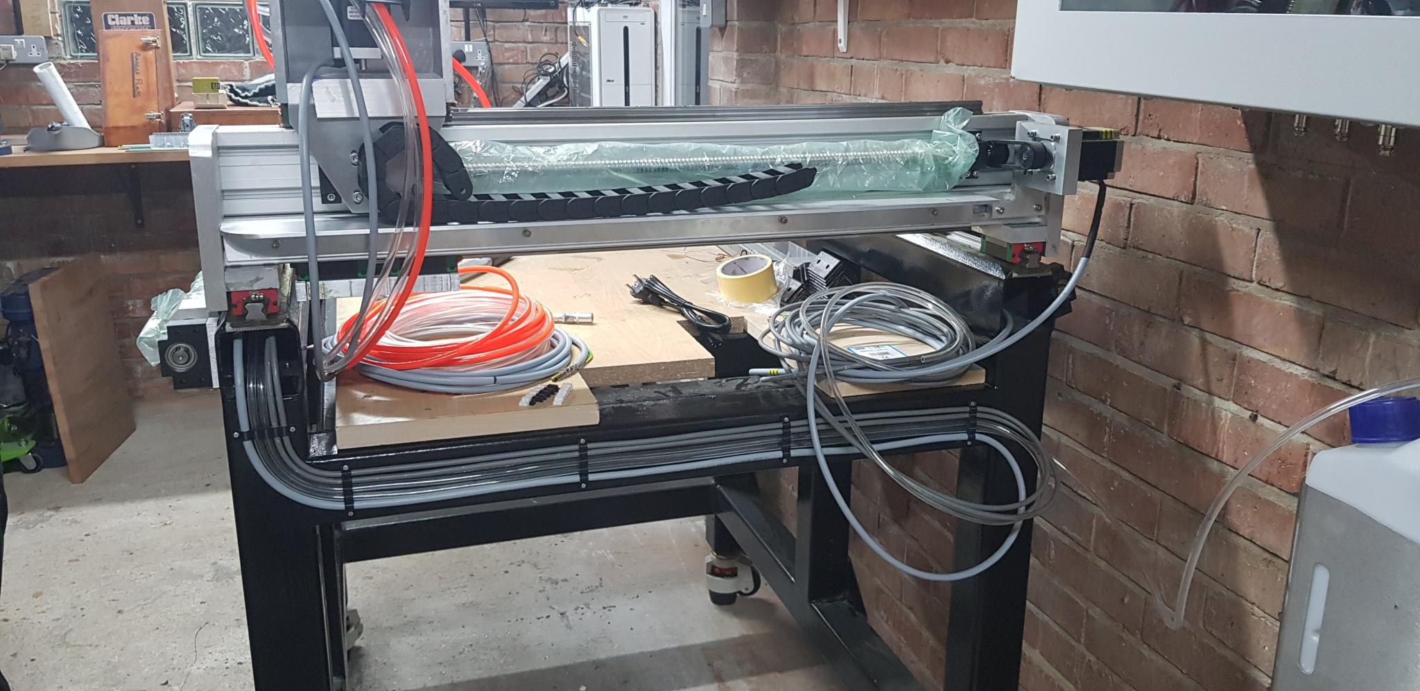

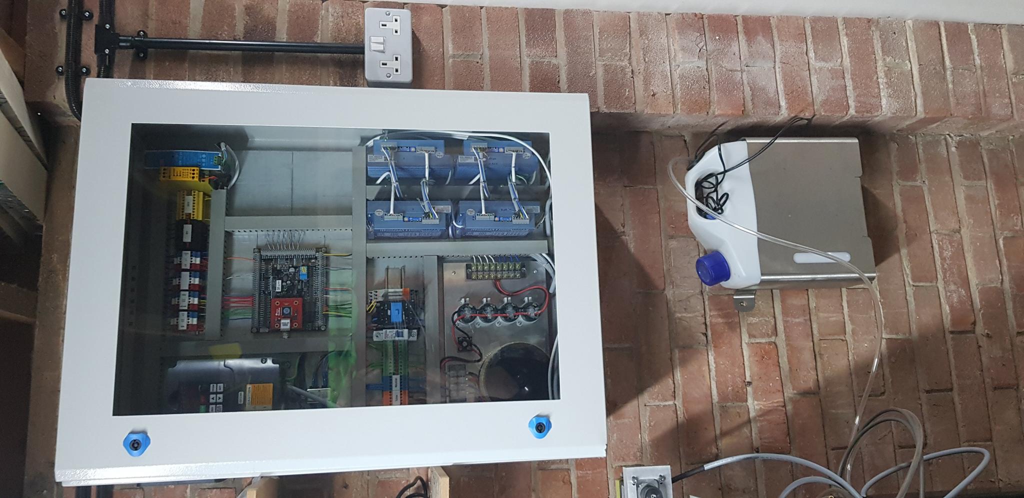

    Had a weekend playing with the machine and finishing up a few bits.
ID:	27441 Click image for larger version.

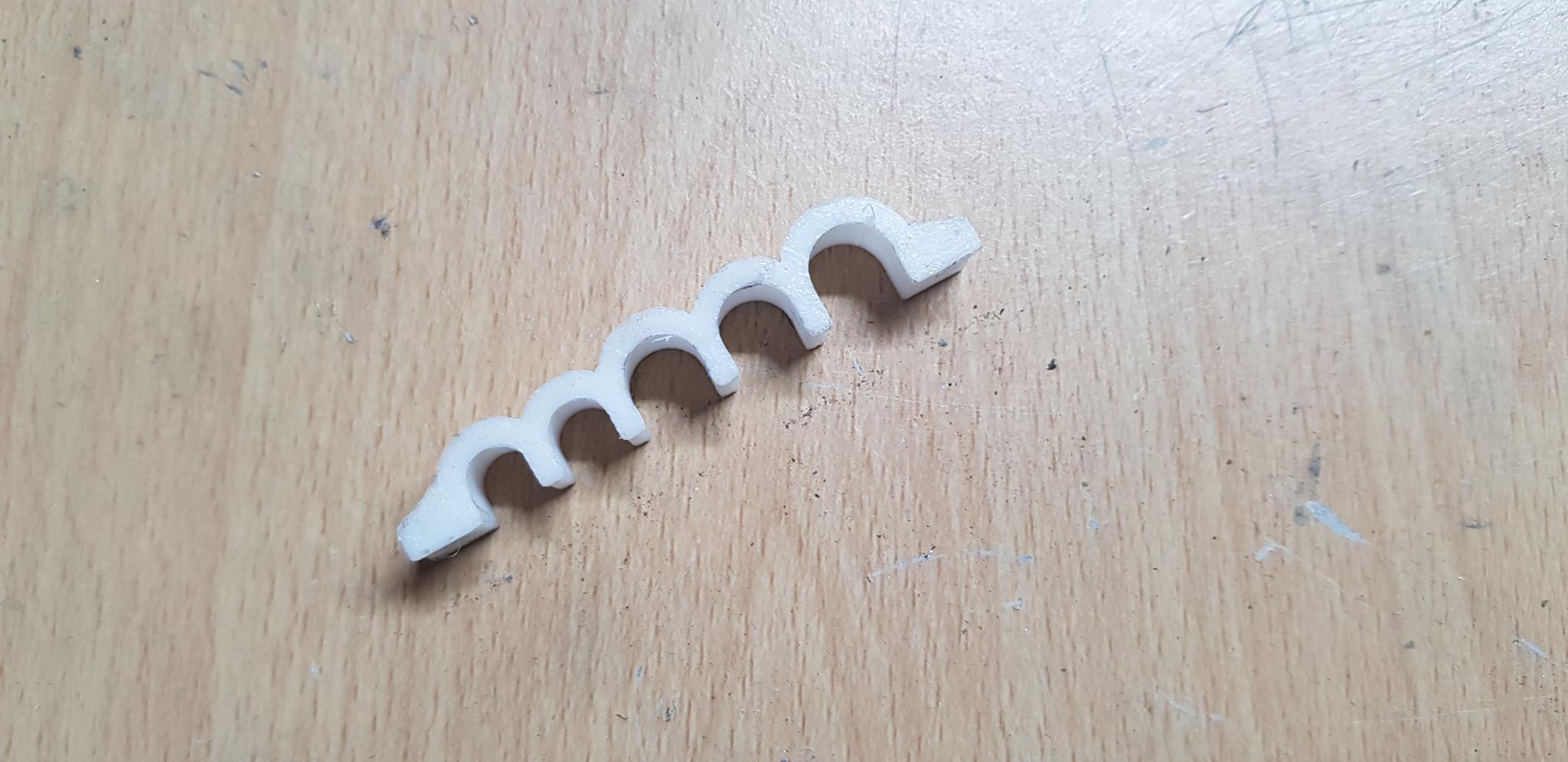

    I've used a 75mm cable tray to hold the 62.5mm wide X cable chain and fitted it with 3D printed supports. Looks great, and I think that cable tray size must be made for the cable chain, smoothly fits right in and glides in and out when going back and forth (gosh this post is starting to get a little suggestive...).

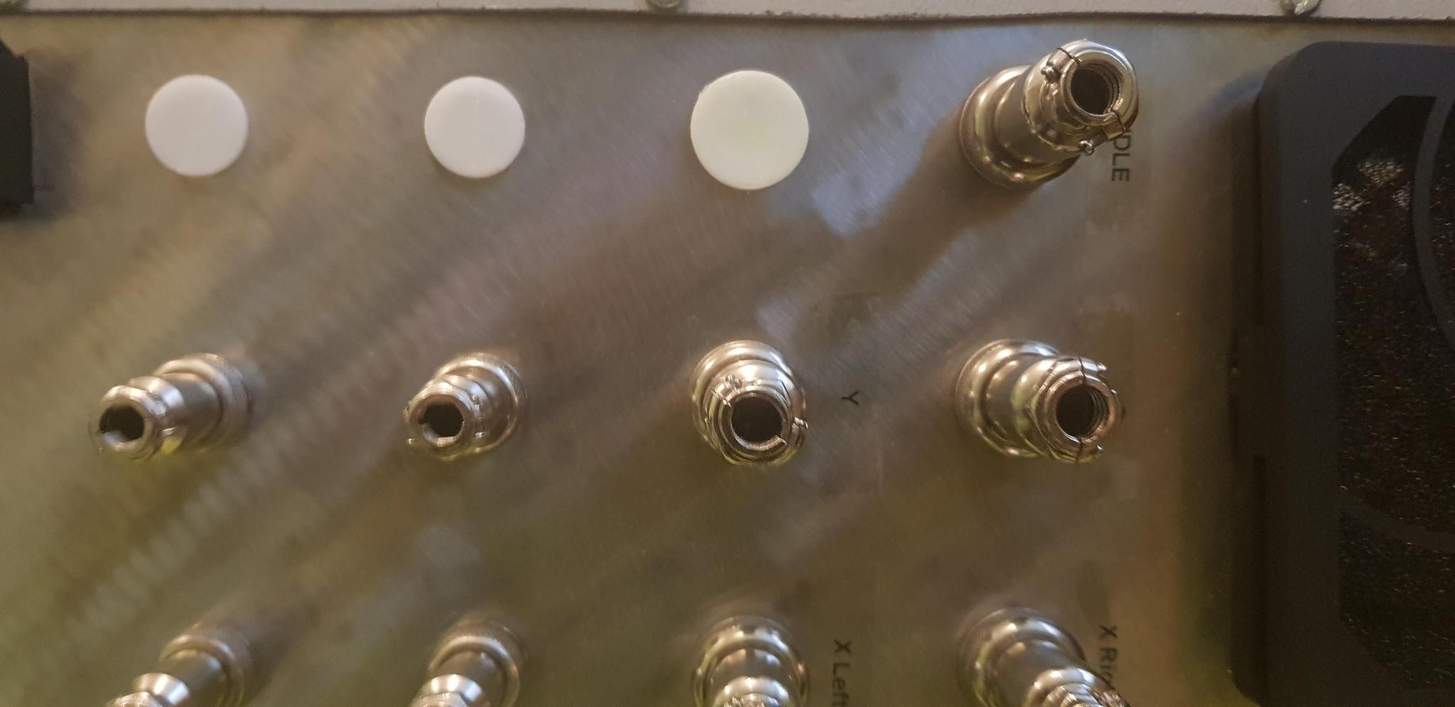

    I've tidied up the wiring around the machine generally, although I still need to make a control box for all those switches!

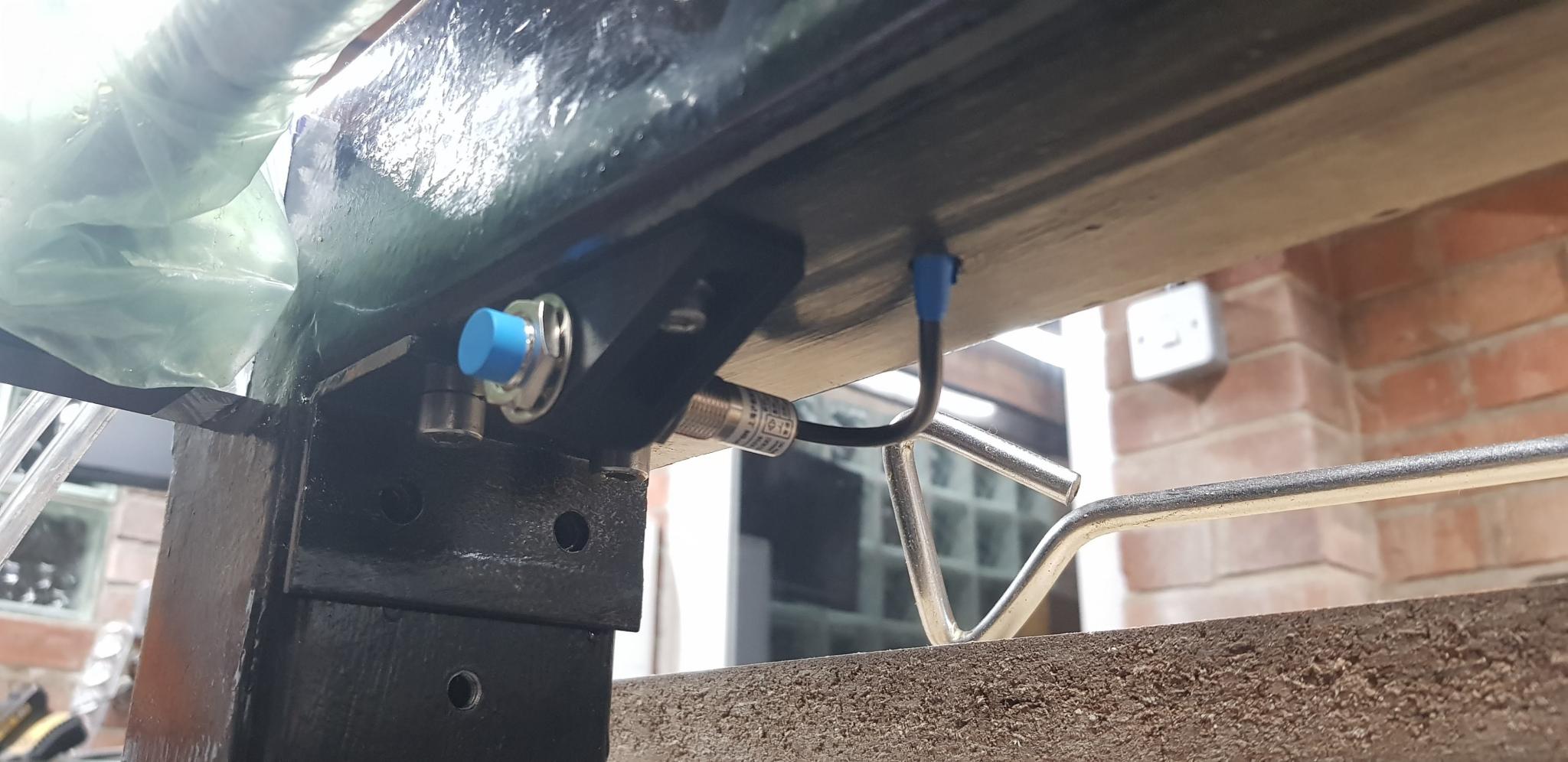

    All the limit / home switches are in place and working nicely, again 3D printed mounts. Thanks for the advice on placement Jazz.
    I've got the coolant circuit filled and burped - the flow rate is absolutely tiny though, just a trickle, serves me right for running such a long loop with just the crappy little pump that turned up with the kit. Its 15m of loop in all due to the X axis stepper cooling, and 8mm piping, so I might need to upgrade the pump.
    UCCNC is now controlling the spindle speed and direction which is great, and I'm using an old Xbox 360 controller to move the machine around which works great. However, I'm seeing the digital display on the VFD fluctuate and can hear the spindle isn't at a steady speed. This is an issue I've seen described with the analogue control methods with the UB1 and UCCNC, so I suspect I'll need to change over to a digital control signal in the future.
    Regards spoil board, I plan to use trespa, but am using some cheap MDF to start with in an attempt to get some mistakes out of the way on something that really doesn't matter.

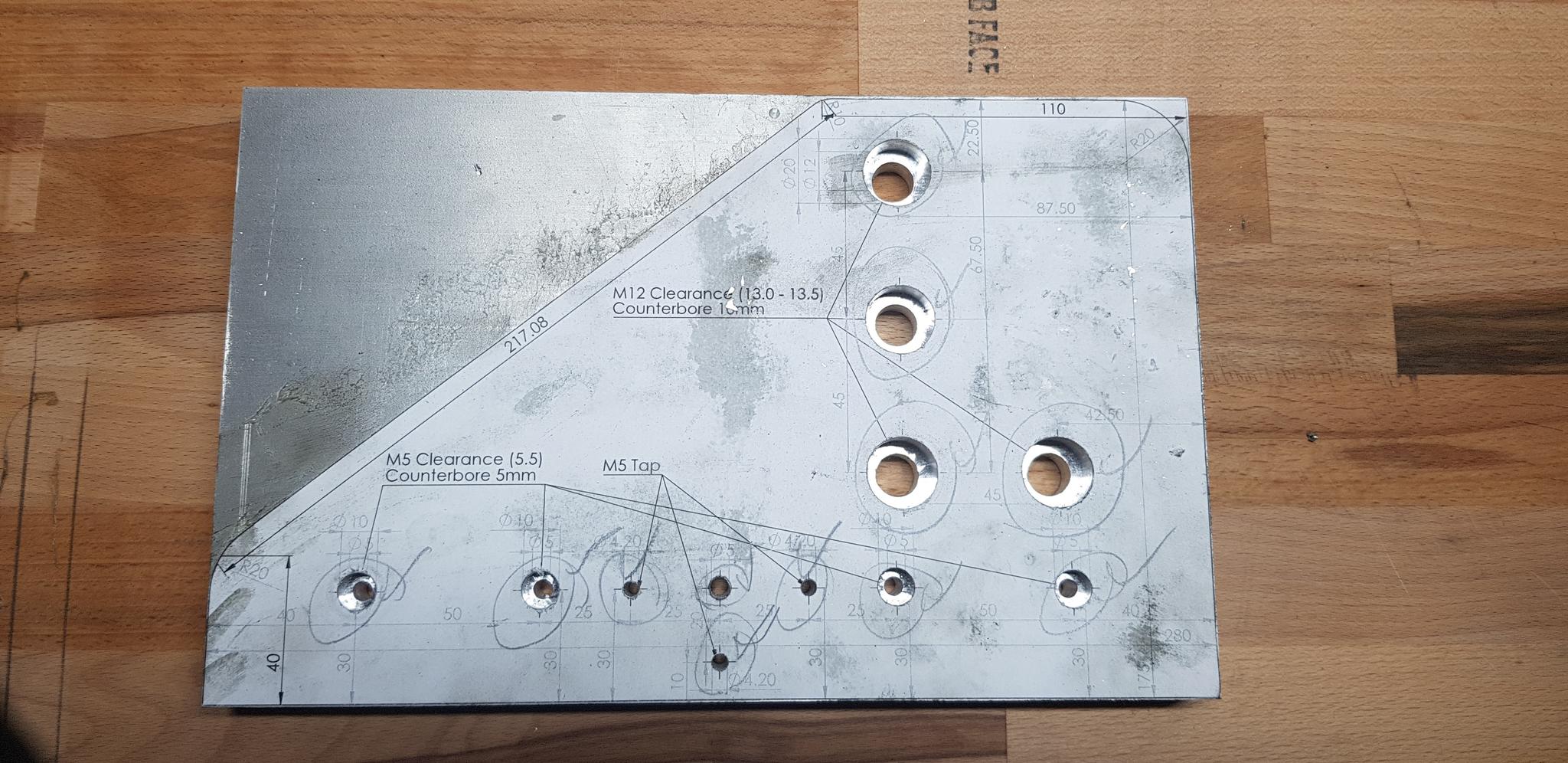

    Spent last night doing spot drilling on a waste board at all four corners and roughly measuring the squareness of the machine. I should have paid more attention to the above at the time - Its not that the steel frame is a rhombus. The X and Y axis are not quite 90 degrees, which leads to an error of 4mm across the two diagonals. I have a precision angle, but haven't got a way to nicely attach a dial gauge to the gantry yet - Its on my list though!
    Initially I'd forgotten the above, and tried correcting by adjusting the home position switches, assuming the gantry was racking. I got the error to 1.5mm (thats 90.1 degrees) on the diagonal, and the next correction stalled the X axis, so clearly I was pushing the ballscrews out of alignment with one another and was twisting the gantry beyond it's limits. That was a big warning sign that I was doing something stupid; obviously the gantry should be nicely aligned to evenly wear the screws and not try to twist against the rails.

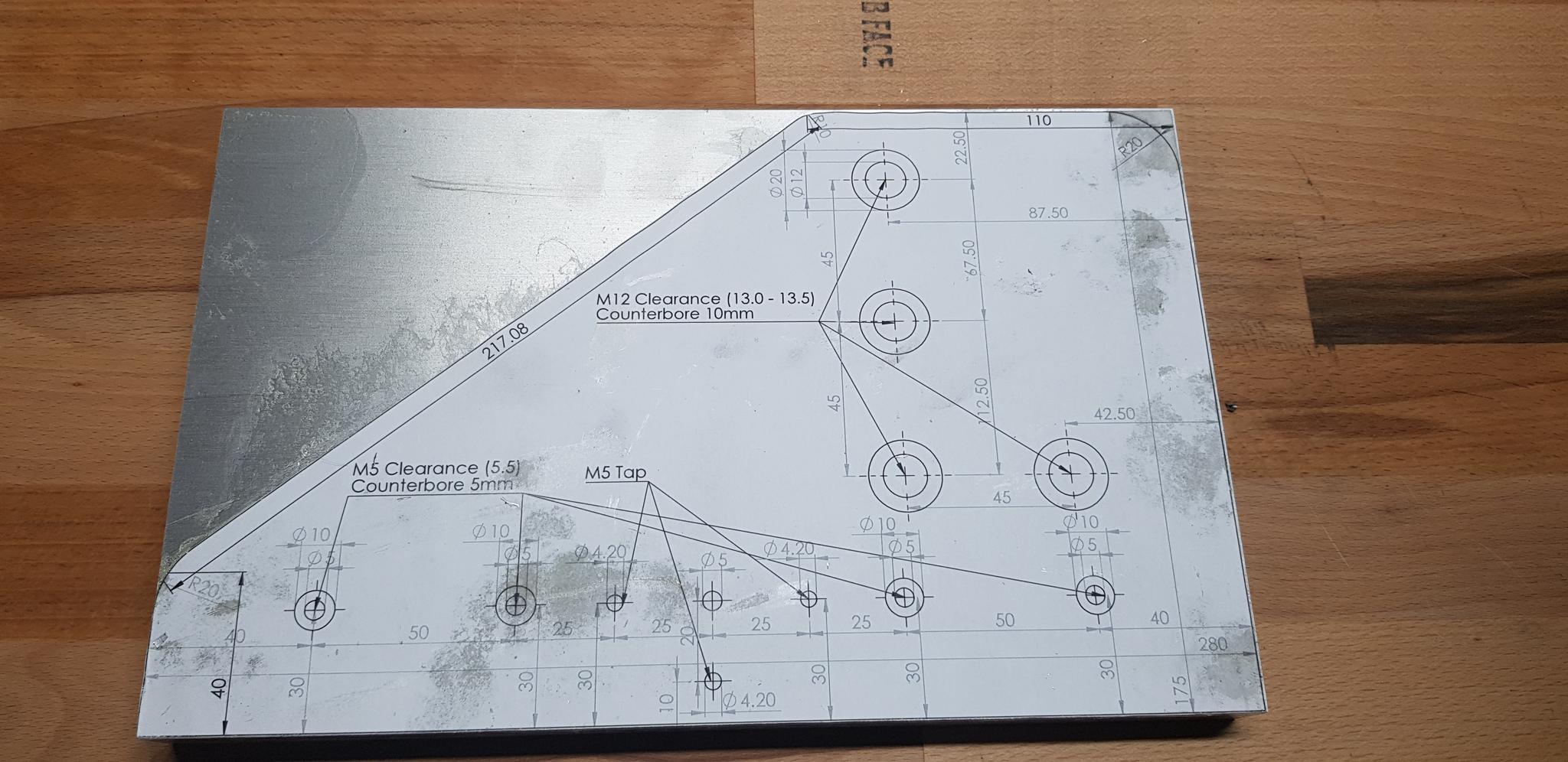

    Now, I'm not too concerned. Ultimately this just means I've screwed up somewhere along the way getting the squaring on the gantry. Looking at the gantry carefully, I can see the gap between the side plates and the X carriages is slightly larger at the front than the back on one side, and the opposite on the other, which tallies with the rhombus I'm seeing. So I think the main problem is that the carriages are bolted onto the gantry slightly askew. My hope is that addressing this will solve my issue, and mean that without any screws attached my bearings will hit the same point on my rails and remove that earlier error I spotted.
    Ultimately, worse case I'll need to remake the bearing plates which those carriages bolt onto (which I already planned to do anyway, I broke a drill bit in one of them so one carriage only has two bolts in - I was kinda hoping I could remake them with the machine itself...!).
    I might however do a few cuts with this error in place, just because I'm at the stage where I can start to use the machine for it's purpose, and if I don't get some output soon I think I may get lynched by SWMBO....
