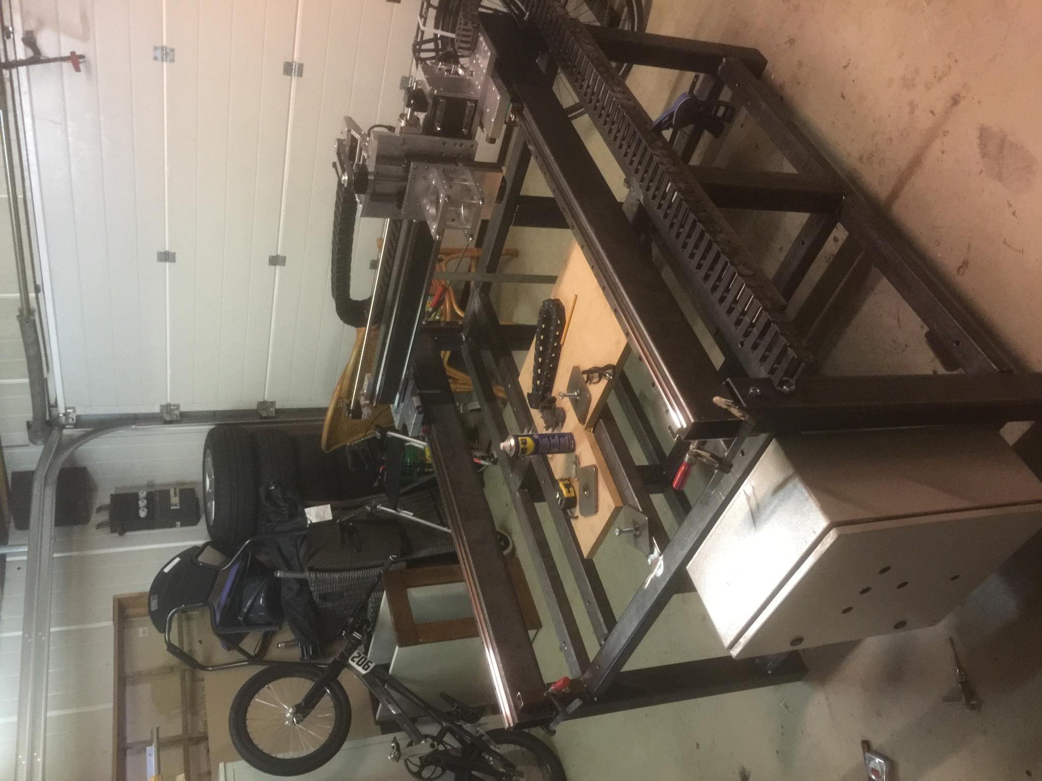

  1. looks like mine,like itClick image for larger version.
