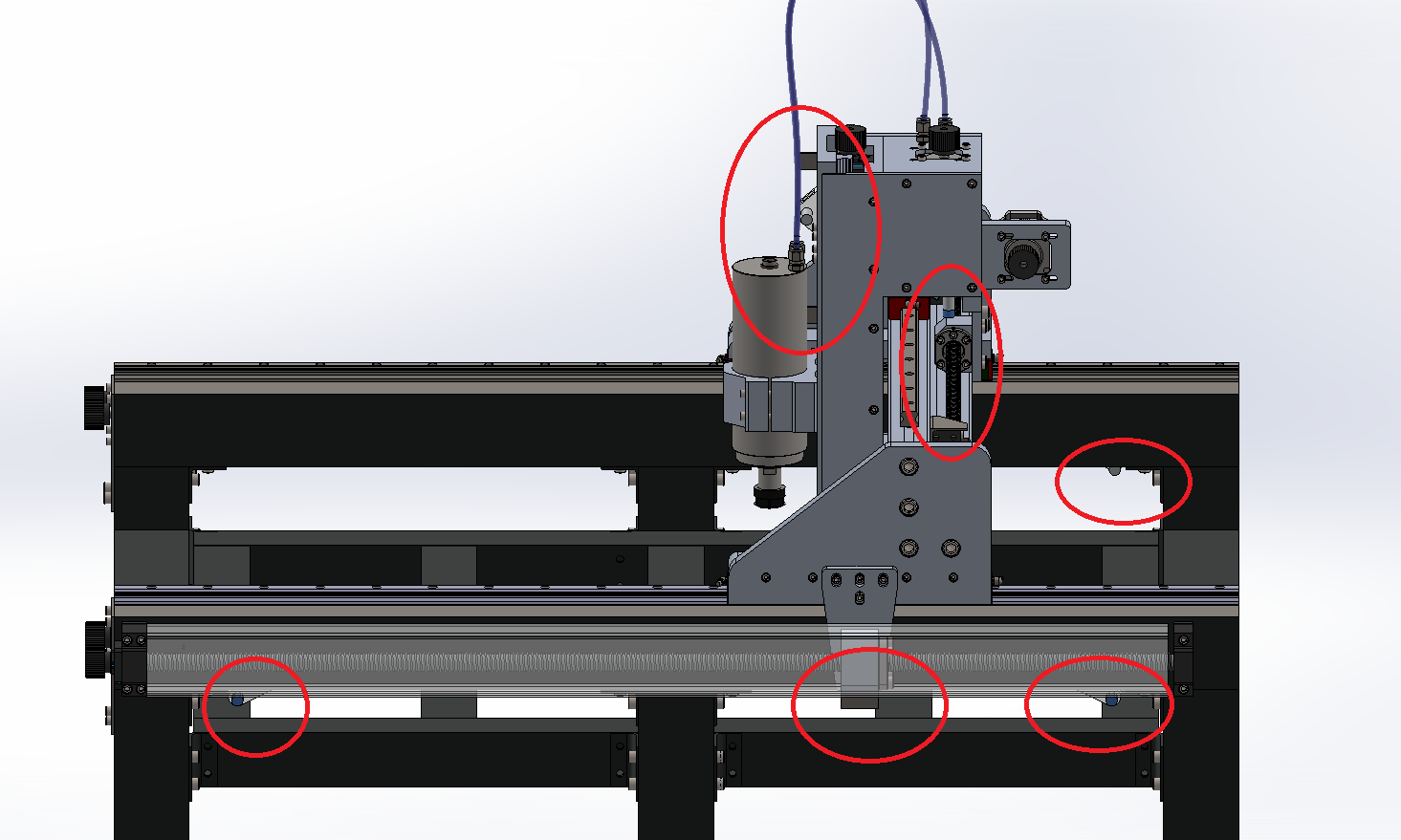

    Why 2 switches on each axis if they are traveling.? The point of having traveling switches is to lower the number of switches.
    All you do to use 1 switch is set the same input number for each Limit IE: X Lim (++) = Input 1 and X Lim (- -) = 1. X Home = 1. Then when Switch sees the target at each end it trips Both Limits, It doesn't matter which Limit shows on screen all that matters is that it trips when triggered.
    When it's homing it ignores limits and looks for the Switch trigger.
    Regards Sloped Target then it's not needed for proximity switches. Just needs to see the metal target, However, it is better if switch passes over the target rather than butting up to it.
    Also, you don't need 3 switches on Each X-axis. Only need 3 Switches for Both sides. X2 only needs a Home SW it doesn't need Limits the other side deals with Limits.

    Thanks Jazz, didn't realise you could use the same switch for both limit and home! I can see two advantages to using two switches; it means the limits can form part of the safety circuit, and I'm not sure I like the idea of needing software to guarantee a stop.., and on the off-chance I have a faulty home switch or messed up homing sequence, I'm still protected (which is hopefully the only situation that I'm headed towards the limits blindly).
    Clearly needs more of a think :)
    Cool that saves some shaping.
    Good catch - clearly not with it yesterday :) That is what I've drawn in the circuit diagram, just wasn't thinking straight when playing with CAD...

    Thanks Jazz, didn't realize you could use the same switch for both limit and home! I can see two advantages to using two switches; it means the limits can form part of the safety circuit, and I'm not sure I like the idea of needing software to guarantee a stop..,
    It depends on how you look at it.? Limits are not really a Safety or E-stop situation, they are a positional error not really an emergency situation.
    For instance, the most common limit trip isn't because machines run off on its own accord but rather because you jogged into them or set Work zero too close to limits. In which case the Software will warn you and won't allow when soft limits are turned on. However, having to reset the drives every time you jog into a limit soon becomes a pain and on small machines, this happens a lot when first learning.
    Also your not actually relying on software with the UB1 or better controllers because the controller's hardware actually stops the motion and then informs software it's happened.

    Spent the day thinking about Jazz's suggestions - decided to listen to wisdom :)
    The clincher is that it really simplifies the circuits, and I don't have to now work out how to connect the proximity switches I have (NPN NC) in series - I can now just run each back to the controller and have enough input pins to deal with it.
    Leaves me needing 5 proximity switches in total - a Positive X limit, two Negative Xs (one each side, doubling as the X homes), a Y and a Z (each doing triple duty). You can see most of them and their trigger plates highlighted in the diagram below.
    KIS approach works best every time. I've built dozens machines that use this setup without any safety issues. The only time I use separate limits is when using Servo motors because they do just take off when Encoders fail.

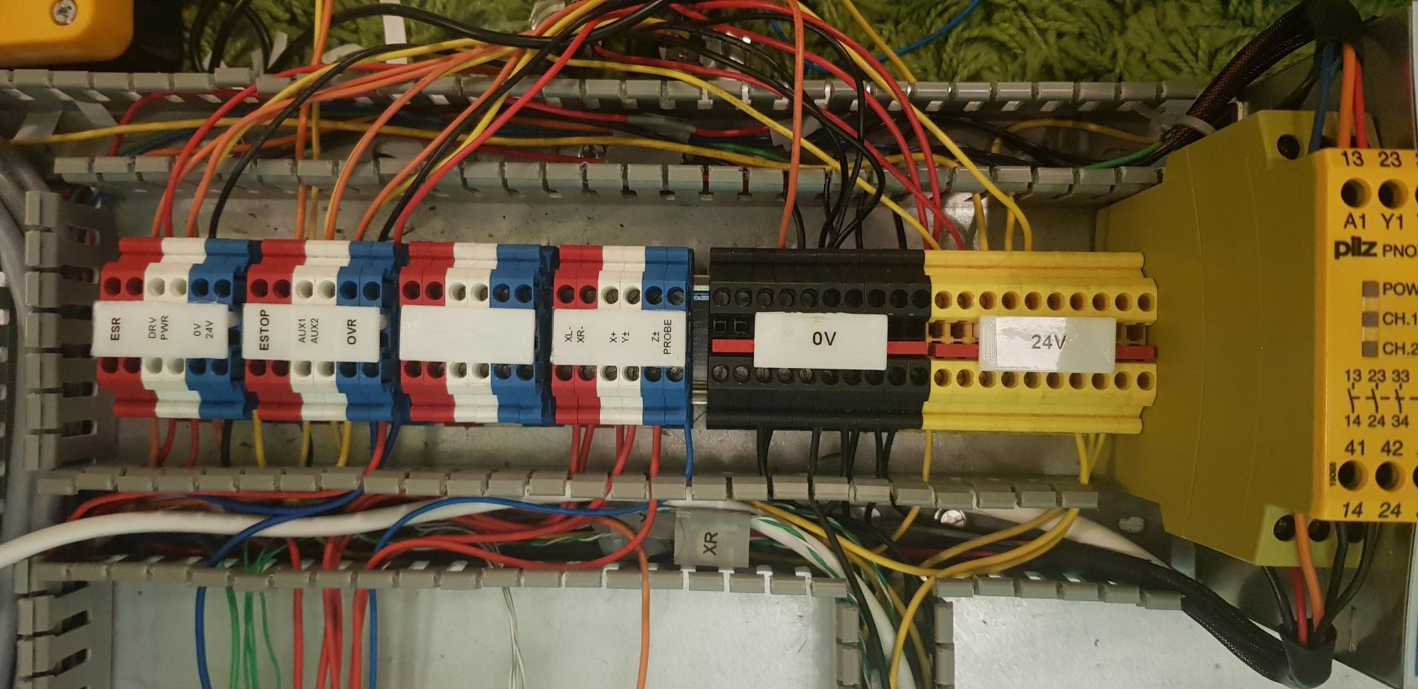

    So, I've had a very frustrating evening trying to get my EM806s to talk to my computer running the Protuner application.
    After about three hours of getting 'unable to connect to drive' messages, trying every version of the software known to man, every pin combination I could think of, and every port setting I could muster, on windows 10, Mac OS, and windows 7, I was having absolutely no luck getting my USB to RS232 FTDI adaptor to work. I finally remembered that the old PC i'm using for the CNC has a physical com port on it, and within two minutes everything is working perfectly.... I suppose it counts as a success if it works eventually right?
    Anyhow, all my drives are now programmed with the opposite settings for fault output and enable, which means that the fault output is NC, and the drive is only enabled with a high output signal from the UB1's safety circuit. Therefore, if the Spindle or a single drive faults, the drives remain powered but disabled.
    The anally retentive label fairy has also visited; I realised whilst wiring up the lines to the control panel I had the potential for 24 terminal blocks each doing different things with no labels, and although I have diagrams and terminal block numbers.... didn't feel like in a years time I'd remember what the hell each one did. Out came the 3D printer, and I printed some stages which fit over the terminal blocks and allow me to place labels on them. I also printed some blanking plugs for my spare GX20 and GX16 holes on the gland plate.

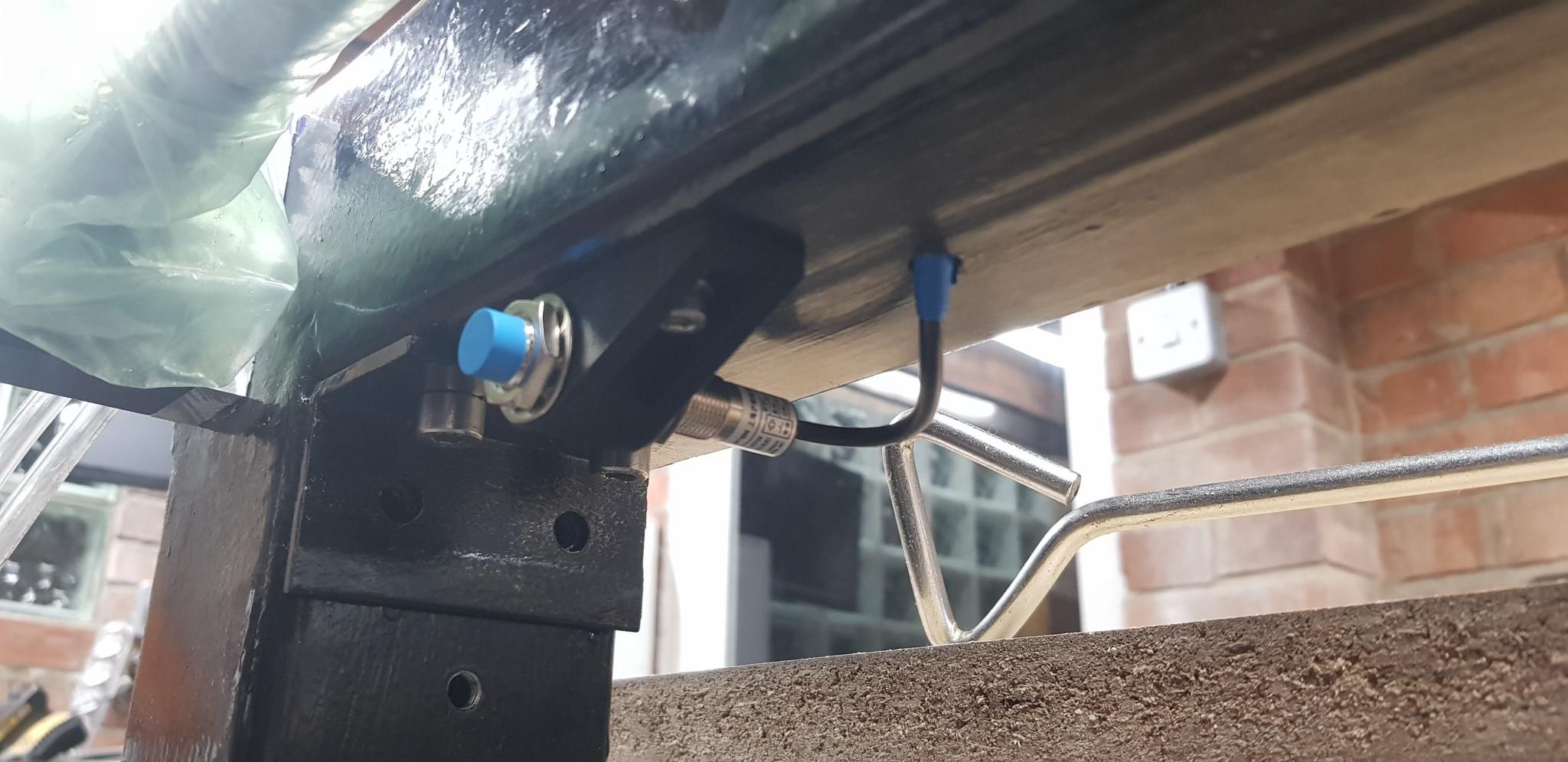

    Next up - the home/limit switches. I've 3D printed holders for them, and mounted two of the three X switches. I plan to silicon that hole to prevent the cable rubbing with vibration once I'm happy with their locations.

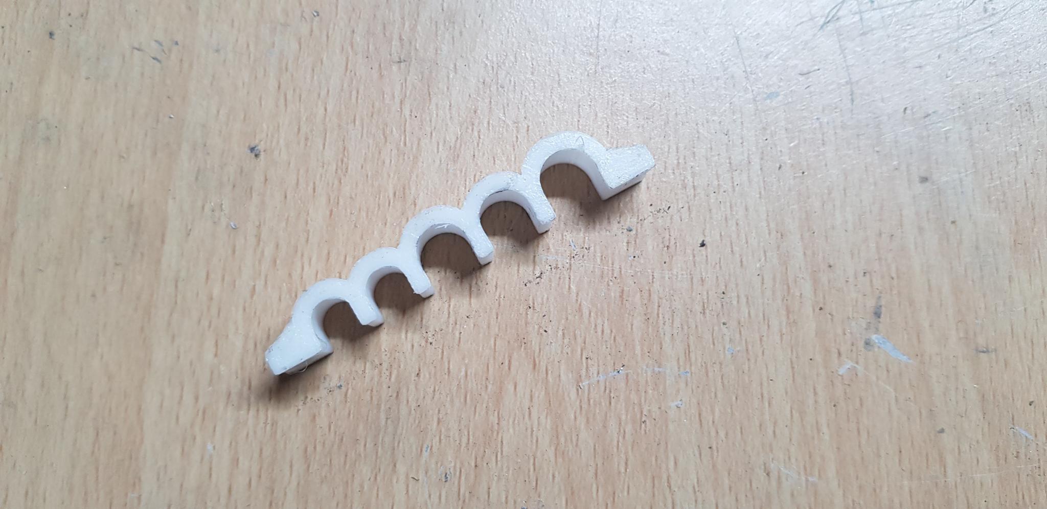

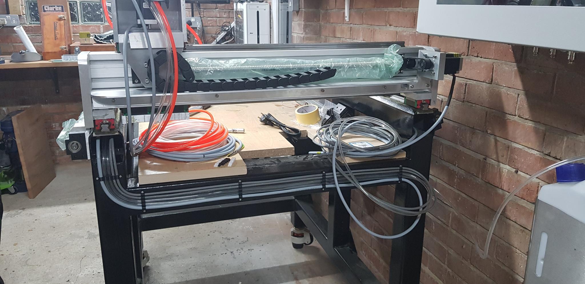

    And last but not least, I've been working on keeping the wiring on the machine tidy. I 3D printed a set of clips to route the wires from the X Right side across to the wall side of the machine, and plan to use this technique all around. This is one of the clip prototypes:

    And here they are in action:
    In order from bottom to top, this is the Motor wire, then the water cooling for the motor, then two limit switches. Quite fond of these :)
    In other news, I've managed to find some cable chain for Z and Y from another skip, and will order the X axis cable chain tomorrow. You might also spot that I've added in the holder for the Y axis cable chain.
